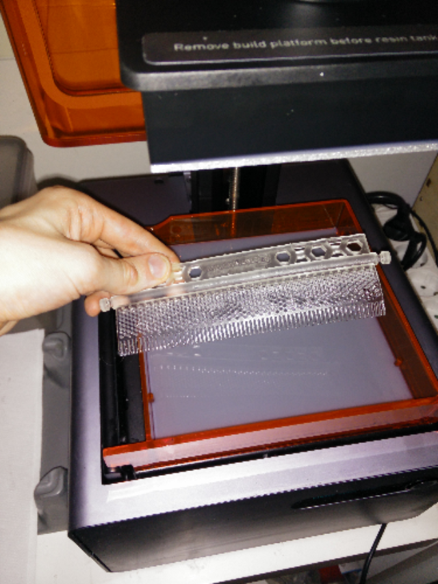

This must be the most unexpected, yet a such a obvious thing we could have done to start maintaining our Form 1 + resin tanks. If the print fails (which barely ever happens), it is always a struggle to remove all those parts from the tank.

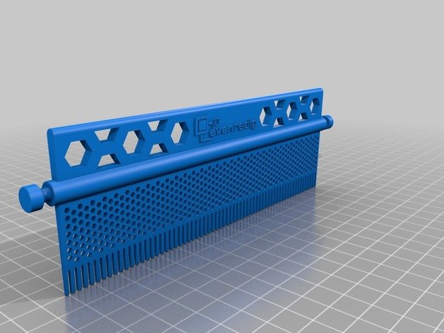

@Alan_Nguyen pointed out an obvious solution - why not printing one of those Tank Combs for it. And apparently there was one already designed and placed on the Thingiverse.
We have just printed it with the Form one to clean the Form one and it works perfectly!
Just make sure to clean it afterwards for the holes not to get filled in. Since it’s made out of resin I guess cleaning it with alcohol is not the best idea - so I clean them with water. Any other ideas?
Make sure to share any of your tips in the comments bellow! :wink:

Cleaning it with alcohol should not be a problem. The resin is cured. The only real risk is not getting the uncured resin completely off it and catching little drops of alcohol in with the resin and then introducing the alcohol to the resin tank.
Another options would be to wipe the comb off as best you can and then set it out for the remaining wet resin to solidify in UV light. When it gets too clogged, toss it and use a new one.

I think I’ll give your second option a go. Is there anything else your using to clean the resin tank?

Let the comb dry after (a short) IPA bath.
Yes, uncured+IPA in the resin tank will be a bad mix.
