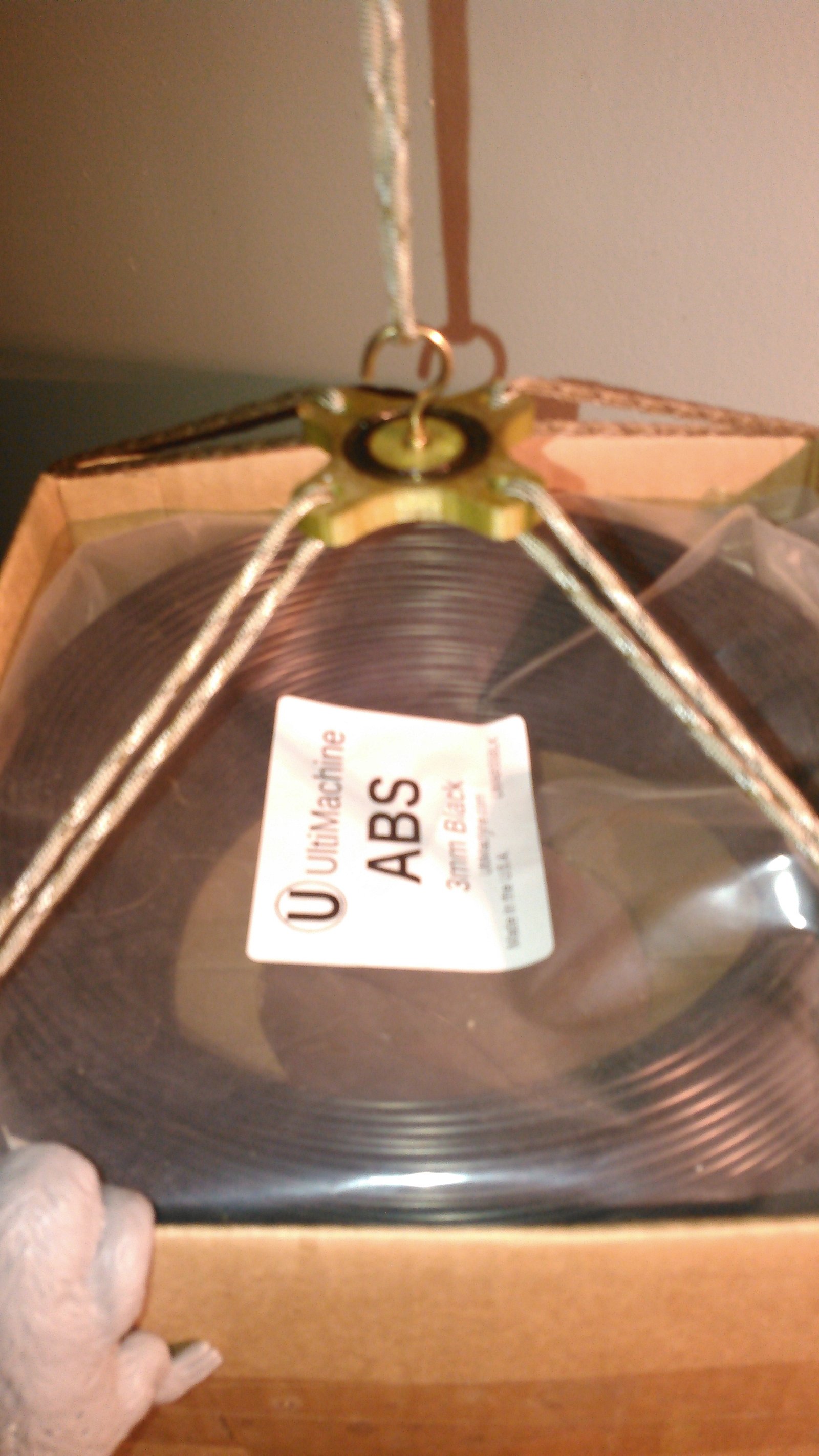

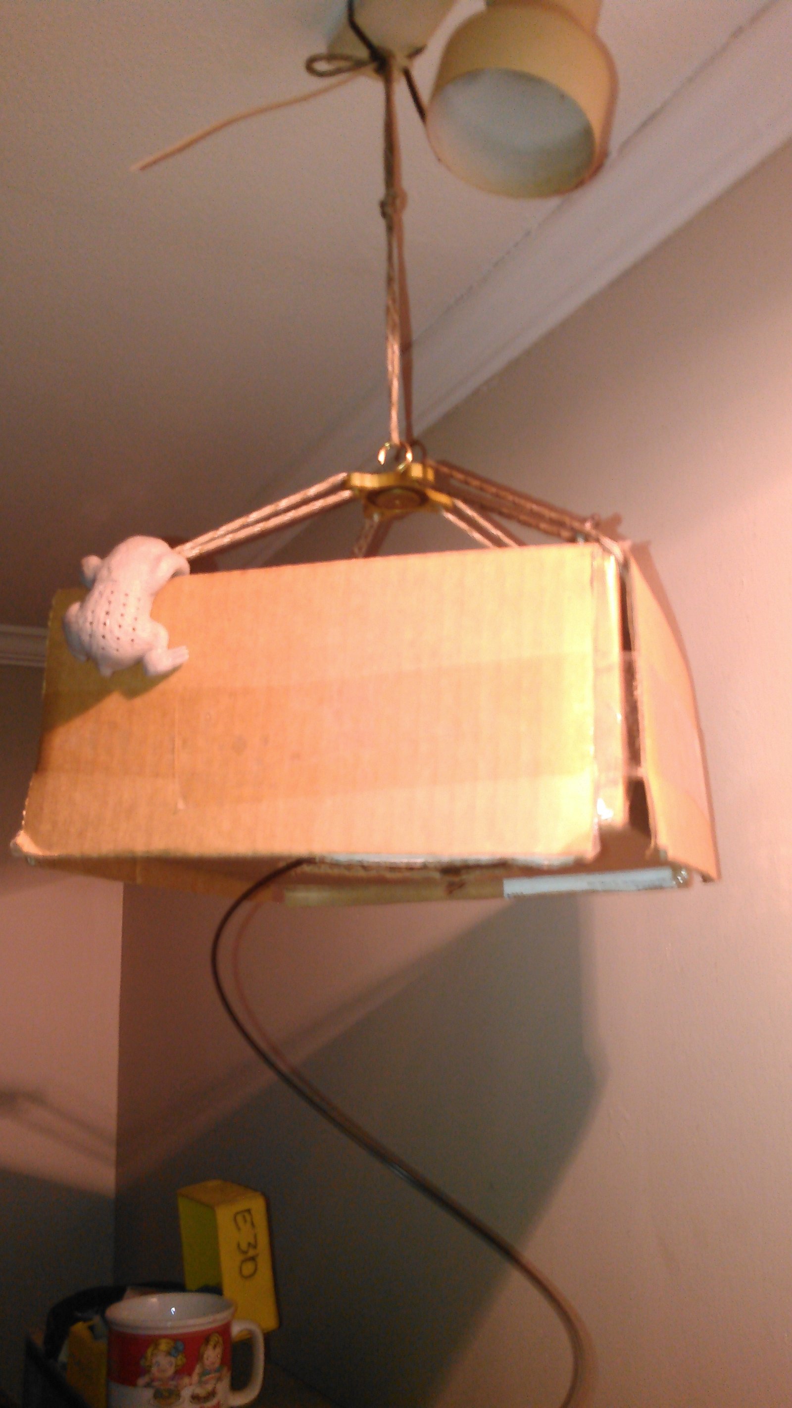

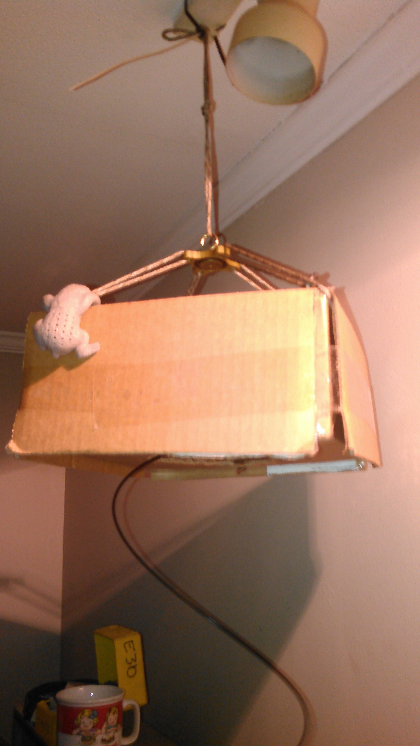

This is the best spooling method I’ve ever tried. Although I haven’t tried it with for than 5 kilogram coils, I am confident my extruder could handle that on this system.
