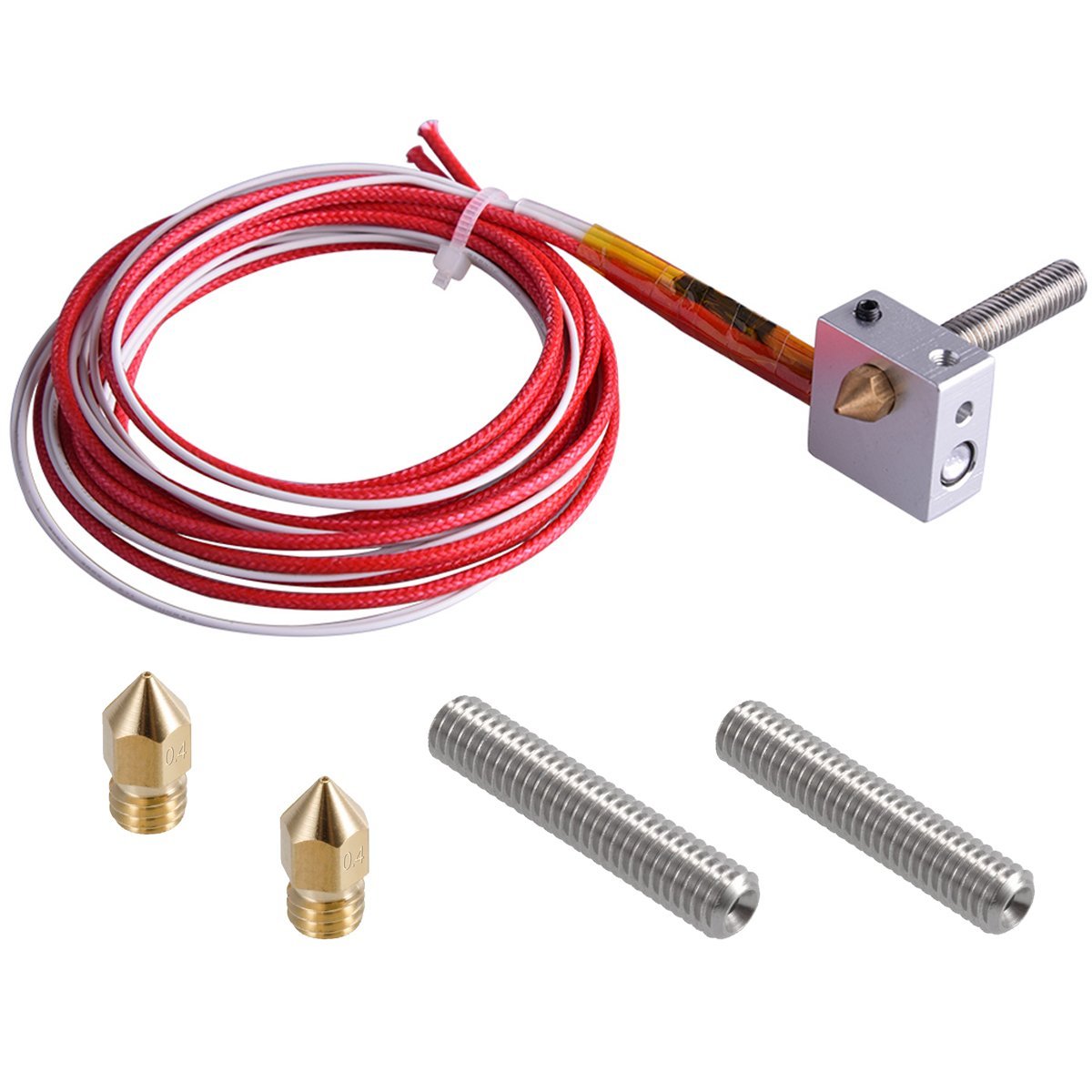

For reference this is my hotend: Amazon.co.uk.
I brought the cheapest one available on amazon, so it has no fan and no way to connect a bowden tube. I have created a basic adapter between the thread and a bowden tube holder, out of wood. It’s not good but it does the job.
