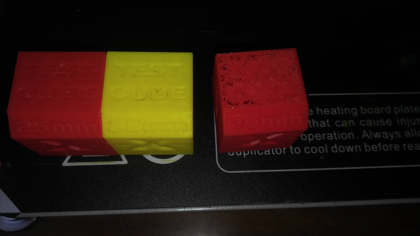

I recently upgraded to a all metal hotend by microswiss. I have been having issues since then.
I just did a test print of a 25mm calibration cube.
The 2 on the left are my controls. The one on the right is the newest one. I cannot figure out why they are so vastly different.
I am not sure the cause as i have not really tweaked anything.

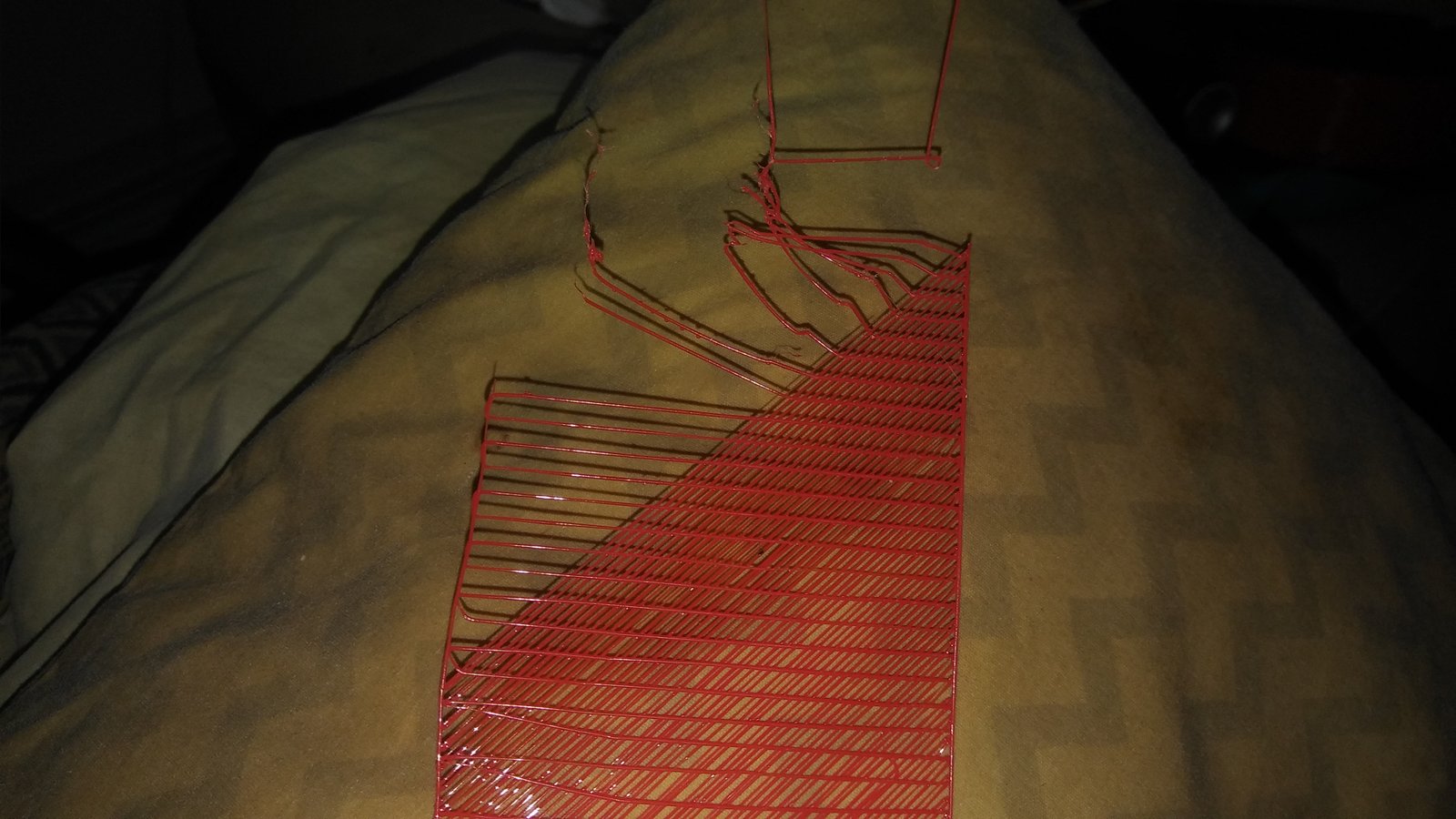

Thanks for the help. It has started extruding. It was printing then it warped and started seperating sort of.
It pulled off the painters tape might try a raft and see if its any better.
Try turning your cooling off for the first 5 layers or so. I have never seen PLA warp like that and I am wondering if the material is pure PLA. PLA should not warp much at all. You can try going a little cooler with that material. Try 225 or 220 degrees C. Keep with the masking tape and stay away from using a raft if you can avoid it.
Nope still extruding. However it leaks a bit at the start. It then extrudes normally but some edges curl up after printing which then causes bunches which then hits the nozzle and it warps further and pops off the bed after warping further.
I really have to question the quality of the material that you are using. Do you have another PLA that you can try?? What you are seeing is really uncharacteristic of PLA and looks more like ABS. You could have got a mislabeled spool of material. I have never seen PLA warp like what you are showing.

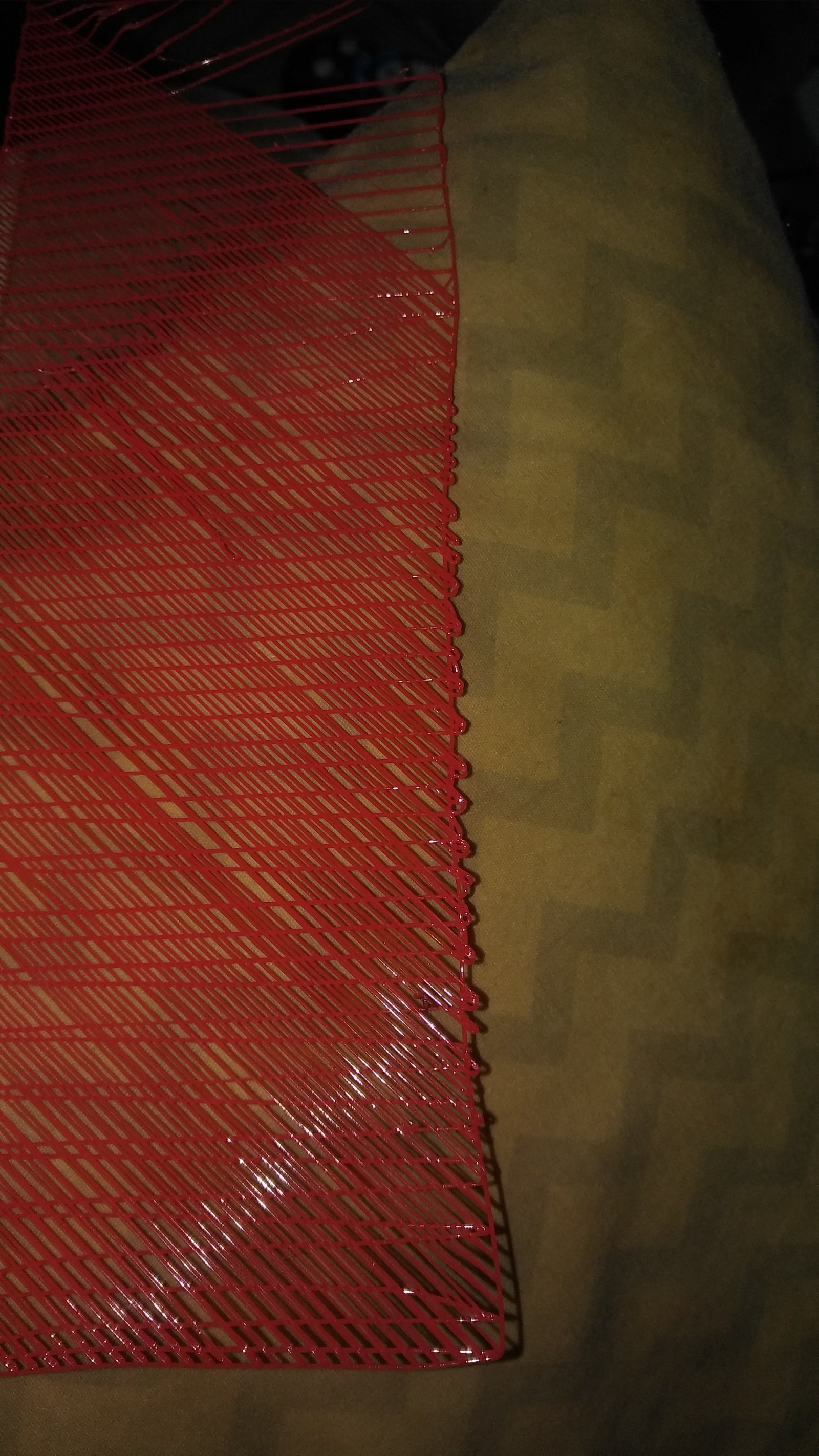

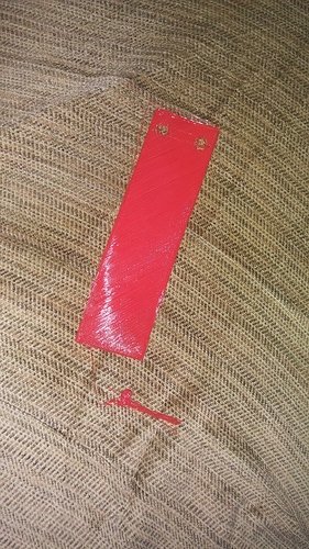

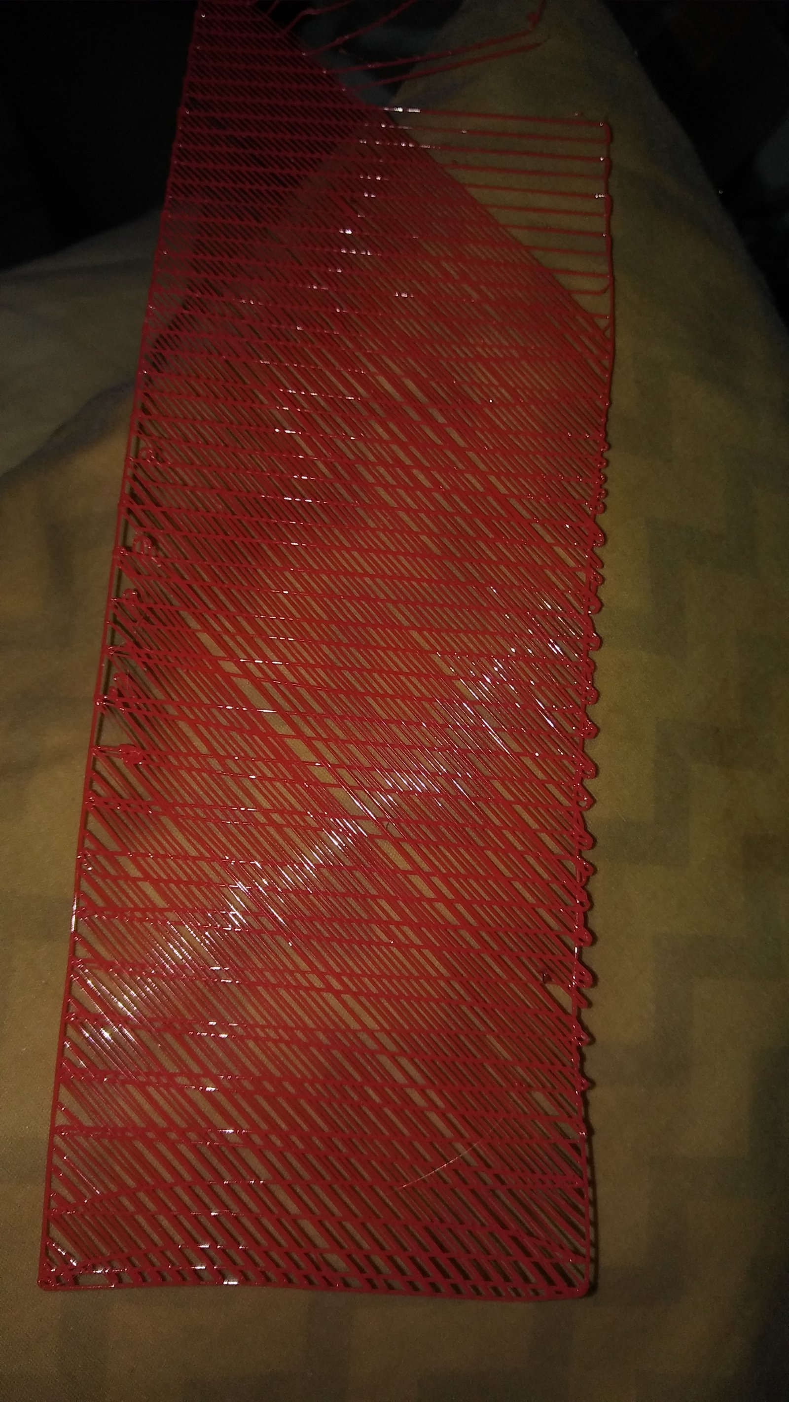

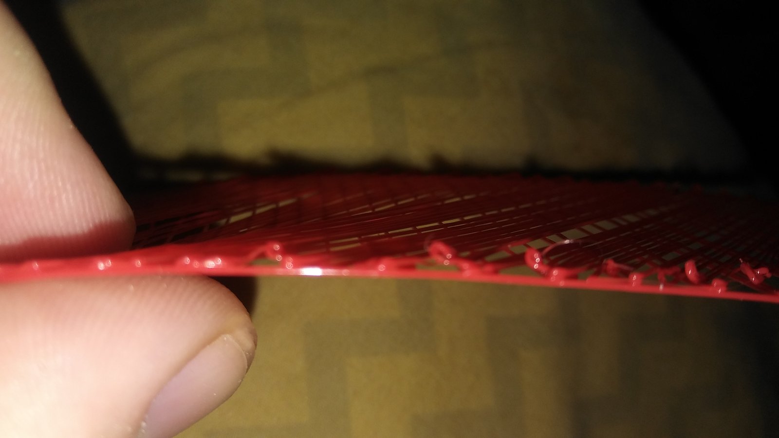

Heres some photos i took of a test print using just a raft for illustration.
