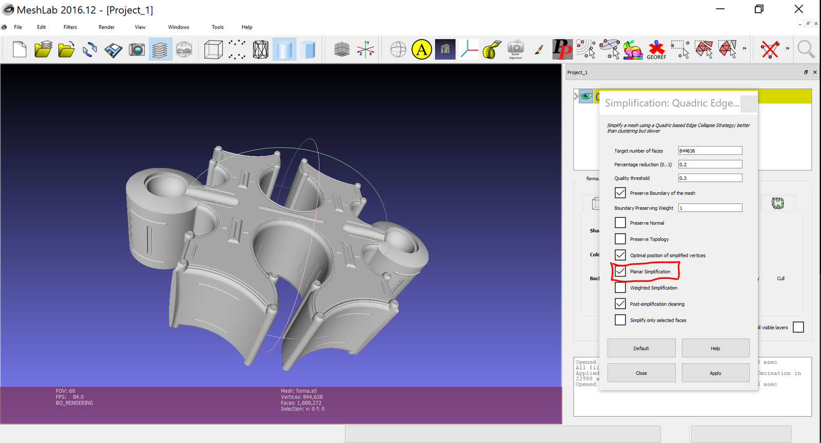

I was recently asked to split a model for a client and the part had such a high face count that solidworks couldn’t work with it (it could be a mesh but would not turn into a surface or solid) and meshlab would crash when I would try and reduce the face count. According to meshlab the part had 1.7 million faces. Would it be possible to have a face reduction feature in as a tool for clients or even the hubs themselves?
The reason I was trying to open it in solidworks is because the client wanted the to have “lugs” put in and printed in two parts as outlined here and here
EDIT:
So I found out the issue that I was having with MeshLabs. When I was simplifying I was not using the planar simplification option. When that is selected it significantly increases stability and it takes about 2 seconds to complete even on a laptop. I have uploaded a picture outlining the Important parameter.

Meshlab can do what you’re asking. Meshmixer is terribly slow for large STLs.
I tried using Meshlab to reduce the face size using the Quadratic edge collapse detection filter. I let it run for over 12 hours on a stable run (it crashed about 7 times 10 min in). I did not run out of system resources as I was doing this on a i7 machine with 16GB of ram with a powerful graphics card so resources are not the limiting factor.
Yeah, none of these tools are particularly stable. Do you want to upload somewhere and I can try have a go?
