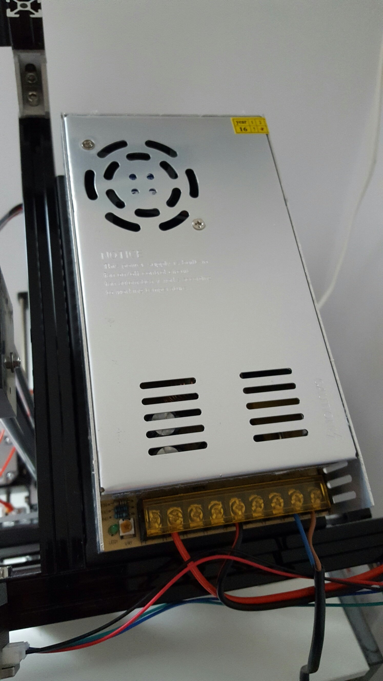

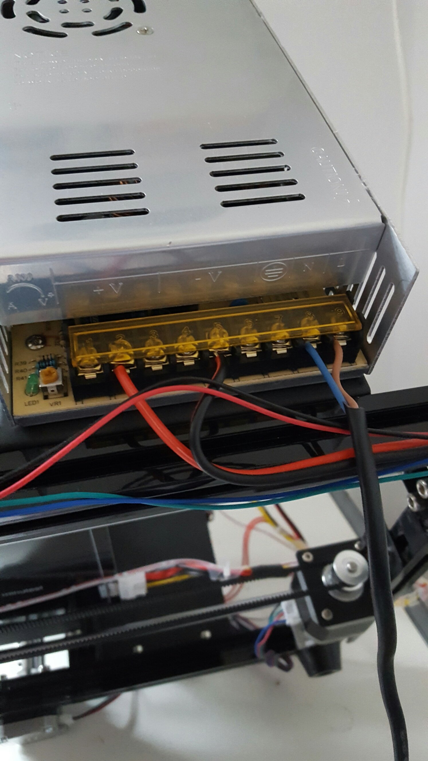

The link you sent is the exact one I have. I have attached an image of the current set up of it. I am going to go to a hardware store this afternoon (as advised below) and buy one of the heat resistant mains cables.
If there is anything else you can think of that I may need it would be much appreciated.
Could you possibly send me an image of your setup so I can see what I’m aiming for?
Thanks again
Thanks for your response
I am going to take a look this afternoon at my local hardware store to see what I can find.
Please see the images attached above to see my current setup
