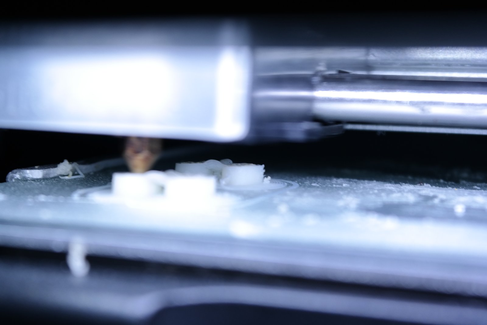

Well i manage to have quite some print with my press not so easy to use but i would say that it was a worth it printer regarding the volume, price, and the enclosure. I have still some problems but it’s probably my responsability ( bed leveling not the same everywhere ). But i can’t manage to print little pieces with overhang like marvin cause it tend to curl up see the picture )! Any idea?
If you are printing small volume parts, you need a cooling fan blowing onto the part as it is printing. One trick to overcome this is to print several smaller parts at the same time, to give the material time to cool before applying the next hot layer.
Thanks, well, i can’t do the first option so i’ll try plan B, as you can see on the photo i tried with two but don’t make it. Already better when 4 but still not perfect
turn the temp down and make like thin rods or something at each corner with marvin in the middle and turn travel speed for non print moves down this will greatly increase the cool time
I agree, now that I look closely at your prints, it does look like you are printing hot. For large parts this is good, but small parts benefit from going as low as you can without extrusion failing. Also, from the looks of it you may be overextruding a bit. Try reducing the extrusion multiplier in your slicer and/or run the extruder steps/mm calibration. Also, try reducing the extrusion width to just under the nozzle diameter (ie. 0.38 for 0.4mm nozzle). Finally, from the looks of the curling, it seems to be predominantly on your bridges, so reducing the bridge extrusion may also help.
Unfortunately, as you can see, there are a lot of different parameters that can affect a print, so as you become more familiar with the system, and begin playing with the settings, you will be able to compensate for problems that can occur.
Nice one, Geoffrey, thanks for sharing with the rest of the community!
Indeed many parameters, but thank you a lot for theses advices it really help a lot! Your thing with the thin rod could do the trick!
