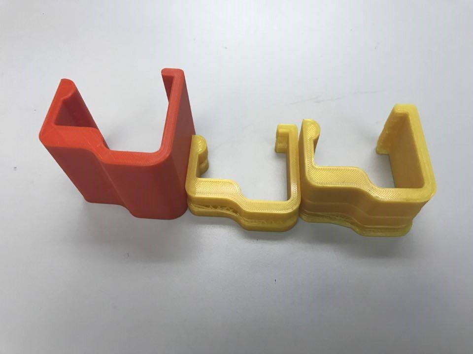

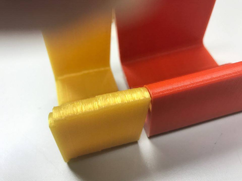

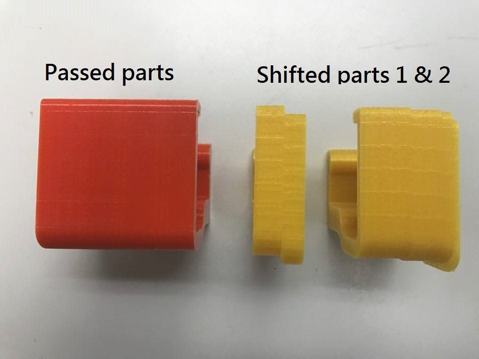

My BCN3D Sigma had a problem that the y axis will be shifted randomly during printing and some “kakakakaka” sound occurred when the shifting occurred.
I had push and pull the y axis many times and a higher resistant will be occurred sometime. But I had tried to remove the y axis bolt and it’s move smoothly.
How can I solve that problem? Anybody had that problem before?
