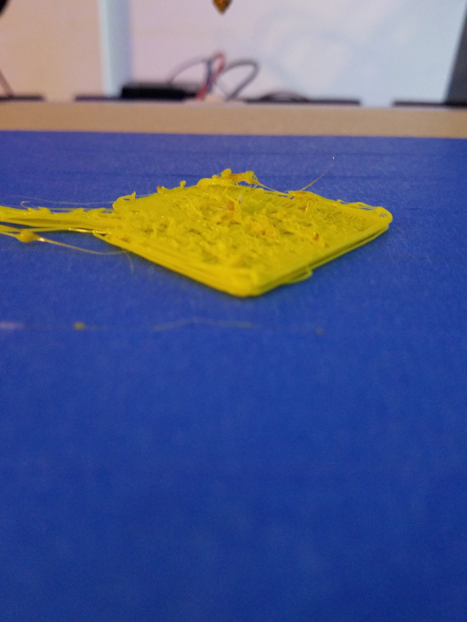

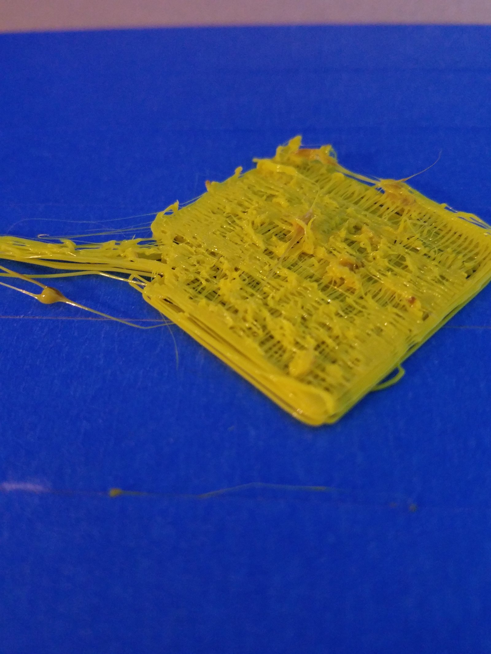

Having problems printing with petg. I keep getting these clumps in the print and it keeps sticking to the extruder.

The extruder is at 235C and the bed at 70C. The brand is hatchbox. I am printing at 20mm/sec. It is a anet a8 printer. The middle size is .4mm
Temps are ok to start with. What slicer?
I might work on the first layer and get good adhesion first then see about printing the whole model. Go with a .2 layer height and a .2 first layer. PETG doesn’t like to be squished. You could run the first layer temp up a bit to help with adhesion.
