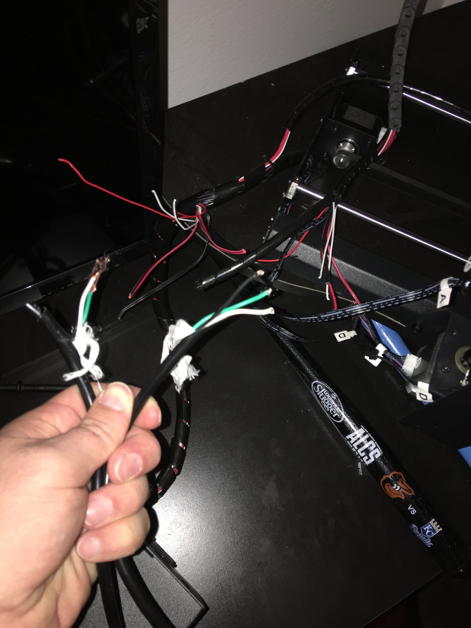

I need help! Don’t ask how, but my dog chewed through all the wiring going to the extruder. The problem is of all the wires there’s 2 plain red wires and two plain white wires. As a result I don’t know which reds to splice together. Same with the two whites. Does anyone have any suggestions? Ways to ring them out and figure it out that way?
EDIT: The wires in question are going to the hot end.

Usually:
Red is heater cartridge doesn’t matter witch is witch (+ -)
White is thermistor (heat sensor in head) also doesn’t matter polarity.
So connect red with red white with white
But if possible make a picture of the chewed cables (and also the Dog :D)

Its quite a big damage, as i can see in the in picture. There are some red/black cables also cutted, 1 should be the fan for the printhead and the other for the cooling for fan for the prints. Open the electronic box of the printer and ring them with a multimeter to identify witch is witch.
In the picture you are holding is the main power wire(white,green and black), nice cut(chew)?
If you have a dog or child I really suggest to install a Residual current circuit breaker into your electric box(where are the rest of the brakers are), it senses if there is any shorts in the electric network and cuts power really fast so it prevents electric shock.
