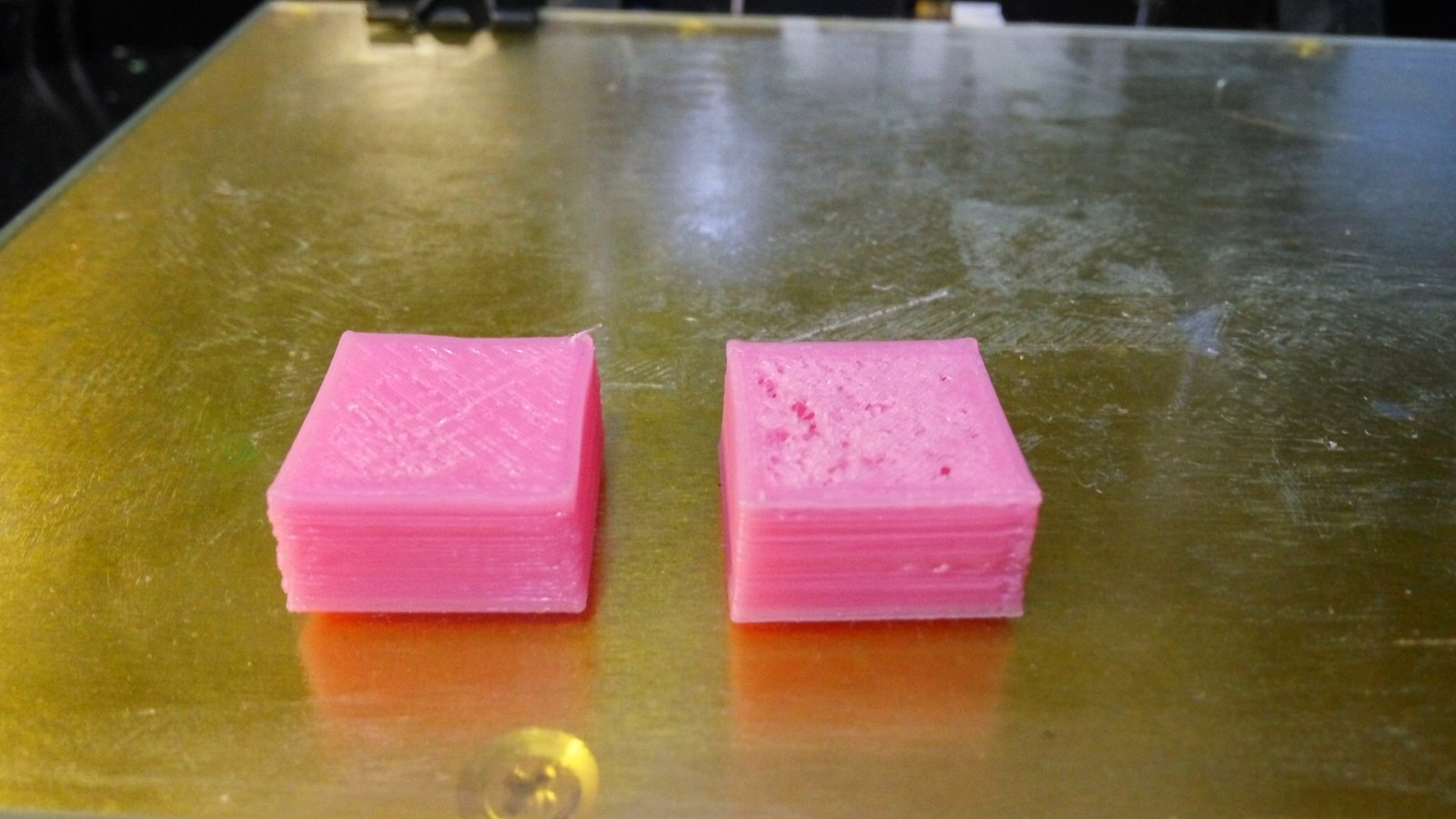

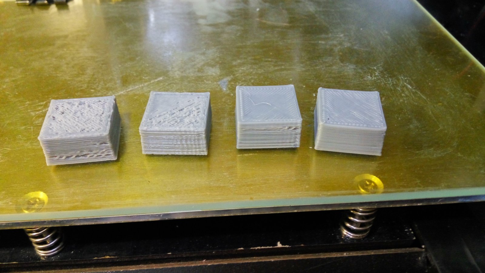

Have had a few prints recently with PLA that look like underextrusion and the only way to get a decent print is to wack up the extruder temperature to 240c!! ABS prints absolutely fine, no issues at 240c. Photo of pink PLA blocks - left is 240c, right is 230c. Grey PLA blocks range from 215c to 240c left to right. Could it be the filament? The grey and pink are both PLA as sniff tested and their full adherence to glass and glue would also confirm this. Have used both these spools of PLA before with success at 220c but now both refuse to work at this temperature. I recently had a blocked nozzle and wondered if I had damaged something however I have had good ABS prints since then. Any ideas what the issue could be? Confused.

Ok so, it was recently cleaned out and prints ABS perfectly fine at regular ABS temperatures. I have printed the block in green ABS very nicely before and after the grey and pink PLA blocks. As for lower temperatures working better I understand the theory however the better quality has been on the higher temperature settings??!! ABS prints fine so I cannot see how it could be a blockage otherwise I would experience the same thing with the ABS??!!

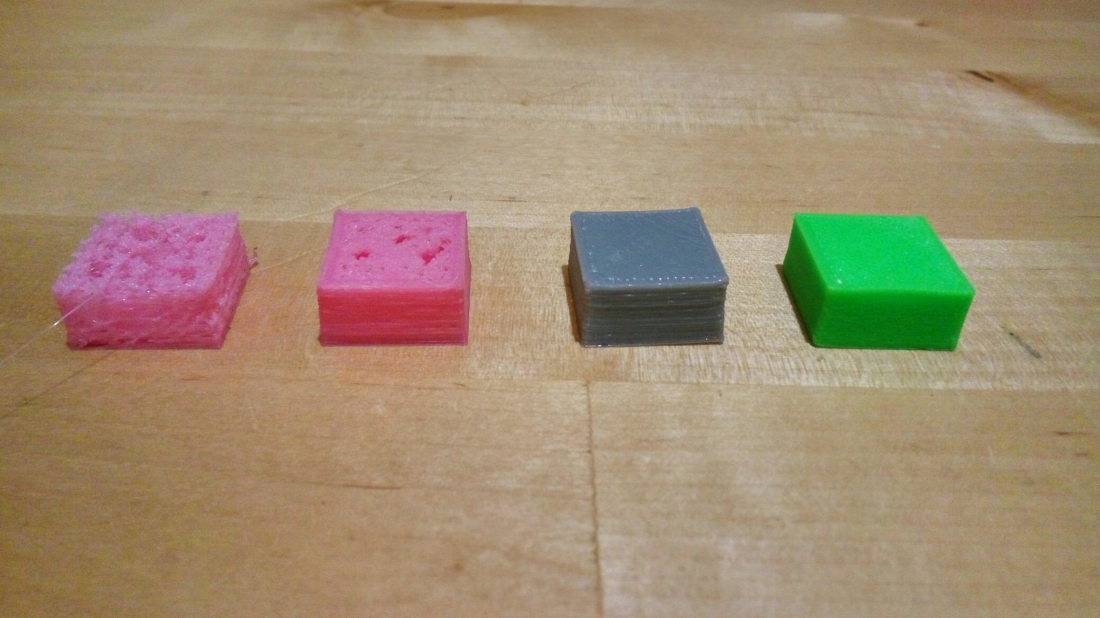

Pink PLA at 190c, 200c. Grey PLA 240c, Green ABS 240c
