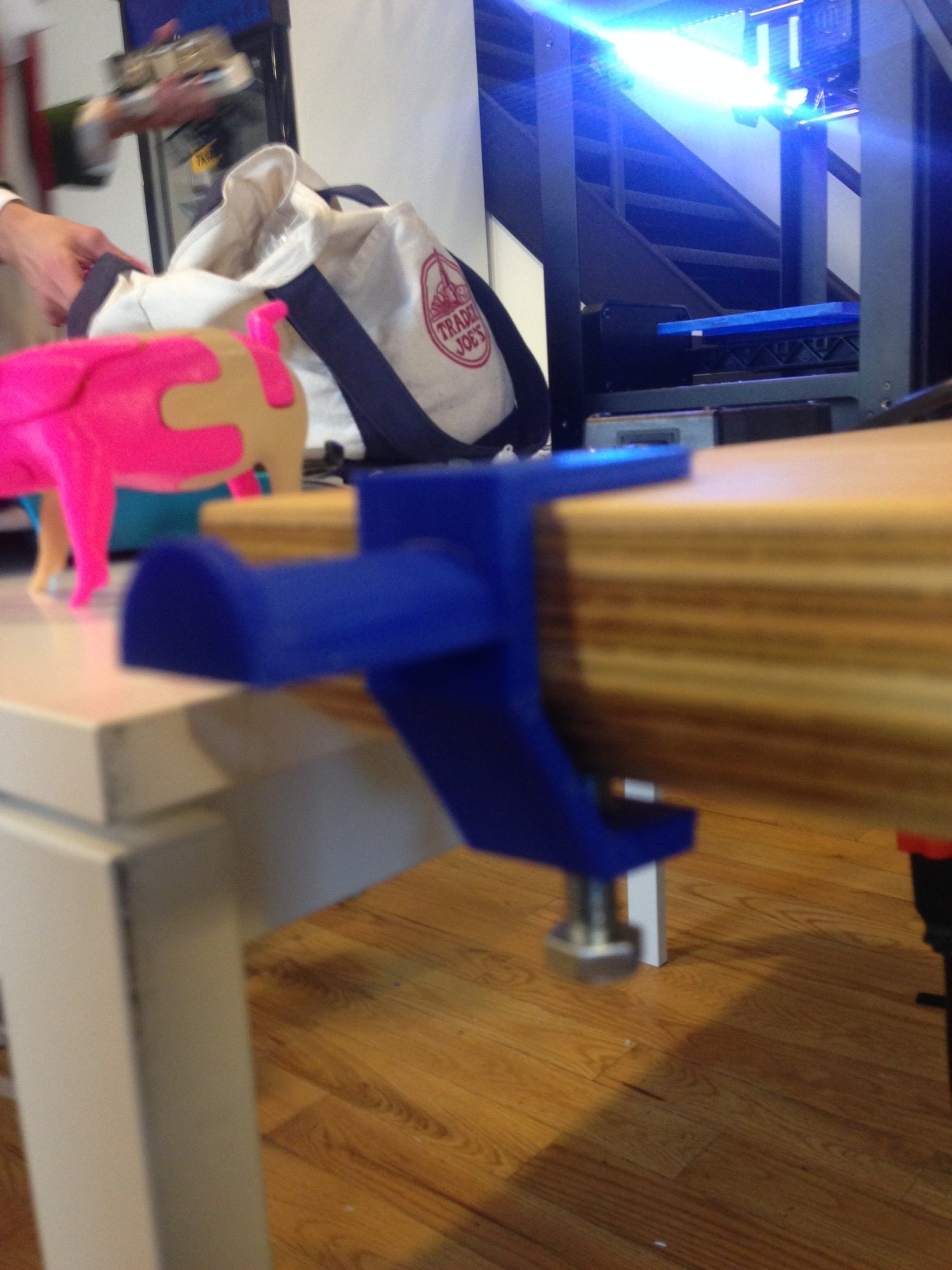

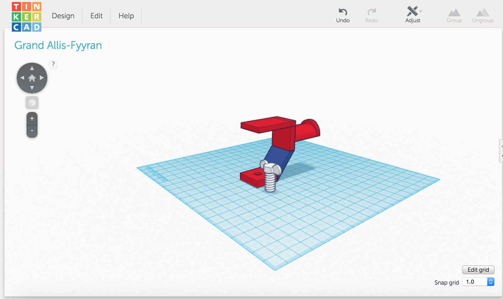

Basically, I thought of designing a grip of sorts with an extension that would fit to our (supercool) desks. They are made from 2 sheets of 1’’ plywood, with one at an about 45 degree angle. So, using Tinkercad I made a fairly simple (but functional!) design.
In order to get a tight fit, I figured a bolt would be necessary. I downloaded Bolt files from thingiverse. I then imported it into tinkercad. To get the threads, I made the bolt a hole and then grouped it with the base. Originally, I attempted to print the screw and use it, butttt printed screws don’t last too long and the screw broke. So, I just went to the hardware store and got a real bolt of the same size.

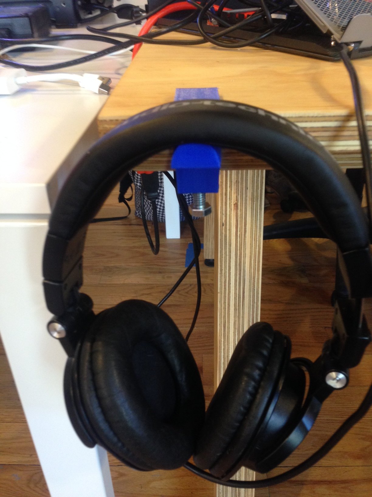

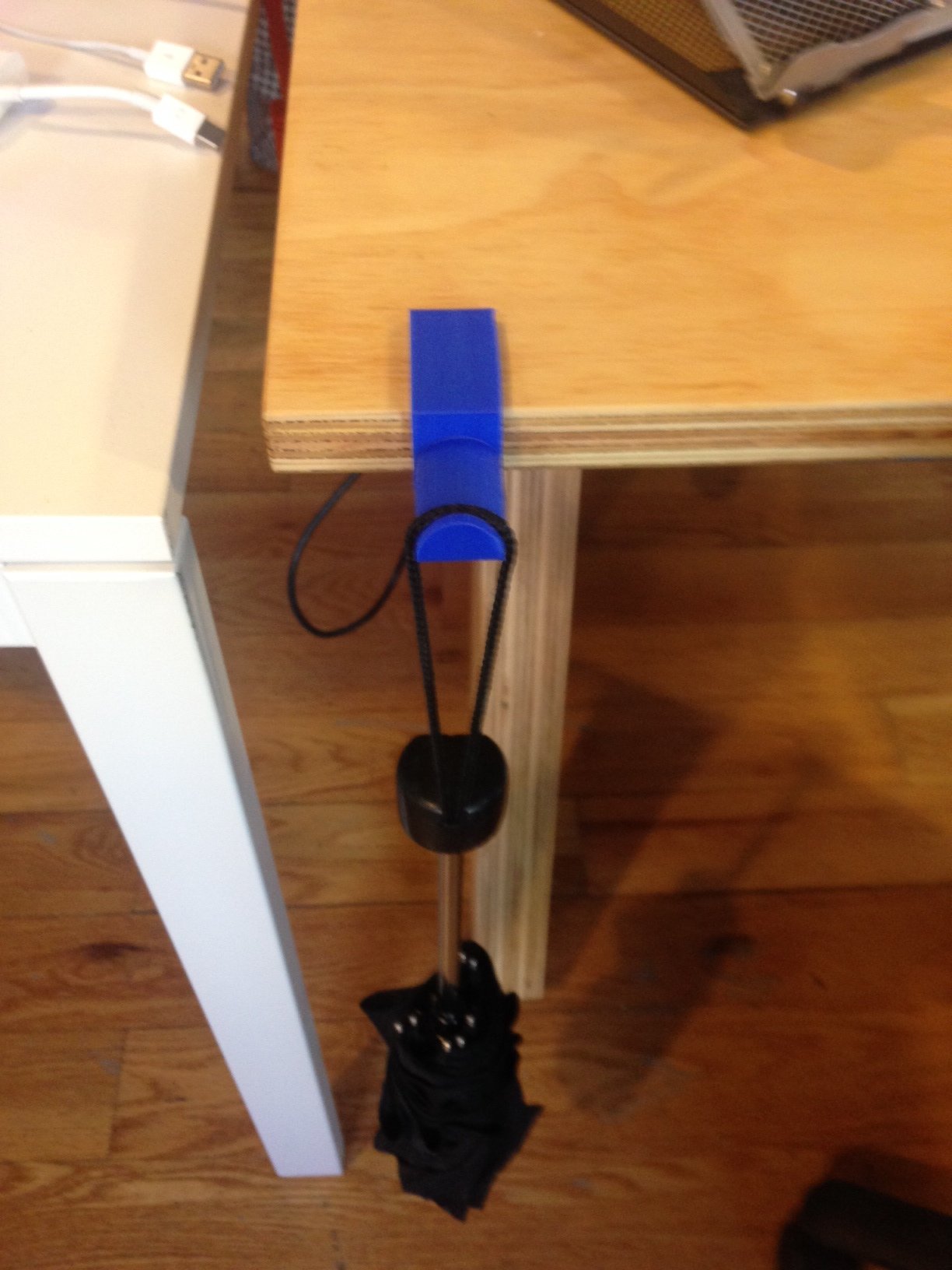

I decided to use PET+ as the material because its a bit stronger than PLA. It actually turned out pretty well. The bolt took a little extra effort to get the threads to fit, but overall it works! It can even hold a backpack. The next step would be putting Sugru on the end to not put so much pressure on the wood. And making the ‘spool holder’ esque extension a little bit longer. The design’s not perfect, but it works!
