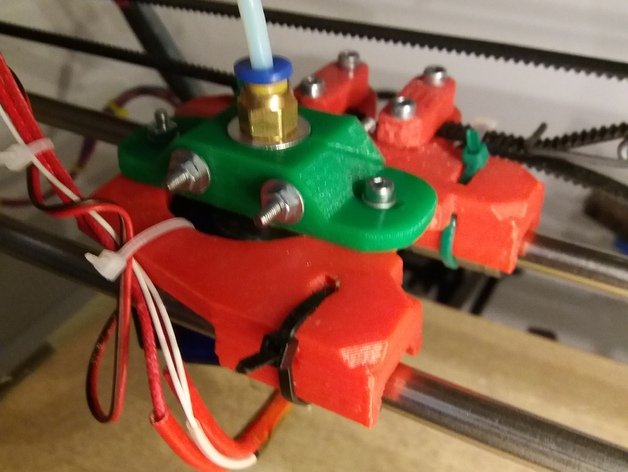

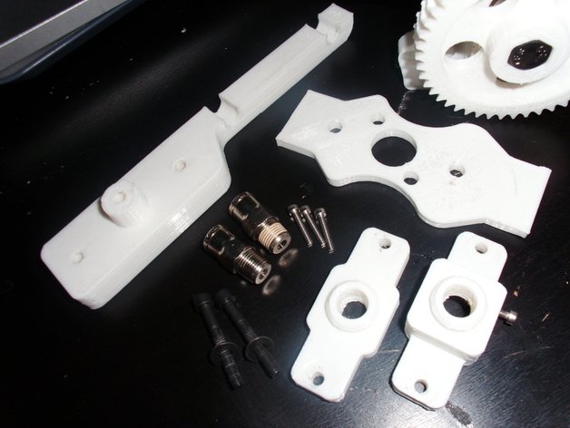

Hey Broncosis. Thanks for the files. I have a question about the x carriage. How would I make it a bowden e3d v6? Would that be possible, and if not do you know of any carriage designs for that specifically? I want it to be bowden, because the direct drive will limit my 3d printing space dramatically. At worst, I would just use the direct drive but I still need it for an e3d (how would I do that?). Thanks again for all your help.
I am sures there is a prusa mount out there on one of the sites I will find it for you in a bit when I get to my computer
That would be great! I’ve been looking as well, but lots of them have the belt tensioner in the middle. Mine would have to be on the back of the carriage.
this would be my first choice
it looks nice a simple and would work with a e3d or any of the knock off’s
but if that fails
with out the fittings just run the tubing straight into the e3d
should work I know it prints I used it to attempt a 3mm bowden setup long ago
