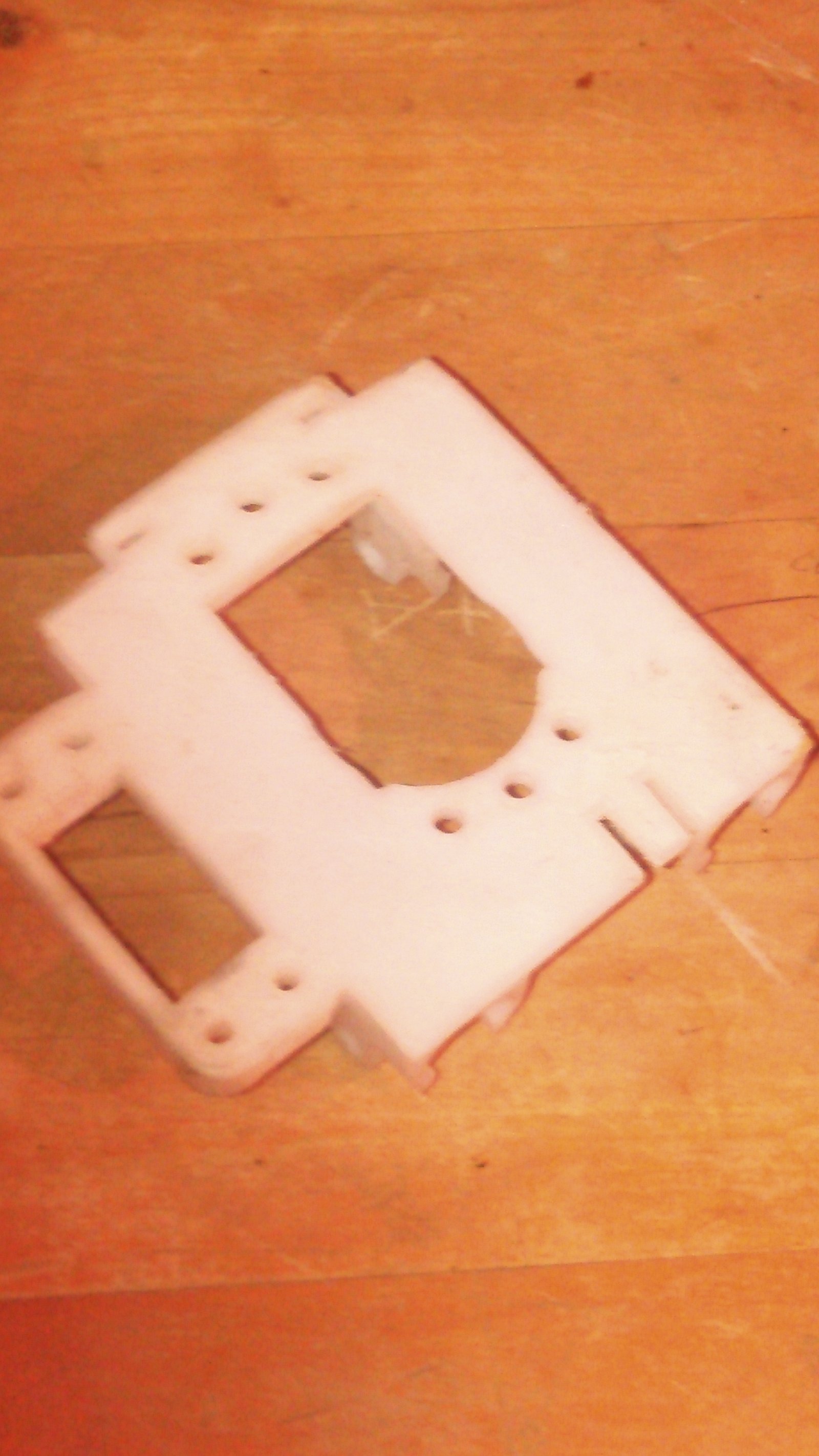

Ok great sales pitch I think you may have missed some points in this thread. The OP has a second machine But he is looking to renovate this printer not build a new one My prusa has been a good stable machine for almost 5 years But you make some good points a rigid frame is important so now is a good time to go through and tighten everything and make sure everything is true and square I agree the e3d is a great upgrade get your machine up and moving again First your extruder / hot end worked before so you can use it to calibrate your new control board and stuff while you print your new carriage for the e3d if you need I would recommend a auto leveling up grade for sure it was the single best upgrade I made to my machine it went from failing 50% of the time and constantly leveling the bed to just pop in the and card and print. The auto leveling setup on the carriage I posted uses a touch probe which lets you use and build surface you like, where a inductive sensor needs a aluminium or copper or steal bed. I use glass on mine. My second printer has a steal bed with a inductive sensor on a boxed wood i3 frame with one piece printed ends and I would say its probably more rigid than any plate style prusa i3. But my j head and touch probe on my prusa just work With a little aquanet on the glass I can print pla with a bed temp of 60c and get a glass transparent and smooth base

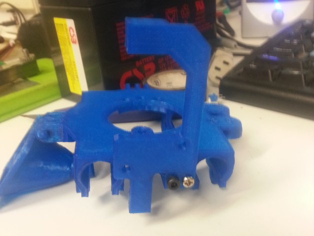

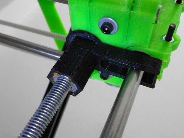

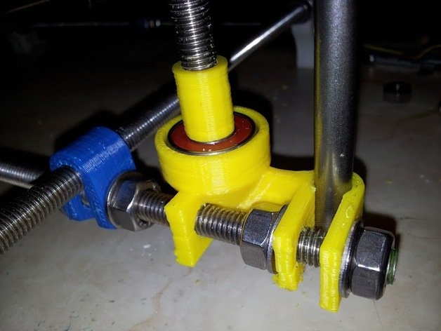

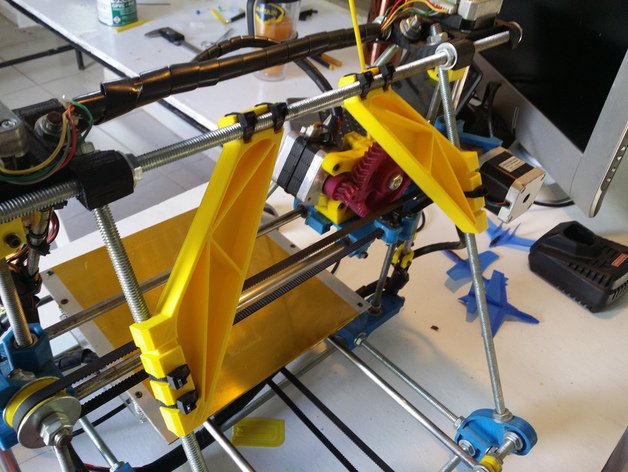

There are a few other great printable upgrades like wobble isolators bearing holders for the bottom of z rods one piece motor mount and top frame parts I will this evening compile a list of thingiverse links for you that I would recommend

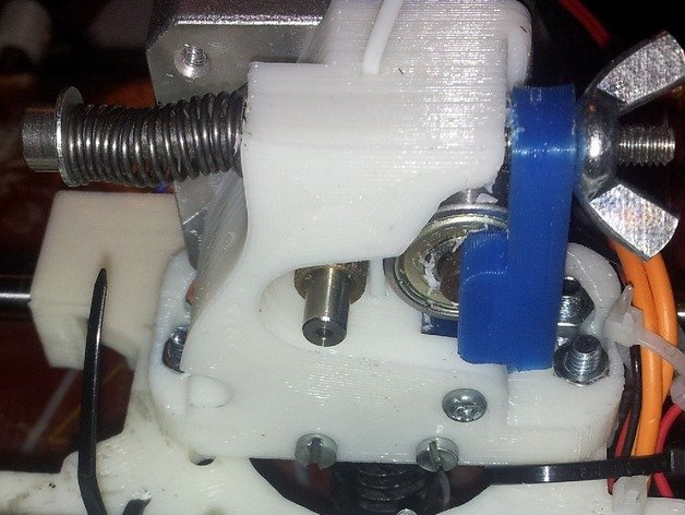

I have a prusa I2. I just installed the e3d titan and e3d hotend. It was a trick to get it on those horizontal parallel rods. Look.
upgrades I would do
x carriage
frame braces
extruder with a mk7 gear
z rod clamp
z motor mounts
z screw isolator
or

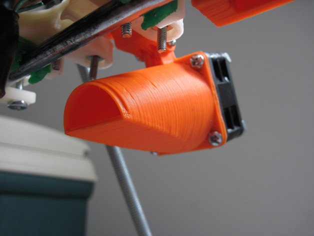

and then find a fan mount kinda like this
these should all be pretty inexpensive and were most of what I did to my machine it made a big difference
