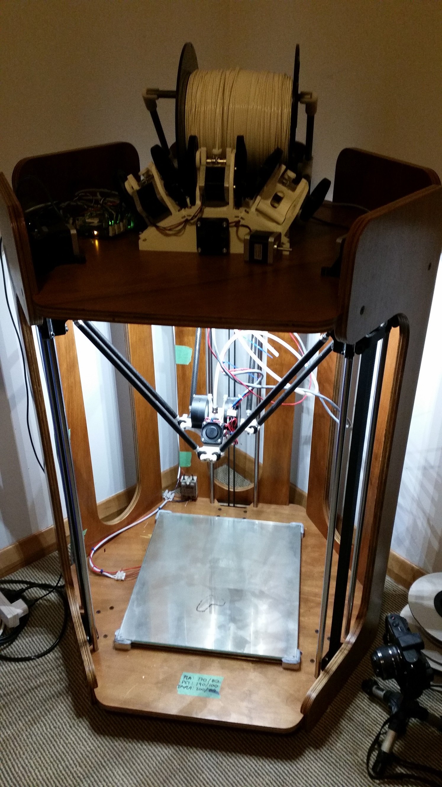

GT3/15mm wow! How tall is your printer? How long are your arms?
Could you please share us some pictures of this beauty, I would love to see it.
Did you tried to hang the extruder above the platform with a counterweight(flying extruder mod)? It can solve the long bowden issue.

Its a bit of a mess at the moment, perpetual work in progress and all that. To be honest I wouldn’t recommend GT3 15mm belts either, it was just an example of how things change when you stretch a delta. If your belts get too big you need bigger diameter pulleys, as your pulleys get bigger you lose your positional accuracy which you need even more as your print area gets bigger. There’s tradeoffs and compromises everywhere. My best results were probably with T2.5 10mm with urethane + steel belts, but my Chinese pulleys weren’t very round and that created other issues. My GT3 doesn’t stretch at all but my pulleys are a bit under size for steel reinforced belt, its not as flexible as nylon or Kevlar reinforced belt. I have not tried a suspended extruder, though I like the idea. I have a massive triple extruder for a diamond hot end and I wouldn’t want to try and suspend that…
