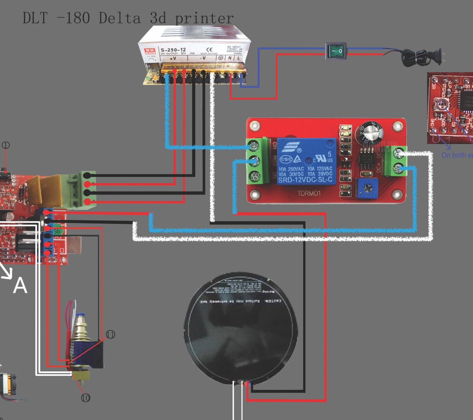

I had a problem with my board / power overheating (previous post) and have ordered a new board.
I’ve also ordered a relay in order to avoid such a problem in the future.
I’ve attached a diagram of how I think this is supposed to be wired.
The relay I ordered is for 10A, but I think the heat bed can pull up to 11A.
So my questions are:
(1) Does this wiring diagram look alright?
(2) Is using a 10A relay OK?
Thanks!

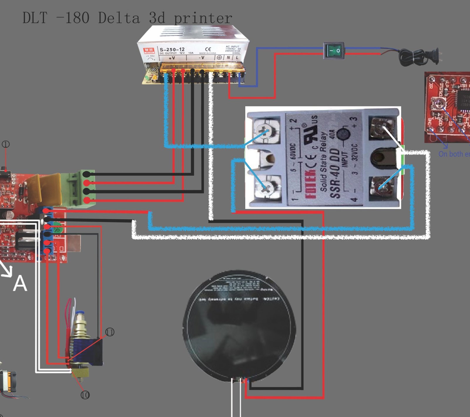

I would not recommend to use a normal mechanical relay for a DC heabed as it will make a lot of switching with high currents and DC power have the tendency to make arcs so it will kill the relay in a few months (it will look like your melted connector, if not worst…)
Please use SSR (solid state relay) DC-DC type the are really cheap and can handle high currents(40 Amps)
Here is one from ebay:
http://www.ebay.com/itm/New-Solid-State-Relay-SSR-40-DD-DC-DC-40A-3-32VDC-Input-5-60VDC-Output-X5RG-/251656361870?hash=item3a97e3578e:g:lj4AAOSw2GlXIe3w
The wiring will look like this for this SSR:

Have already ordered this SSR.

OK, Your schematic is fine. Now, the relay is Rated 10A for 30VDC so it is good for up to 300 watts. That is 12.5Amps at 24VDC, So No Problem there.
You may get some arcing on the relay points when it opens (Temp achieved), then more as it will be turning on and off during the print.
That will eventually make it stop connecting, but you can clean the contacts and get more life out of it IF you can open the relay to get to the points.
What is your voltage and what is the resistance of the heat bed? This will tell us what the current will be.
Also, many heaters change resistance as they heat up, No Telling if it will go up or down without knowing what material the heating element is made of.
I doubt you will go over 10 amps tho.

Final update: I installed the 10A switch first (because the SSR had to ship from China and Japan - I ordered two), with one modification. There was also a signal line (DC+/DC-/IN), so I split the +ve wire from the board to the DC+ and IN). This worked fine.
Then I received the SSR and installed that. One change from @tpalagyi’s diagram though, I wired the +ve wire from the board to the + 3 on the relay, and the -ve wire to the - 4 on the relay. I’m not sure if it makes any difference, but I just wanted to keep those consistent.
All up and running now. I might give this a shot now and see how it goes before upgrading to a whole new silicon pad setup.
But so far so good, thanks everyone.

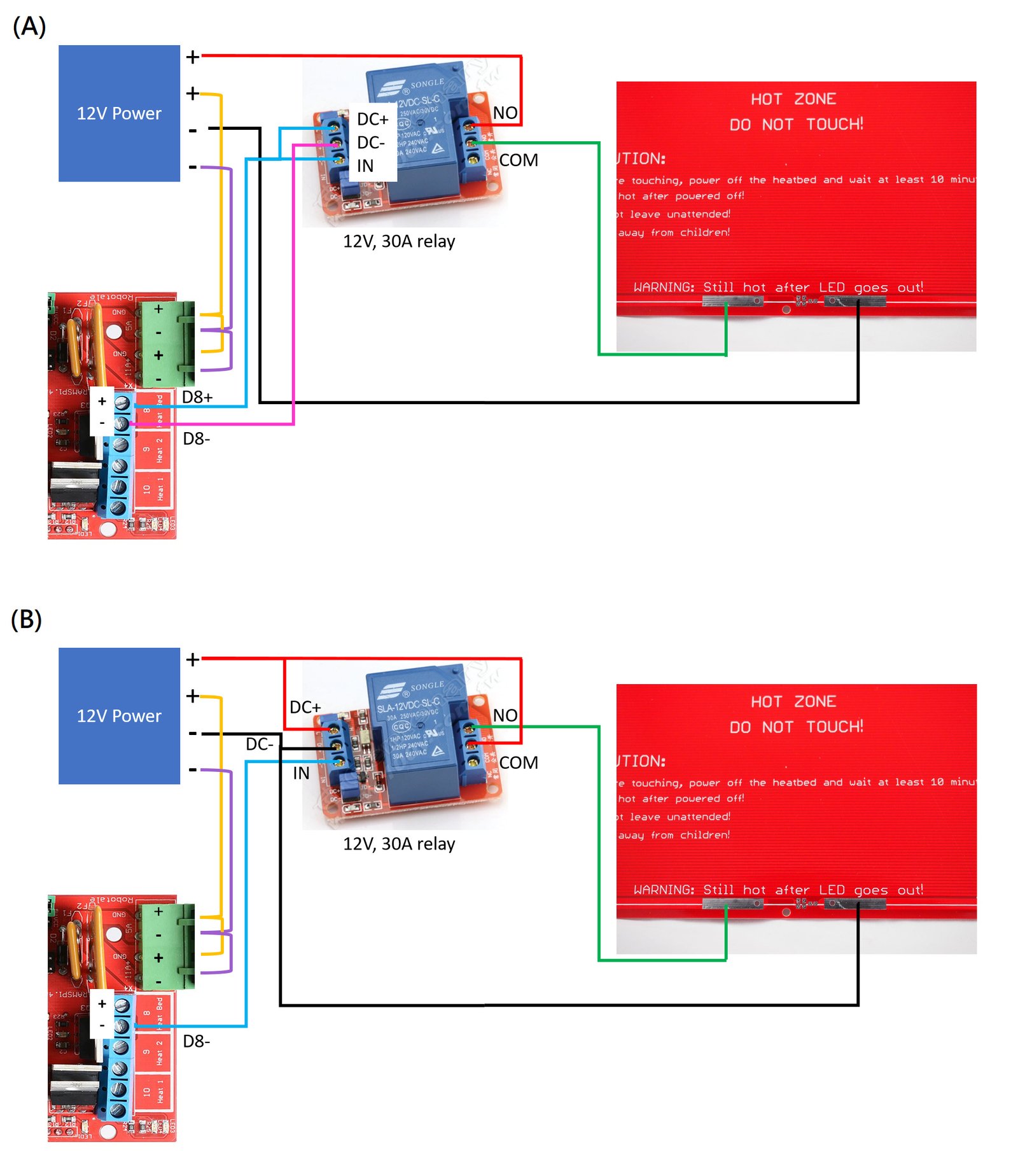

Hello, I bought a 30A relay with six slot (DC+/ DC-/ IN/ NO/ COM/ NC) . So I schemed out the circuit diagram as you said before.
I wired the “+ wire” from the 12V power to the NO slot on the relay, the “+ wire” from the COM slot on the relay to the “+ site” of the heatbed, the “- wire” from the 12V power to the “- site” of heatbed, the “+ wire” from the D8+ slot of RAMPS to the DC+ and IN slot on the relay and the “- wire” from the D8- slot of RAMPS to the DC- slot on the relay. As the picture (A).
Is that right? World it work fine? Because someone tell me that I need to wire the line as the picture (B). I don’t know which one is right. Could you help me please? Thanks a lot!!
