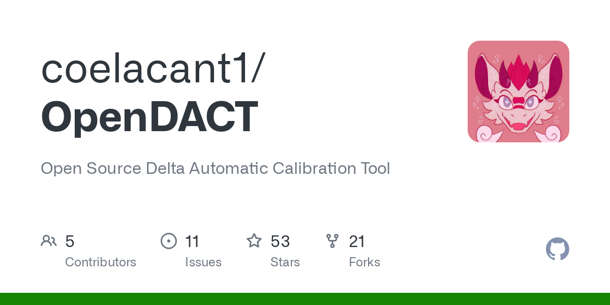

If you are on windows check out openDACT, it is an automatic calibration tool.
You are using in at your own risk though.
My Hatchbox didn’t work quite right from the day I got it so I am constantly messing around with it trying to get it right. The openDACT is the latest I found and it seems like a great tool, I just didn’t have a chance to try it yet, I mean, I ran a calibration, but it was too late at night and I didn’t print any tests.
Before you use the tool, make sure everything is tightened and your belts are not flapping around too much, I’ve heard that the joints can become loose after a while and you need to re-tighten them once in a while. Mine never had a chance to come loose because I didn’t print more than just a failed test prints lol.
How do you download open DaCT? I can’t figure it out on github
Follow this link:
for the diadonal rod enter 356.5, at least that’/ how long mine are.
