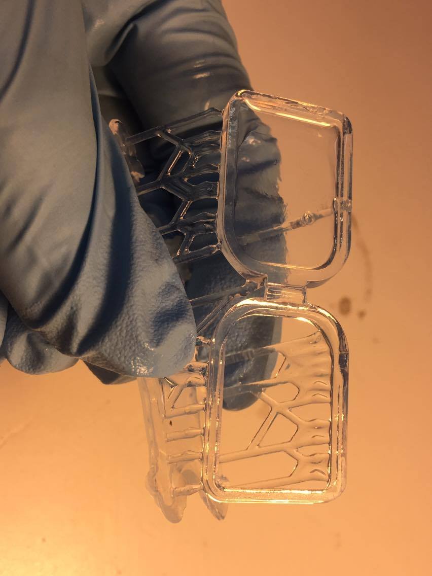

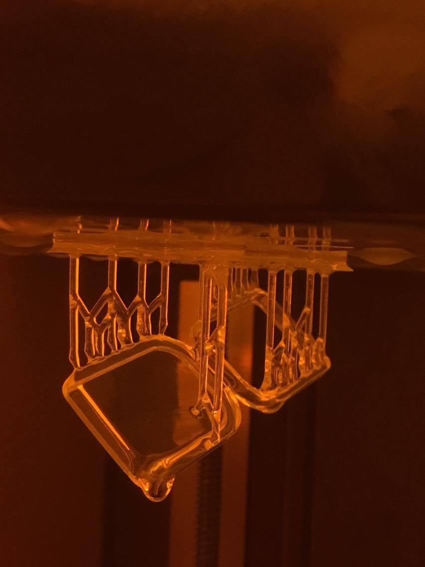

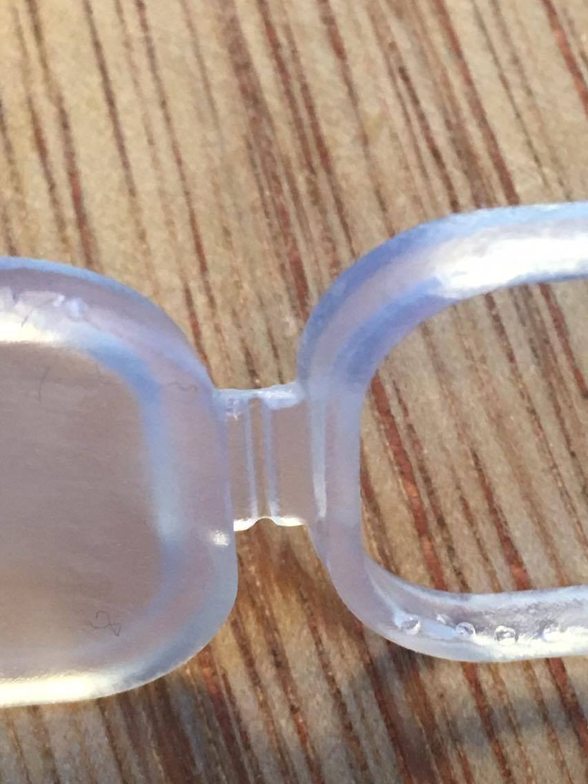

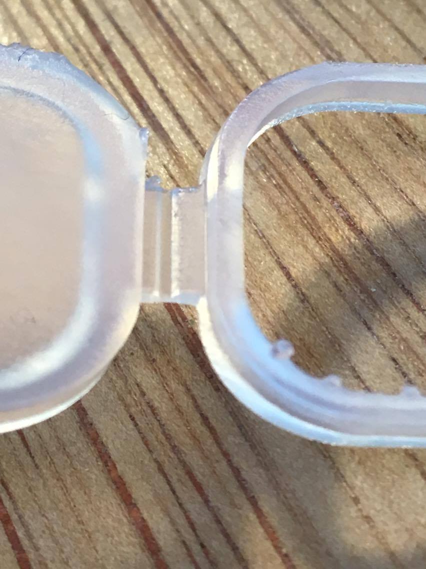

It’s absolutely brilliant! Simulates polypropylene perfectly! Also looks very similar to the clear standard resin. I’m using it to simulate injection molded living hinges. That being said, the hinges cannot be exactly to the same specs as injection molding, but beefed up a little bit and will produce EXTREMELY similar results.

This is great, thanks for the pictures!

Thanks for sharing these photos with everyone!
I’m looking at printing living hinges too and wondered what design guidelines have worked best for you if you wouldn’t mind sharing? E.g. things like hinge thickness and minimum radius?
Any info you could share would be great :slight_smile:
