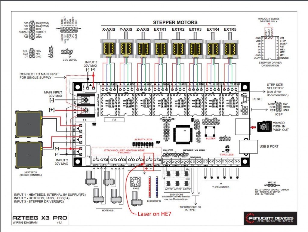

I am in the middle of building a gigantic 2 cubic meter 3D printer, ad it’s going surprisingly well. I have some basic questions about putting the electronics together.
  • I have 14 NEMA 17 motors that need 4 volts, 1 amp each. Can I simply hook them up to a solderable plastic breadboard connected to a power supply like one of these without damaging the motors, transformer, or burning up the little board?? What power would I need to get? (5V, 12V, 24V, and 1a, 2a, 5a, 15a, 20a, 25a, 30a, etc?)
  • I am using an Azteeg X3 Pro with a 12v 20a LED light strip power supply. It has 3 power inputs. Where do I plug what power supply into? Do I really need 3 power supplies? (The wiring diagram is attached)

You might want to check what the breadboard is rated for, otherwise… i have ran steppers ovee there rated voltage, you just have to dial in the current on your drivers. Im curious what direction you went with for your rails? Type, size, ? Would you be willing to share source? Im building a 2ft wide printer
