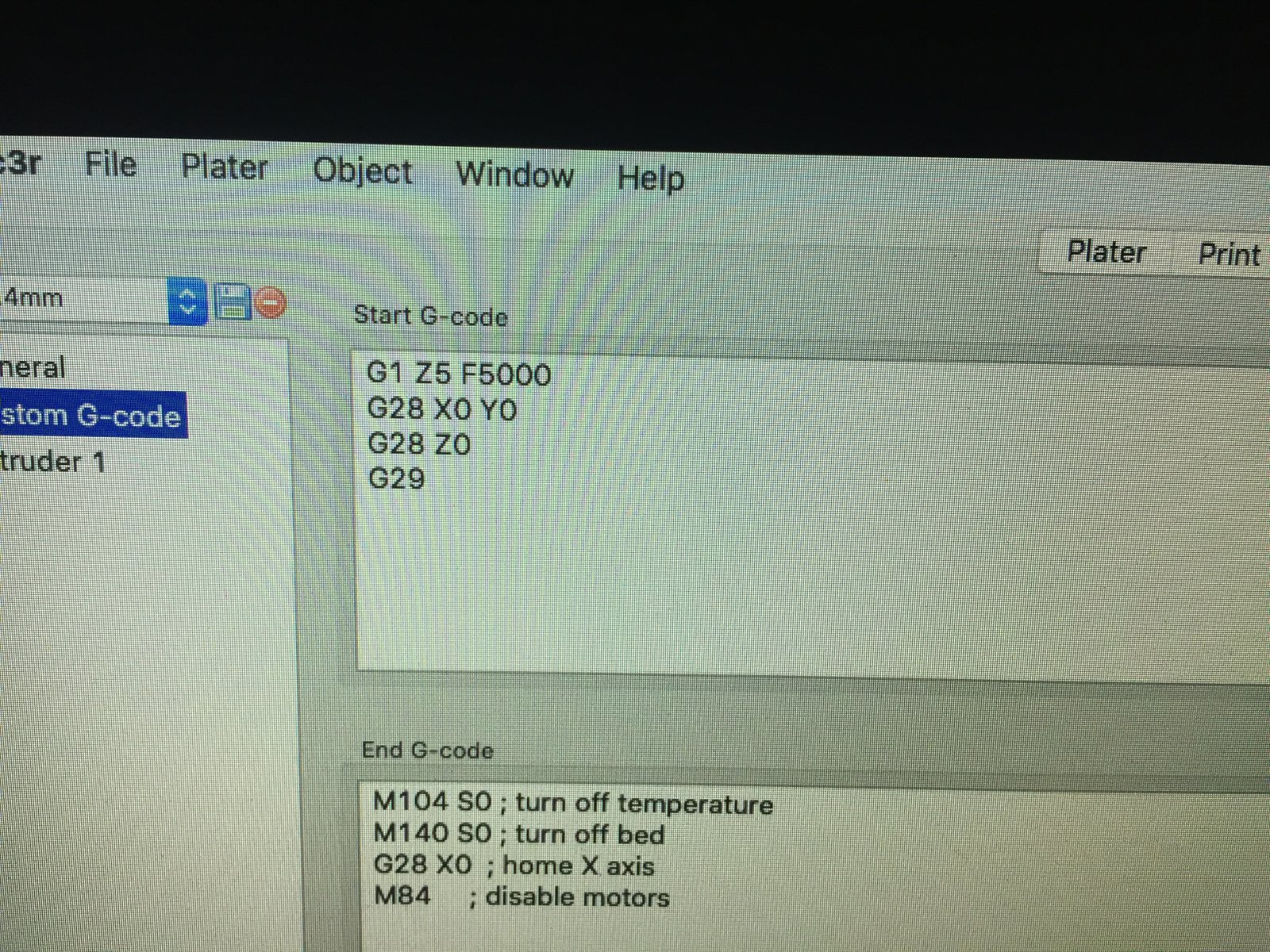

Change your homing gcode to match the one in the pic… You are missing the home z line
m212 should not be part of your start code…
it it needs to be entered into the console followed by M500 to save it before you start a print…
i suggest starting at 0 and working down until it is calibrated
M212 is a setting that gets stored on the board. After you send the command “M212 Z0.1”, you then need to send “M500” to save. Once it’s saved you don’t mess with it unless you have to change it so you don’t need M212 in your start code. Also you can send “M501” at anytime to see all the current saved settings. REMEMBER, unless you send “M500” after, the setting is not saved. That’s why your start code had no effect.
