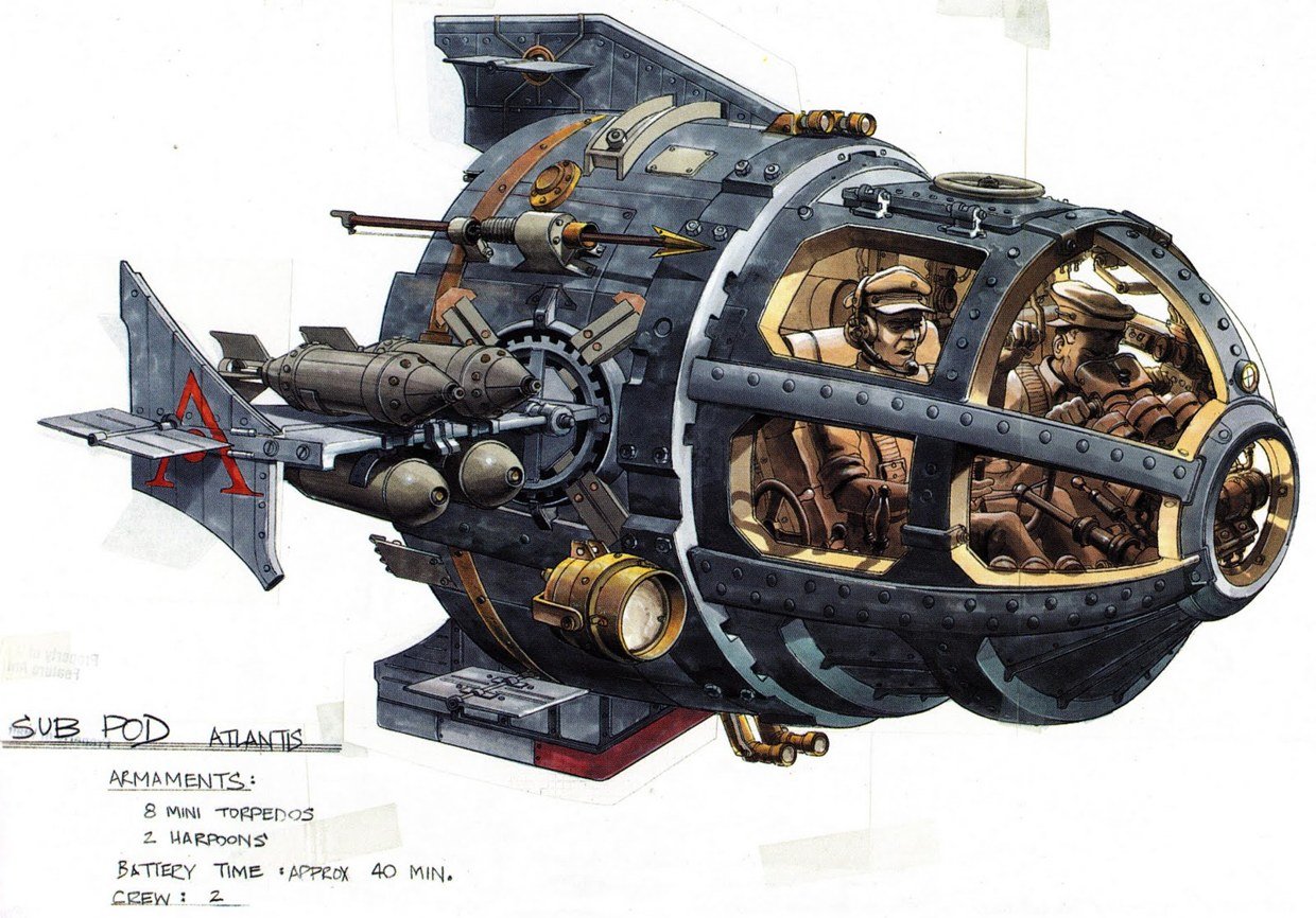

While getting some inspiration on Pinterest I came across this concept sketch of a Steampunk-looking submarine. I always like concept art, mostly because it doesn’t see the day of light in production and I find it a challenge to create it in 3D and even more: print it! How cool is it to have something in your hands that was actually just conceptual!
Anyway, apparently this piece of concept-art is from the animation movie “Atlantis” by Disney. I really don’t know who designed the concept so I can’t give any credits to it. I took it upon myself to see if I could actually model this in 3D and have it printed in detail.
The concept drawing that I found…

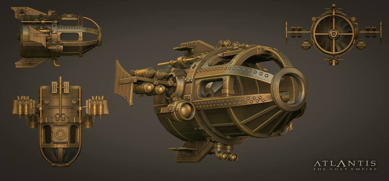

Main purpose here was to see if I could brush up my modelling skills in Zbrush and model the whole thing with that software. Zbrush has (or had these days maybe) the reputation of being a bit difficult if it comes to do some hard-surface modelling but it can be done. Pretty good actually. I didn’t have any side-reference pictures or anything so I had to eyeball this one.

Some views on the final version of my model…
Taking my printing resolution in account, I can’t go that detailed. For example, I wasn’t sure that the “spear” on the side of the main body would be printable as with the “missiles” on the wings. I decided to create and print most objects separate so I could print it in a bigger size. A quick tip on this is just to check what part is going to be the biggest to print. Everything else will be surely printable as it is smaller.

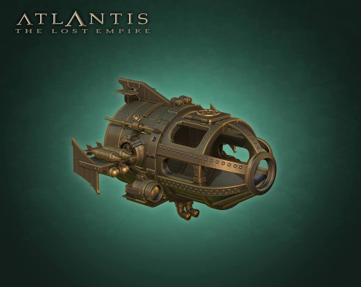

Final version of the model…

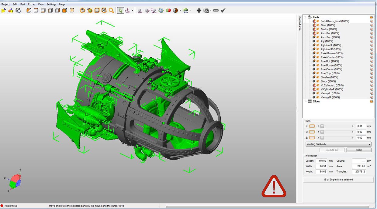

Printing it was fairly easy. I had every part loaded into Netfabb (my weapon of choice for checking, scaling and fixing models), checked everything and eventually scaled the main body to accomodate the buildvolume of my printer. Every other part would easily scale with it retaining it’s relative proportion. I exported everything out and fired up my printer. Most pieces were relatively small, so printing most of them took about 1 to 2 hours per object or sometimes I did multiple objects at once. The hull was the biggest as was the backengine part. This took a few more hours more. I did calibrate every 2 prints just to be sure and have the best prints.
Checking in Netfabb

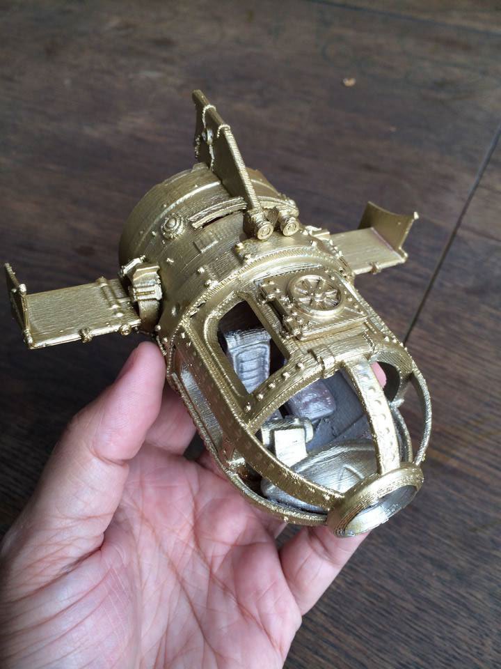

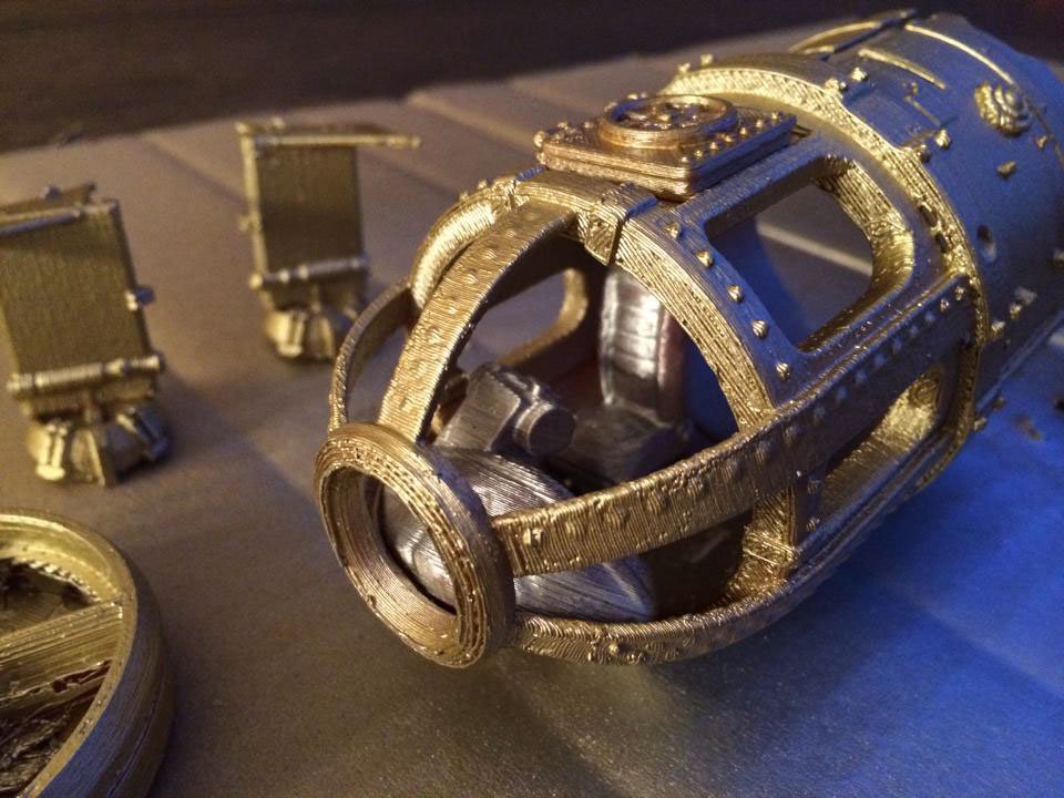

Cleaning up everything, the support printed comes off without resistance, it’s magic! Firstly I try to see if there’s warping and if everything fits as it should be. I didn’t make the holes or cuts slightly bigger this time, I really wanted a tight fit. I had some good plastic-glue (Bison brand) lying around (which REALLY sticks…at one point I thought it actually melted the plastic of fused it somehow) and that did the job of holding it together.
Finally I spraypainted it whith Gold (cheap brand from the Action store
) the original plastic color was Pink by the way, so I really needed to paint it
Only quirk with painting is that in some case the printing-layers will stand out a bit more. Time to save it for something better!
As goes with al the other stuff that’s symmetrical. Printing everything took a day or 2 I think… Since a lot of people are really excited about this (you have my gratitude!) I really want a 3D printer again haha!!
