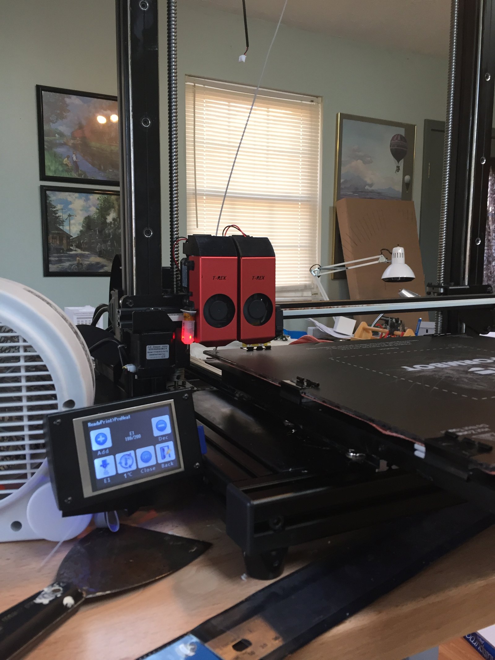

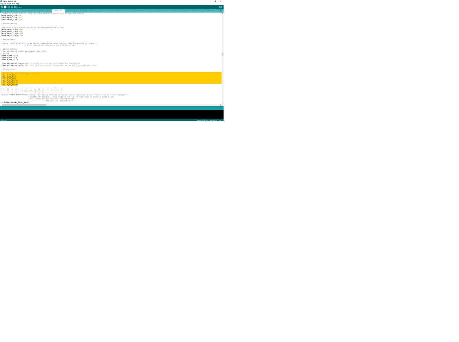

Sorry for taking so Long Joe I had to work today. So I think I may have found out what happened to your machine. So you are using dual extruders. In Formbot’s instruction to use dual extruders they tell you to set the extruders 200 mm apart. I don’t use dual extruders because my prints are usually to large to allow for dual extruders, ( I sent a picture of how my extruders are arranged, right next to each other.) If you use dual extruders and set them up 200 mm apart, you need to change the travel limits in the firmware to 200 mm*400 mm*470 mm. If you don’t do this the controller will think it can still drive your extruder 400 mm span and it will drive your second extruder right off the bed. I’m trying to attach Formbot’s manual that tells this.
As for the firmware, if you look on your SD card, under Marlin Firmware / Marlin / Marlin.ino. Marlin.ino is your firmware file. Double click to open it up. If you look under the configuration.h tab then select edit and then select find, search for "travel limits" . Before you make any changes, make a copy of your original firmware. Change the travel limits to 200, 400, 470. To download the changes, notice I’ve highlighted the upload button in an attached picture. Connect the provided USB cable to your printer and select upload. Arduino will search for your machine and if it finds it, will load your changes to the printer. I’m having trouble attaching pictures, I think I need to reboot my computer but I will log back in and attach pictures in a separate reply.
Hi Joe, these image files might help you understand what to do. I may be wrong, maybe you didn’t set your extruders apart, but it sure sounds like that’s the problem
