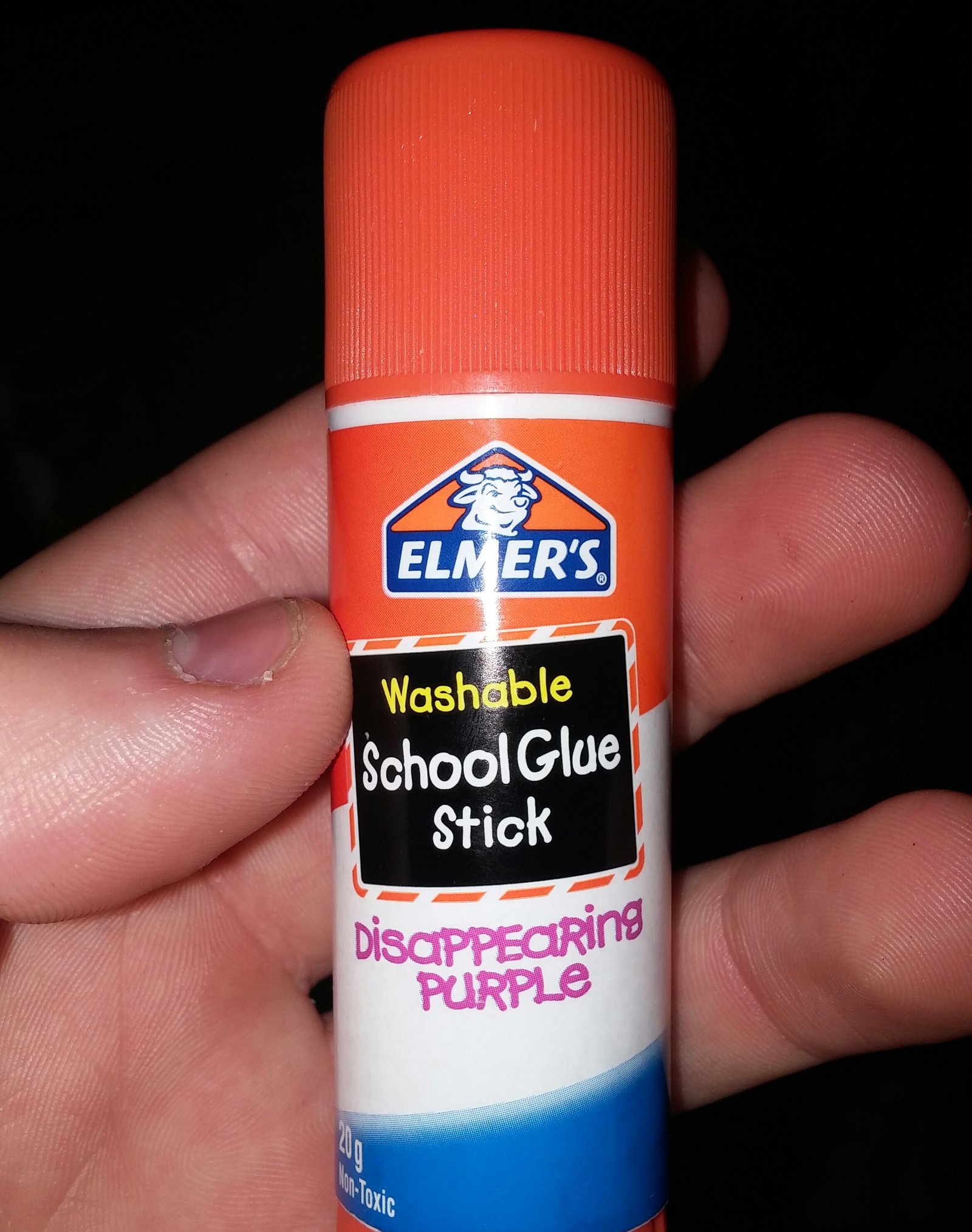

I’ve had trouble with print adhesion when I started printing on my XYZ Davinci 1.0 AiO. Then I start using Elmer’s washable glue stick and then I had no problem at all. Easy to clean and since the color is purple you can see where you applied the glue on the bed. Highly recommend. Give it a try! Mik3D Printing Solution
