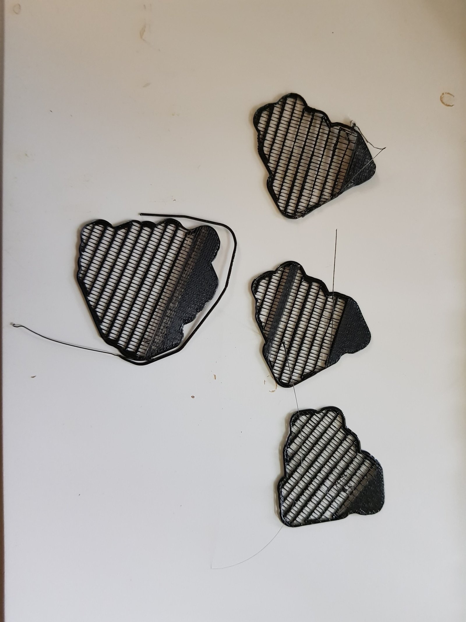

Anyway. It starts extruding ok, not perfect, but working. And then it stops all of a sudden, almost always in the same place. See picture. Changed filament as well. been dusting and cleaning in and around the printer.

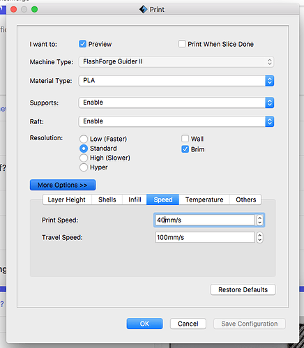

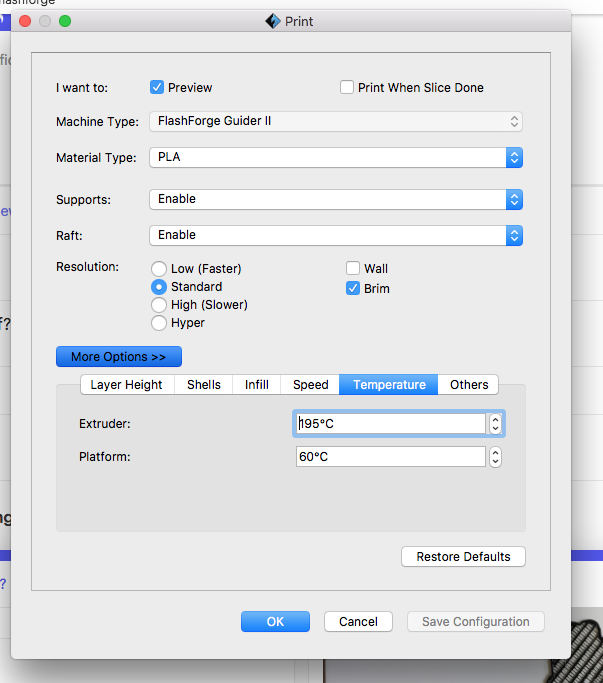

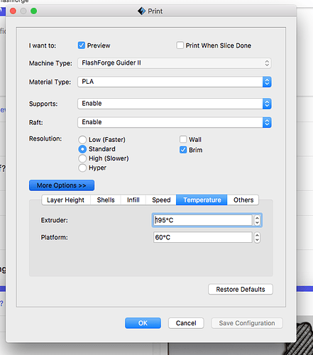

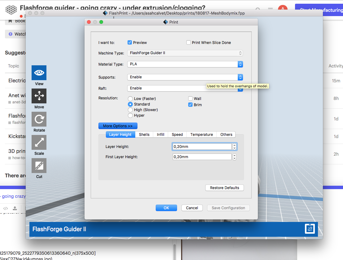

Current settings:
See picture below (next post)
setting 1
setting 2:
setting 3
