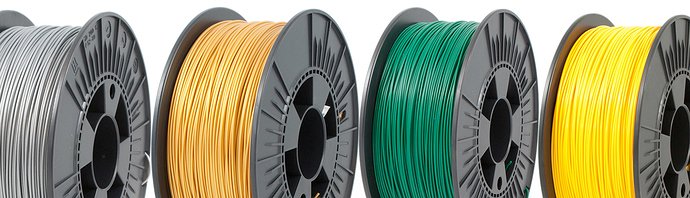

Filament guide
We published a filament guide which explains different cases about when and how to use filament.
  • Combine multiple materials
  • Different materials (comparison)
Each material has it’s benefits and good use, we’ll explain the differences between the filaments in short. To make it easier to compare the different filaments we also gave them rankings (scale 1…10) on their most important features.

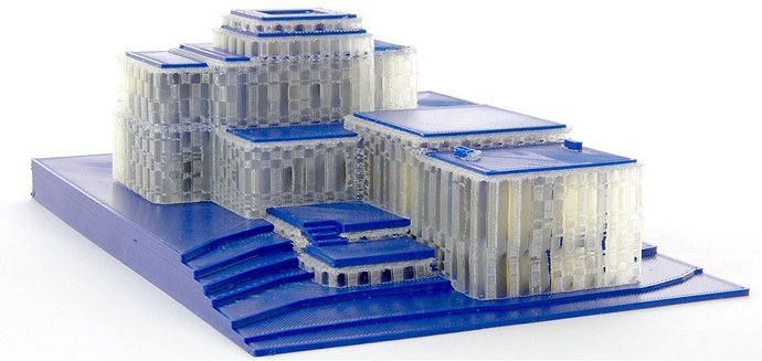

A house printed with PLA and PVA to support the roof. The PVA (transparant) can be washed out with water.
