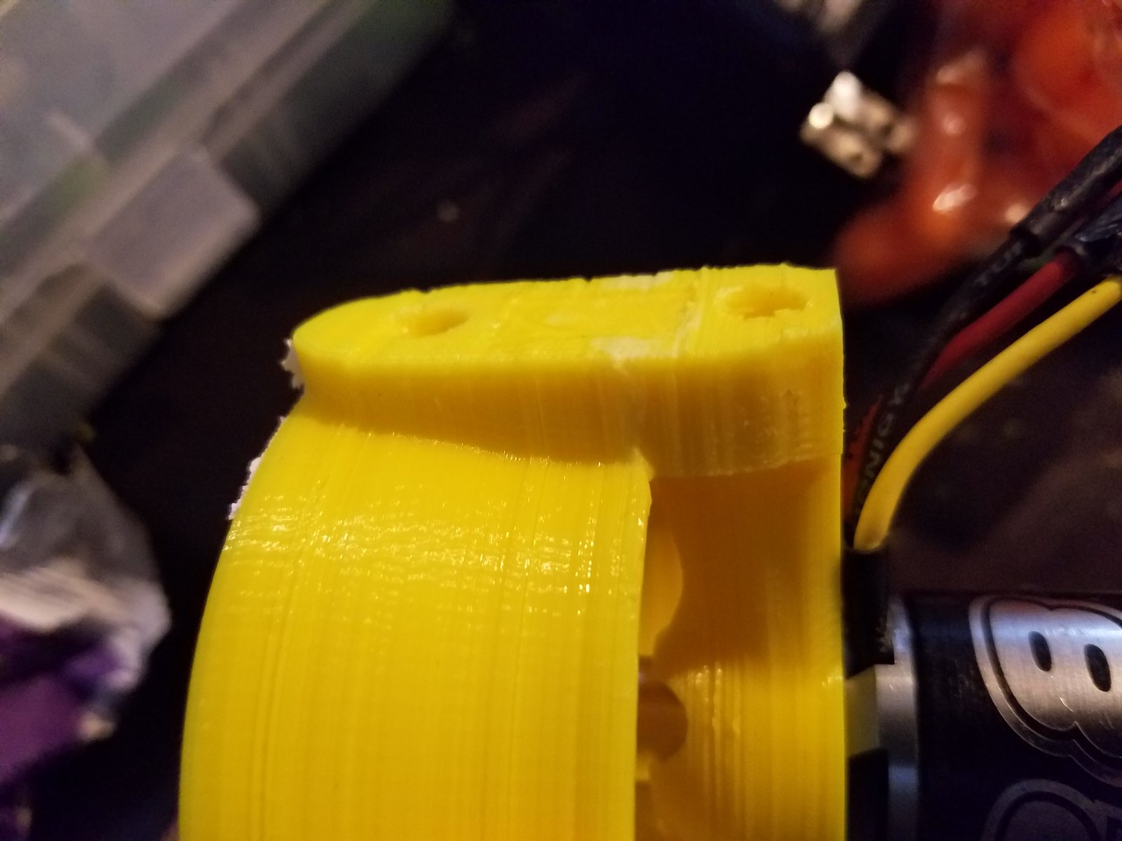

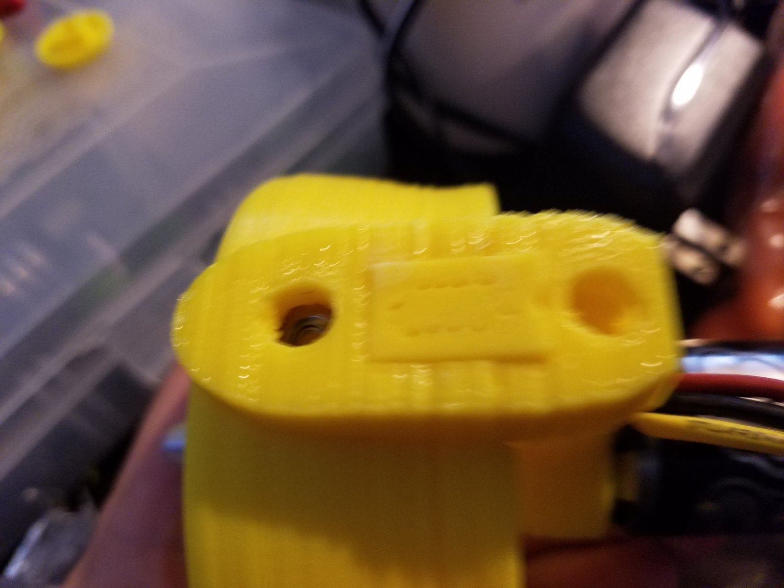

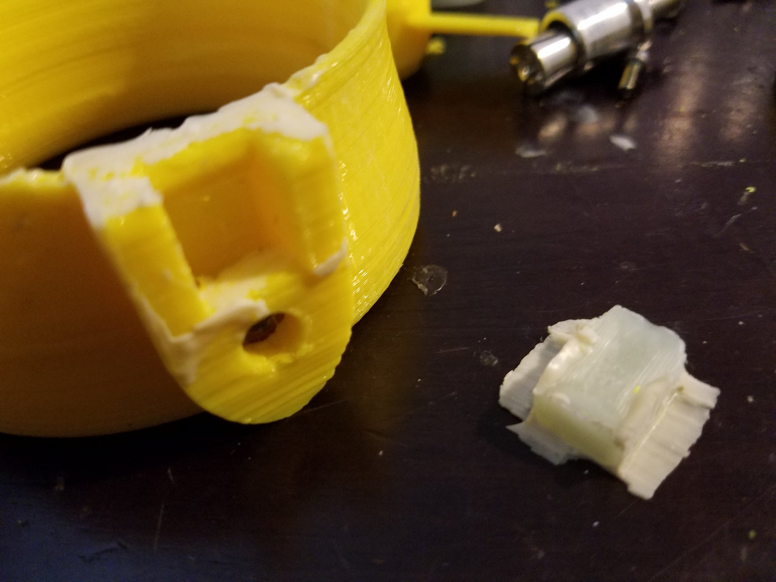

I am building an underwater ROV and have 3D printed thruster shrouds and props in yellow Hatchbox PLA. They did not handle the vibrations and power from the motors very well and split along the junction of the mount and shroud that were 3D printed. To put them together I used 2 part epoxy rated especially for water, but 2 of the 4 have already broken along the glue line and some of the props are also shattering too from the stress (Fully 3D printed with no glue used for the props). Maybe using an epoxy is the wrong glue with the PLA, but I thought this would be the strongest I could get since CA is very prone to cracking with the vibrations.
So is there a better glue to use to fuse PLA together than H20 hold epoxy?

the PLA solvent you are looking for is dichloromethane (DCM). as found in:
  • scigrip weld-on 3
  • scigrip weld-on 4
  • scigrip weld-on 16
  • plastruct plastic weld
DCM is a true PLA solvent and will melt PLA, welding it together for a true PLA bond.
weld-on 3 and 4 are thinner than water, about as thin as ether. they can be tricky to apply. easiest to use a syringe.
neither acetone nor MEK can even scratch PLA.

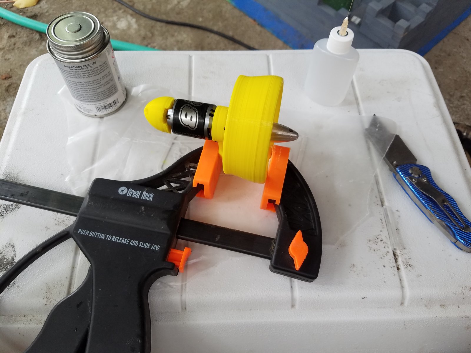

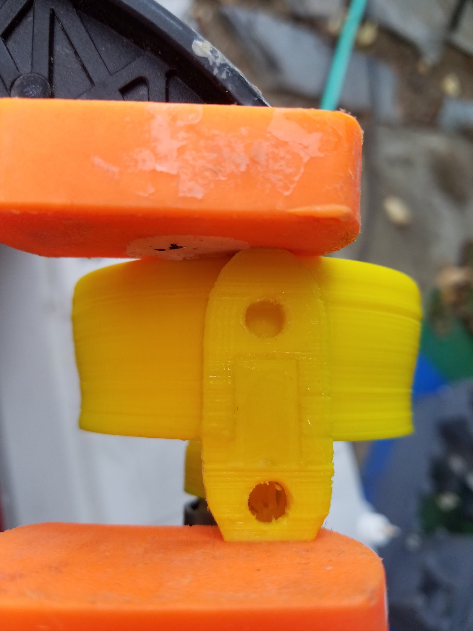

I am trying the acrylic glue right now (#3 That is really thin. Had to use a syringe to apply it) It looks like it has “melted” the PLA together, but it will take atleast 24 hours to check. The old H20 epoxy did not even bond with the PLA so I was able to pull the pices apart way too easily…
I tried the acrylic #3 glue and it worked really well so far. It really does melt the PLA. The joint seems really strong and is so much better than H20 epoxy!

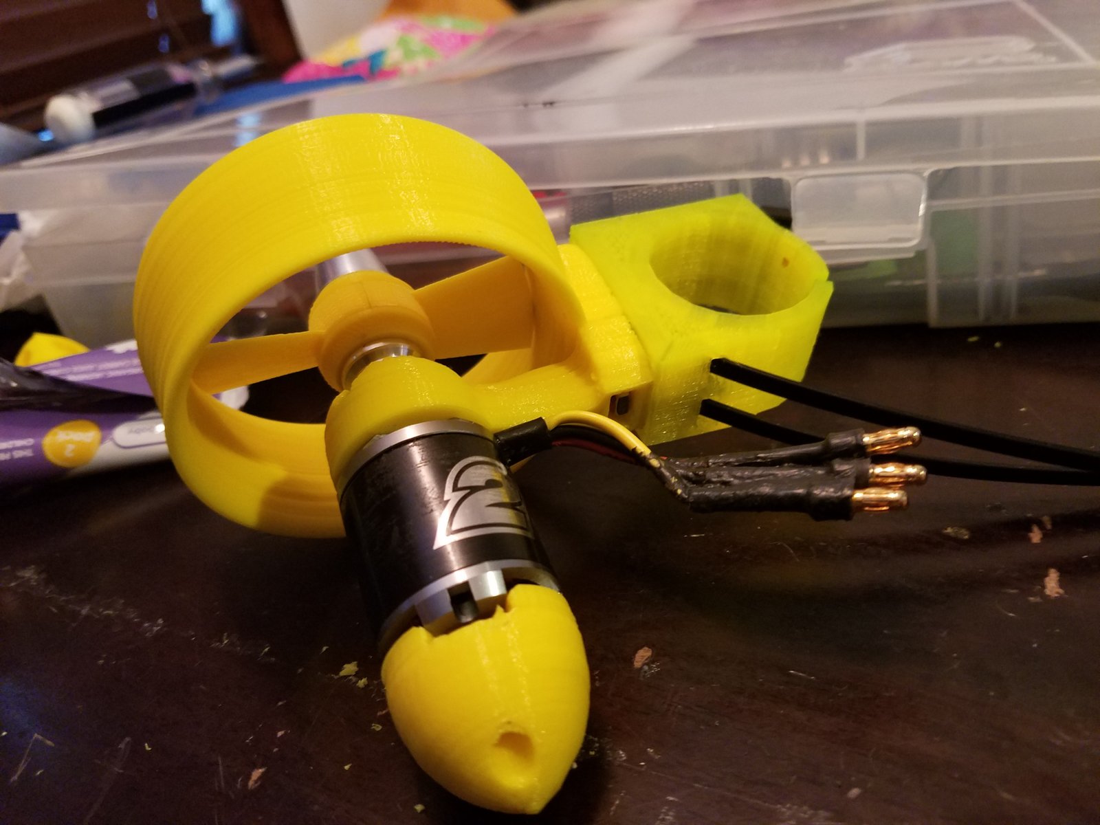

I used the acrylic glue #3 on the ROV thruster and it works great. Looks like it will hold up to the vibrations! Hopefully the PLA will hold up to the extreme weathers… if not I will switch over to ASA… Thanks for all the help and suggestions!
Thanks for the update. I got some gel CA to try out that isn’t “instant” bond. My part isn’t going to be subjected to the stresses of yours! This will be round one of testing glues. I’ll look for the #3 also and have some on hand.

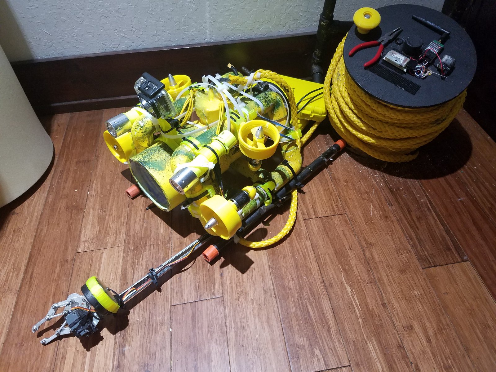

Here is the finished product made from 3D printed parts and recycled junk around the house. ?
