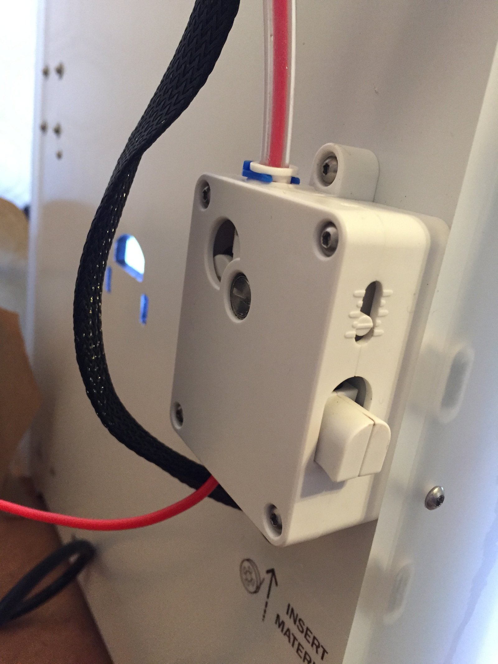

and increasing the tension to about 3/4 tightness

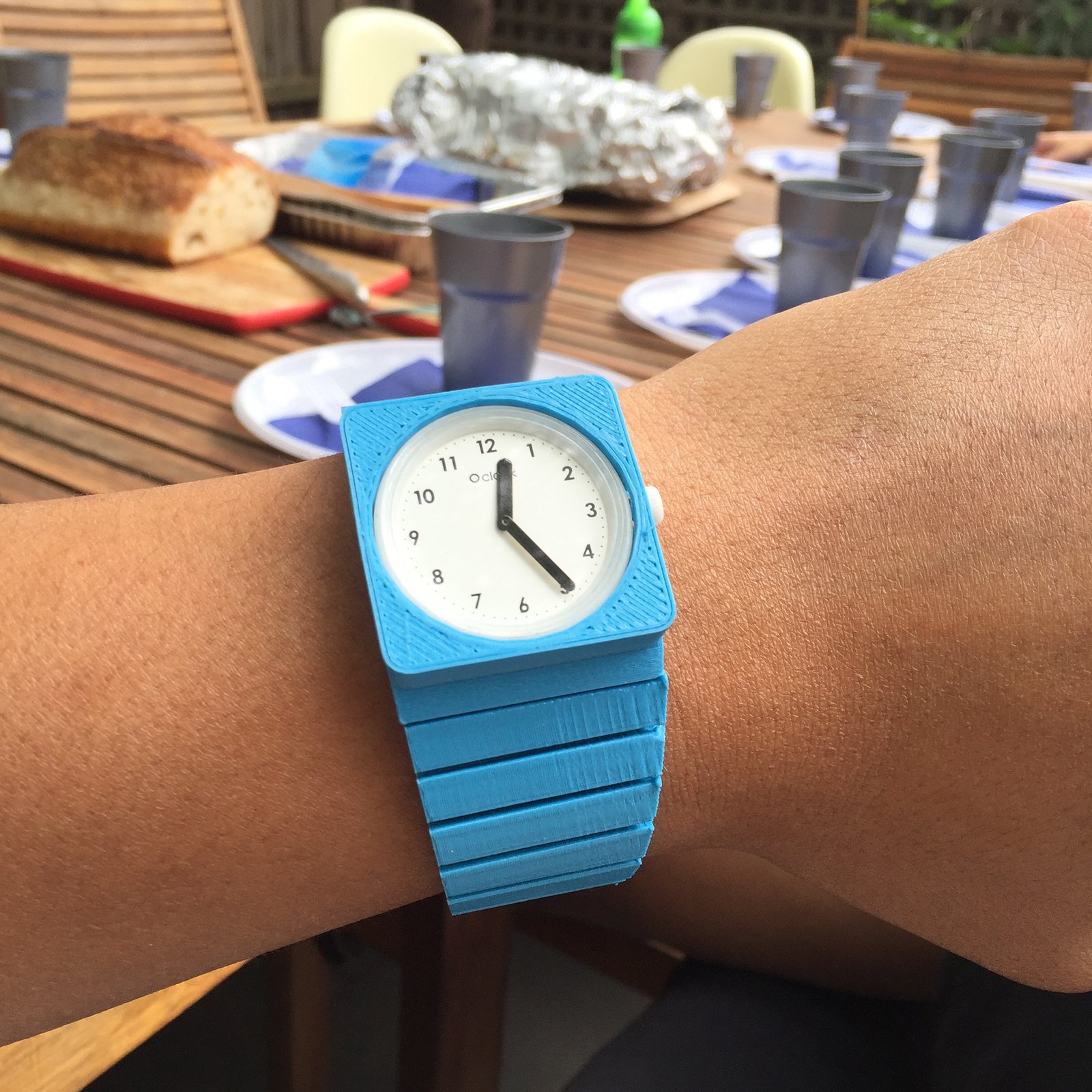

The shoe is from Recreus called Pixel shoe
watch and wallet are by us available on youmagine

Material feeder tension setting

The main advantage doing this is the possibility to install an Olsson Block and also that the Ultimaker Original + has a geared feeder, which I find slightly more reliable than the Ultimaker 2 feeder.

Can someone to make a 3d model of the new feeder so we can print it? I will be pleased to do it if someone borrow me one for a couple of hours.
Not only the feeder housing but also the bolt and the motor have changed.

If someone wants to send me a feeder, I’d take time to “copy” it and share ready to print stl files.
(and of course I’d send the feeder back)
