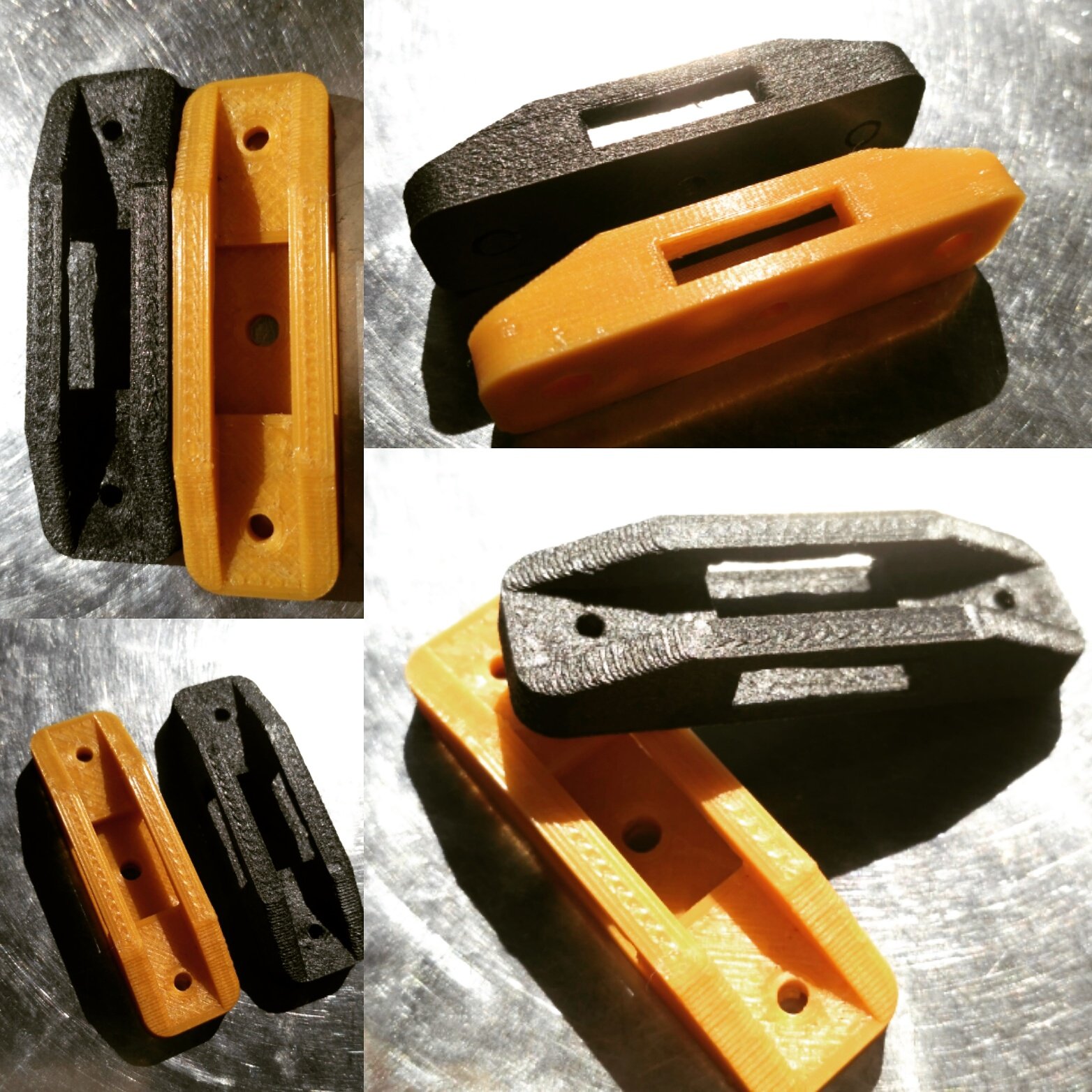

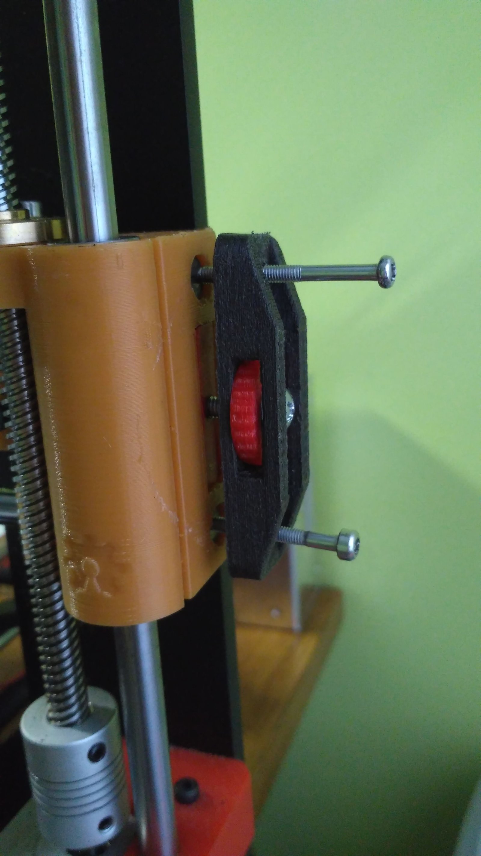

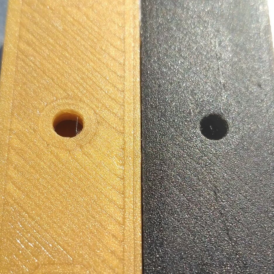

Weeks ago I decide to test this filament. Nice decission, good one to use for all parts you want to use for long. Most of my costumers are getting parts printed with nylon-carbon fiber and are really pleased with them. To print with this filament I use the same parameters as I use for NGEN with one difference, the heated bed have to be primed with hairspray to ensure the adhesion. 240 C for the first layer 230 C for the rest. 60mm/s ( reduced to 50% for first layer) 75 C heated bed with buildtak and Nelly Really nice filament to print with. The pics are for one piece made in NGEN and FIBERFORCE CARBON.
