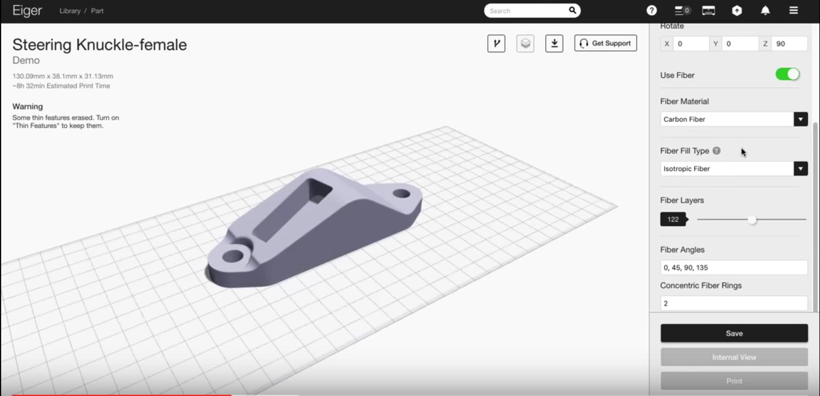

Q: can we make part, partly both has fiber and nylon, partly just has nylon
A: You can set it up in Eiger to select which layers have fiber and which do not, as shown

Q: When would you choose each fill type? Can you give examples where isotropic would be better than concentric?
A: In general, isotropic gives a stronger part, especially in bending along the X and Y axes. Concentric is good for giving torsional strength, strength along the outer contours, or for very specific loading conditions. More detailed answer here: Onshape

Q: can you customize fiber angles, if so is there maximum
A: Yes! You can create whatever repeating pattern you want. The details on how to do that are covered in this blog post: Industrial Additive Manufacturing Platform | Markforged

Q: is it possible too switch from isotropic to concentric in the same print?
A: Yes, the fill can be adjusted within each layer of the print.
Q: Can we print a sheet with fiber on top and nylon on bottom. That design would allow flexibility in one direction and not in the other. (carbon fiber will compress but will not tension…) Am I correct ?
A: Yes, this can be set up in Eiger: what you would do would be to go to the internal view and only add fiber to the top layers.

Nick: I’m just going to go in and show you guys some more of the software. Right now, yeah, we’re showing Eiger. Right now, I’m actually in our Eiger library. This is what you’ll see when you go into the Eiger for the first time. We’ve uploaded some parts, but generally there are a couple preloaded parts in here. This is your library of parts. We’re actually going to touch on this a little bit later in the presentation, as well, but I’m going to go into this steering knuckle here. This is actually a part from one of the race car teams or, sorry, the human-powered vehicle team at Olin College nearby. Markforged is actually in Boston, so there’s a lot of local universities that have really cool applications that we’ve been working with. This is from Olin College’s human-powered vehicle’s team, the steering knuckle for the actual steering of their human … It’s a vehicle that they’ve designed.
This is what the screen you’ll get to or you’ll see when you first import an STL into Eiger. There’s a lot of the same options that you might see on the right hand over here. There’s a lot of the same options you might see in a traditional … We lost audio? Can everyone hear me?
George: Yeah, I can hear.
Nick: Sorry about that. Alex and Myles have just let me know that apparently we lost audio for a second, but we’re good now. With Eiger, there’s a lot of the traditional features you’d see in a normal slicer on the right over here. If I import an STL, it’s exactly the screen I’m going to get into. I’m not going to import one because it’s going to bring us right here anyway. There’s a couple things you can change off the bat. Rotations, orientation. We have obviously the Mark One and now the Mark Two printer, so that’s slicers for the Mark Two, which has the ability to reinforce a lot smaller parts with more fiber. This is fairly standard, but then you get over here to the use fiber button.
At this point, that’s something that you don’t see in any other slicer program. Really quickly, it’s going to be off by default when I first start this or first import this file, but I want to reinforce this guy with carbon fiber because I know this part’s going to undergo a lot of stress, and I need it to be a high-strength part. It’s as simple as clicking use fiber. For my fiber material selection, I have my access to all four materials. I’m going to leave it carbon fiber for now. It has also has two fiber fill types. It’s isotropic and concentric. This is also really important to strength property.
Concentric fill basically will follow the external geometry of a part. If you have a part that has curvy, specific geometry, concentric fiber fill will attempt to lay down fiber in the part just following that external geometry, starting from the outside and just working its way in based on how many concentric rings here that you’ve specified. You can go from 0 to basically as many as you want, up to 1,000 or whatever. It’s basically going to say use as many rings of fiber as possible up to that number. It may not be able to fit all those rings of fiber in a part, but it’s going to try up until the point that it runs out of space to do so in a given layer.
Also, you can choose the amount of fiber layers that you have in a part. This bar right here, from this external 3D view, is basically actually just going to give you a couple options. It’s going to give you the ability to add layers of fiber in a sandwich panel-like configuration, so top and bottom of the part, and it’s going to make it really easy if I want to just max out the part, I can just slide this bar all the way to the right and I’ll completely fill this part with fiber for the strongest part possible.
This is cool, but even more interesting fill type is actually our isotropic fiber fill type. If any of you have ever seen a traditional composite structure, whether that’s a carbon fiber hood for a car or a carbon fiber paddle or a carbon fiber boat, carbon fiber car, airplane, drone, any of that kind of things, you’ve seen that woven pattern. That’s that square weave pattern of traditional carbon fiber. The reason they make carbon fiber in those woven sheets is it makes it really easy in a nice form factor to lay on carbon fiber in a unidirectional pattern so the fibers are all going one direction. In the case of a woven sheet, it’s actually two directions at 90 degrees to each other. It’s really easy for you to quickly stack up layers of fiber in a sheet with that form factor.
We’re printing a single strand of fiber at a time, so we can’t do a whole sheet weave or a whole sheet at once, but what isotropic fiber will actually do is go back and forth and approximate that woven unidirectional pattern. I’m going to choose isotropic fiber. There’s a couple things. You see fiber angles down here. It’s actually going to layer by layer rotate the angle at which the fiber is laid down in that back and forth unidirectional pattern, and that allows you to actually quickly build up a part that has strength in all directions. We’ll talk a little bit more about concentric versus isotropic fiber in a little bit.
This basically allows you the easiest way to make a high-strength part with no hassle, is to turn isotropic fiber on and it automatically generates those fiber angle patterns, starting at 0, then changes to 45 degrees, 90, and so on, and it’ll just keep repeating throughout the part. From the strongest part possible, it’s really easy. All you have to do, select carbon fiber, select isotropic fiber, and then max out the fiber layers in the part. That’s all you really have to do to add fiber to the part. I’m going to hit save. It’s going to slice real quickly, and in a few seconds, we’re going to be able to take a look at what that did. We’ve filled this entire part with fiber so it’s going to take a little bit longer than it would otherwise, but the pathing is based on how much fiber you put. We’re uploading it, and we’re done. Cool.
You’ll also notice a couple advanced settings. This is actually fairly similar. If you’ve ever done any 3D printing, this is pretty similar to what you guys have already seen. It’s going to have fill densities, roof and floor layers, fill patterns, a couple things like rim and supports if you have overhanging features. We only print in nylon and fiber reinforced nylons. If you use supports, you’re actually going to use single-material supports and will actually print nylon supports. Basically, they’re actually much better than traditional ABS or POA supports. Nylon’s a very flexible material, so the supports themselves are really tough and they’ll pull out really quickly, similar to perforated paper. They’re printed in accordion fashion, and you can just pull them right out. They’re pretty great. They don’t really leave much of a surface defects or anything like that on the part where they’re pulled out, and there’s no breakaway, sharp supports like that. That’s not how nylon is.
Now that we have this part sliced with carbon fiber, this is great, but we can’t actually see what’s in the part, and that’s really what we want to be able to do with Eiger, so we go to internal view. It’s going to load the internal view. This internal view is actually one of the most power parts of Eiger. It allows you to see what this part looks like inside. We’re looking at essentially a 3D, almost X-ray, with the skin peeled away, of this part. This is nice, but we’ve fully maxed out this part with fiber, and I don’t think we actually need to do that, so what I’m going to do is there’s a layer bar down here, and I can actually change where the fiber is put into the part. I click on the bar. This is the selection here. I’m just going to drag and drop. Maybe we’ll just put some fiber in the bottom. We’ll put eight layers or nine layers of fiber in the bottom. It’s going to recalculate everything else. I’m going to click elsewhere, and now we have just fiber in the bottom.
In this example, the carbon fiber is blue, so that’s what you’re seeing in this operative blue, and the white is the nylon everywhere else. What if we wanted a little bit more fiber though, let’s say, at the top of this flange over here. We can actually just click on the layer bar, and then drag a selection. We’re going to hit use fiber, apply changes, and it’s just going to quickly re-slice the part in that area and give us more fiber. Now we have, you can see, a sandwich panel, top and bottom of this flange of fiber. It may be that there’s too much fiber there. It seems like a pretty thick sandwich panel, so I can just quickly re-drag and drop. It re-sliced it and now I have just a little bit less fiber here.
Really quickly, this 3D internal view, makes it really quickly to add bulk layers of fiber and select different groups where I want to add fiber to and just add fiber to those areas. This makes it really easy and really quick to reinforce parts, and the software does all of the work, but let’s say you actually want to go in layer by layer and see what’s going on and what the software’s been doing. You actually can come up here and click 2D. Now you’re in our 2D view. This is a layer by layer view of the software.
We come up to the first layer of fiber, and you see this is the isotropic fill that I was talking about. You can see that the fiber paths are back and forth. We do have one or two concentric rings of fiber around the outside of the part, which is great. That helps preserve a really nice surface finish, especially when you’re back and forth aliasing these fiber paths. You’ll notice that we have back and forth fiber throughout almost the entire part. If I scroll through, you’ll notice it automatically rotates the fiber for that full strength I was talking about, so it’s now giving you strength in all these different directions, that full tensile strength of this carbon fiber.
Then I can go through a bunch of different layers. I can scroll through really easily. You see where I now have more fiber at this layer. I can go through any layer. I can also choose a random layer. Let’s say I wanted fiber just on this layer. I could state this as layer 119. I could go click use fiber here, and fiber’s added to that part. It’s already added isotropic. I could even change that to concentric. This is what concentric would look like. I can actually increase the number of layers of concentric rings of fiber. You’ll notice now I’ve filled up just this layer with lots of concentric rings of fiber. The software’s really powerful. All you have to do here now is hit save and that entire configuration’s going to save.
George: Hi, Nick. We’ve got a question. It’s from Austin. It says, “Can you talk about the thin feature warning on the right? What feature was removed?”
Nick: I don’t exactly know what feature was removed in this thing. The thin feature warning though, you’ll notice that as we scroll through this fiber … Can you guys see my mouse by the way? Can you see my mouse?
George: Yes, we can.
Nick: See where I’m circling around right here? You’ll notice that as we go up, this feature’s going to start getting really tight. We did have two walls of nylon everywhere. You’ll notice the layer before, we had two nylon walls here and two nylon walls here. I’m going to go up here. Actually, at this part right here, it’s only got two nylon walls instead of four, what it had before, so it may be that it removed some small amount of features right at that point or it also may be that the thin feature warning is overly conservative, so it may say that at this point, especially right here or the next one right here, you may have a point where it basically is not having as many walls in that part at that point as you expected it to, so it really isn’t a big deal.
There may be certain cases where you really do need that really thin features and, unfortunately, there is a minimum path width of pre-printed nylon, as it is with any 3D printed material. To some extent, there are certain extremely thin features may not be able to be printed simply because you’re trying to reproduce a part with a discrete width path of plastic and certain features may be thinner than that path. We use about a .4 millimeter wide path, very standard with a lot of 3D printers on the market where we’re definitely at the small end of the fine end of a lot of desktop printers. We definitely have better resolution or as good or better resolution as others, but that’s basically what that thin features warning is there.
It basically just is an overly conservative warning to just let you know that maybe something didn’t get exactly reproduced as you expected it to, so just take a look through the part and see is there something that you’re looking at that may not be totally reproduced. In this case, it’s basically right here. You notice that the width of that wall essentially goes to zero. That’s totally fine. That’s okay. That’s exactly what we expect with this part as it goes up. It was eventually going to have to terminate that wall of this socket eventually, so that’s okay.
At this point, if this is the fiber we want in this part, we’re ready to go. I know we spent a couple more minutes than five minutes configuring this thing, but we’re ready to print at that point. I guess Alex is saying we’re having a question. What’s that?
