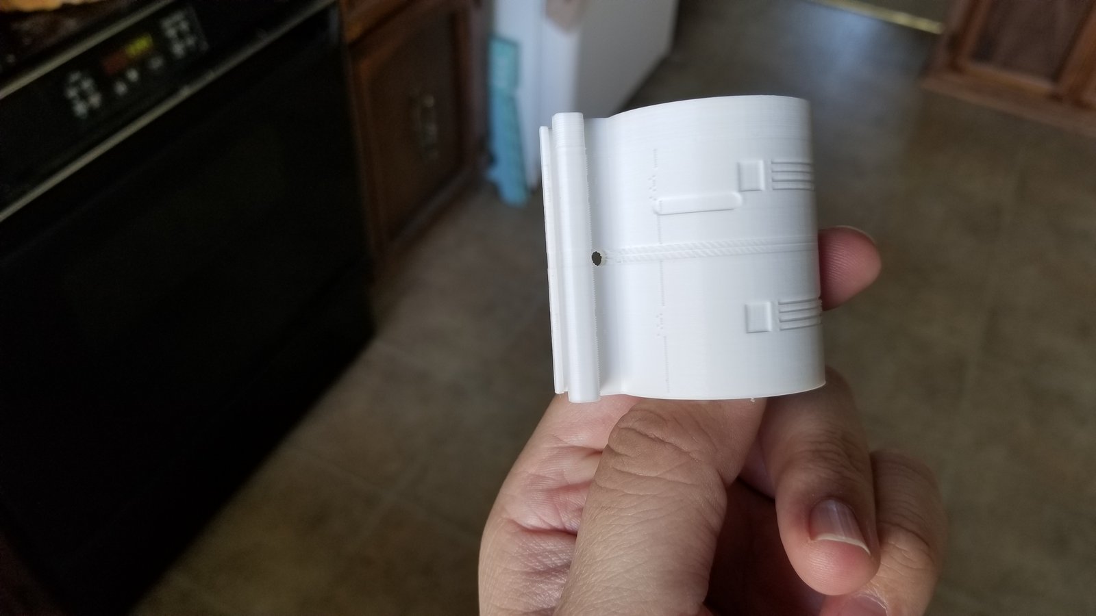

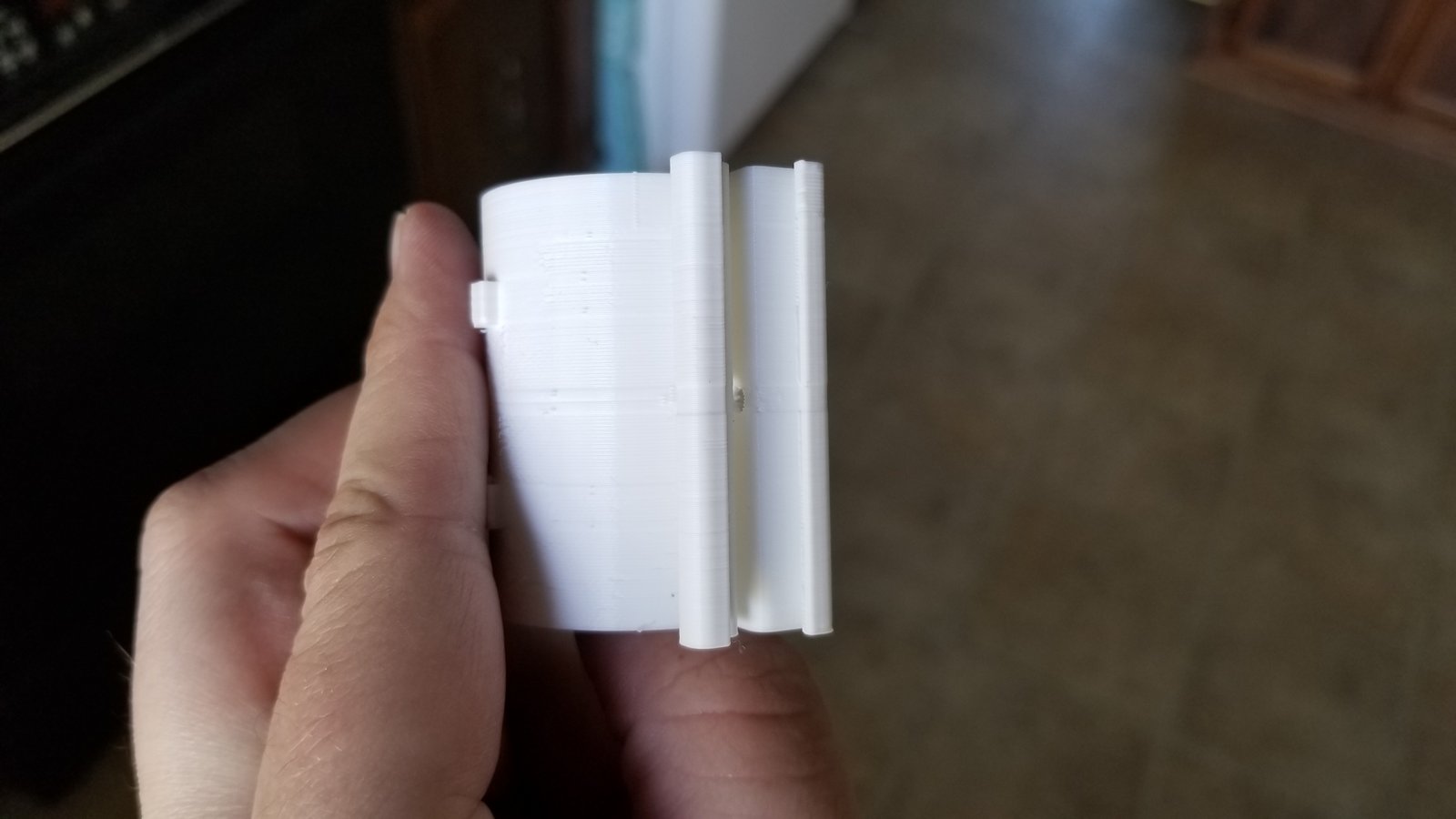

I’m printing some parts on my Flashforge Creator Pro 2016 and keep seeing this weird banding issue around any walls that have holes in them. It also seems to happen when the outline of an object changes, where detail either sticks out further or cuts inward. It only lasts from the bottom of the hole to the top, and stretches almost all the way around the part. See photos below. This is not the only part this happens on - any with a change in outline with respect to Z axis result in this defect.

I only have quality problems around certain details - it’s actually predictable where the banding will occur (anywhere there is a hole or recessed area in the outline). The rest of the print is very good looking, with the exception of some very minor Z wobble. If I remove the holes from the model, the problem goes away (but then I don’t have the holes).

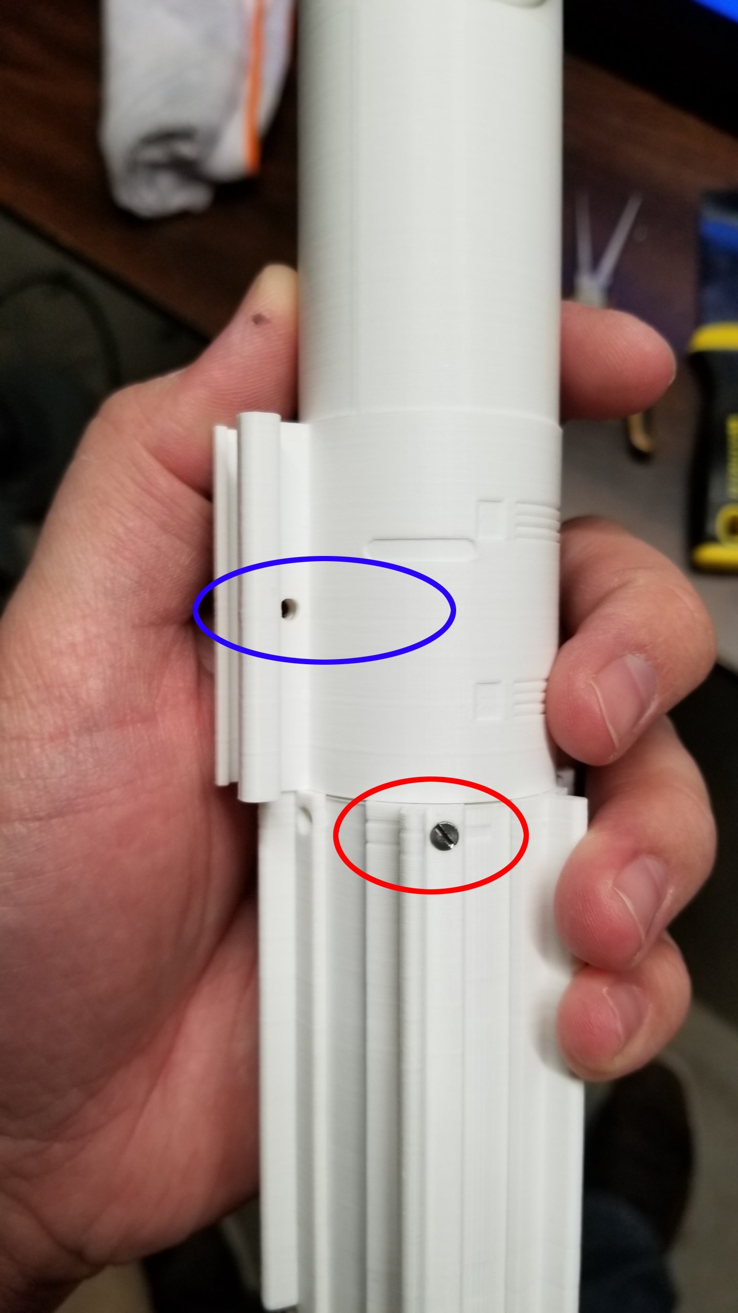

Attached is another example of the issue on a couple other parts. Notice the areas circled in red - the effect is present only at heights where there are holes in the wall. And some effect in the area in blue, though not as bad as on the part in previous posts. In fact, the other side of the blue area is raised instead of recessed, almost like a layer shift but only at the heights where the details are. Everything returns to normal once getting past the holes/recesses.
