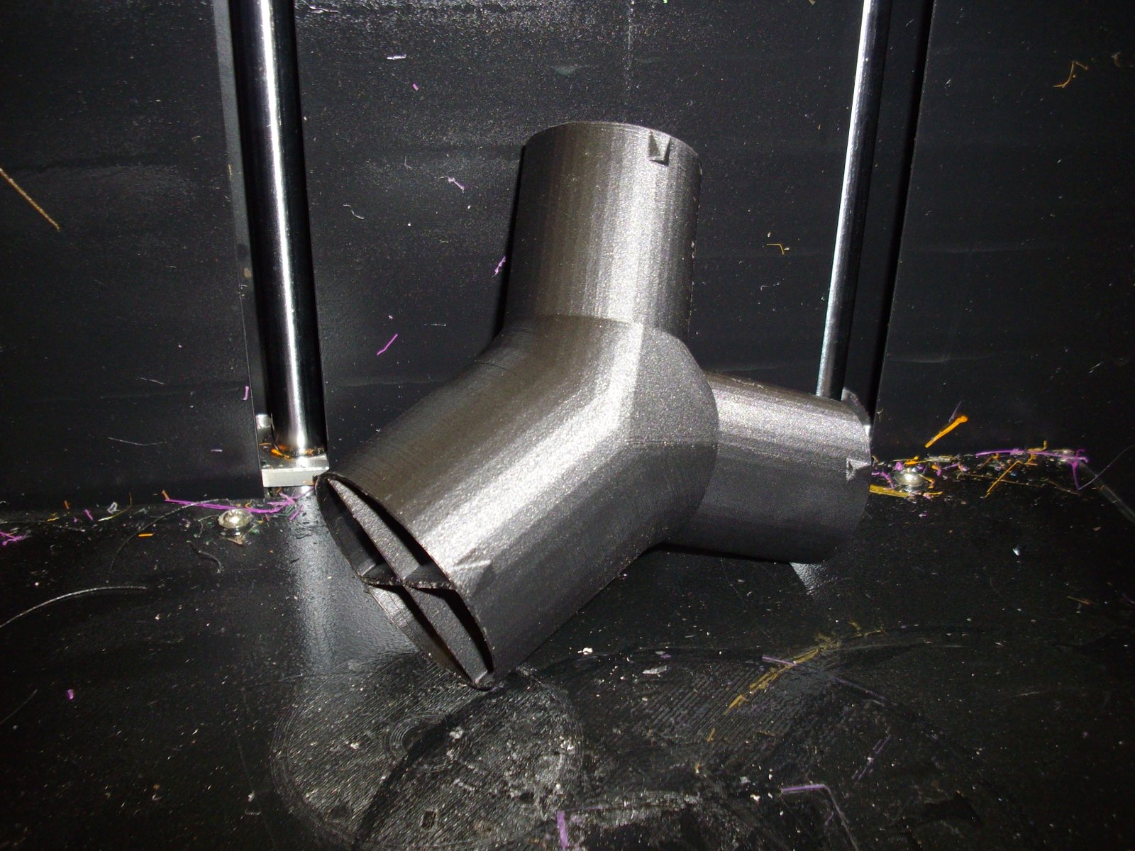

hi i use aurarum carbon fibre i used over 2 kgs and still no problem with the nozzle if you think that is not true just re size your nozzle and change it in your print program rick
Lush print rick… looks fantastic!.. XT-CF20 gets my vote but it isn’t PLA though… its a polyester blend/copolymer.
