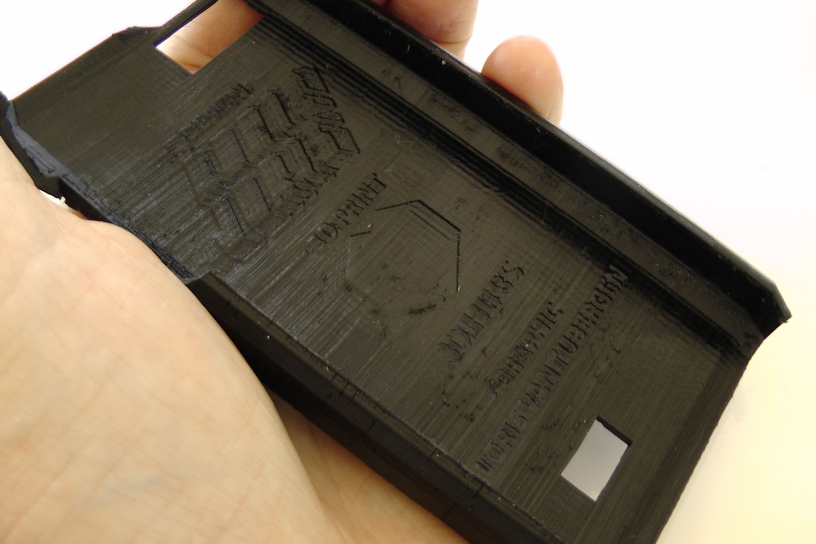

I have a returning issue with printing Fairphone cases. Near the end of the print, the overhang on the opening on the side is not printing well (see pic.) Anybody knows how to fix this?

Hi Filemon,
I thought of a few things which might help:
• print more slowly (at that specific point)
• print at max. resolution (then the lines are overlapping more whilst moving towards the outside)
• fan at 100%
• coolest temperature for material (but make sure the layers adhese enough)
Good luck!
my first thought, based on the overhang you mention and the slight sagging in the bridging, would be to try lowering the extruder temperature.
It might be useful to know:
which printer are you using?
what material are you printing in?
at what temperature?

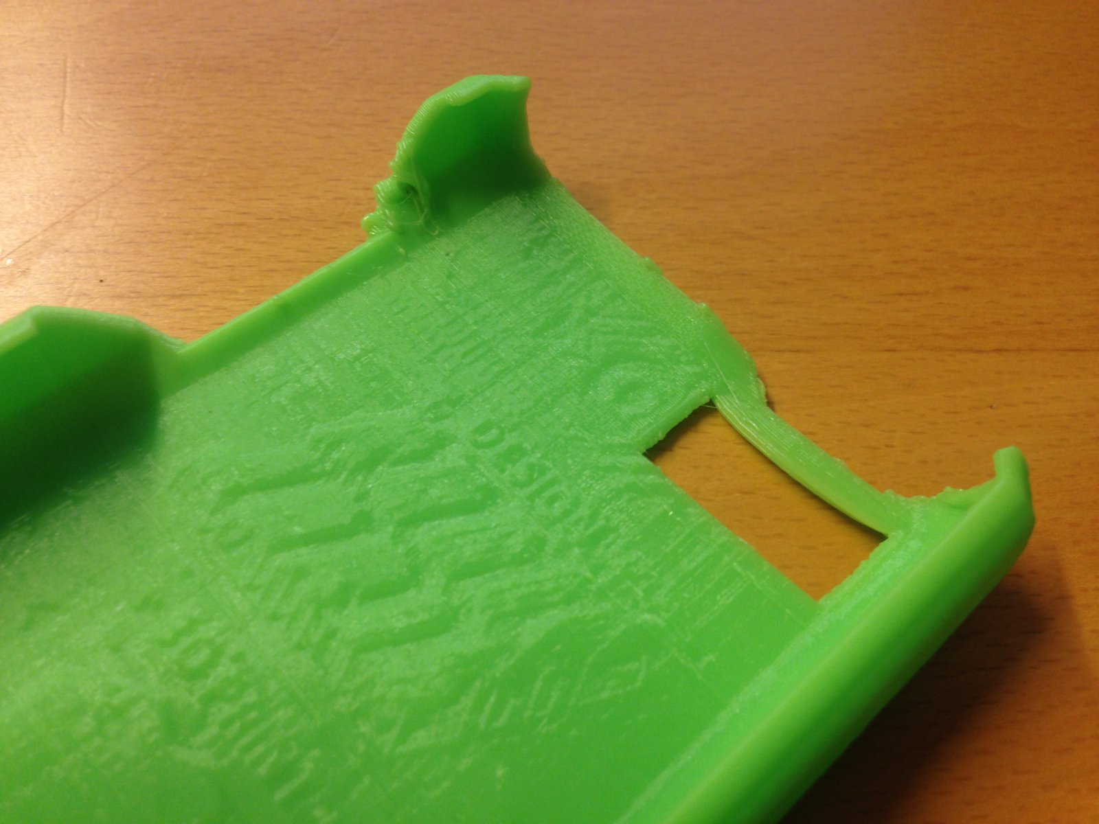

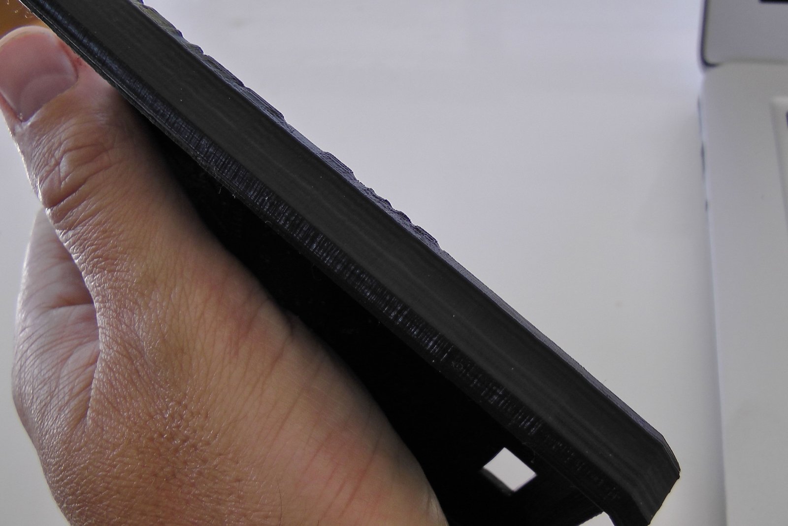

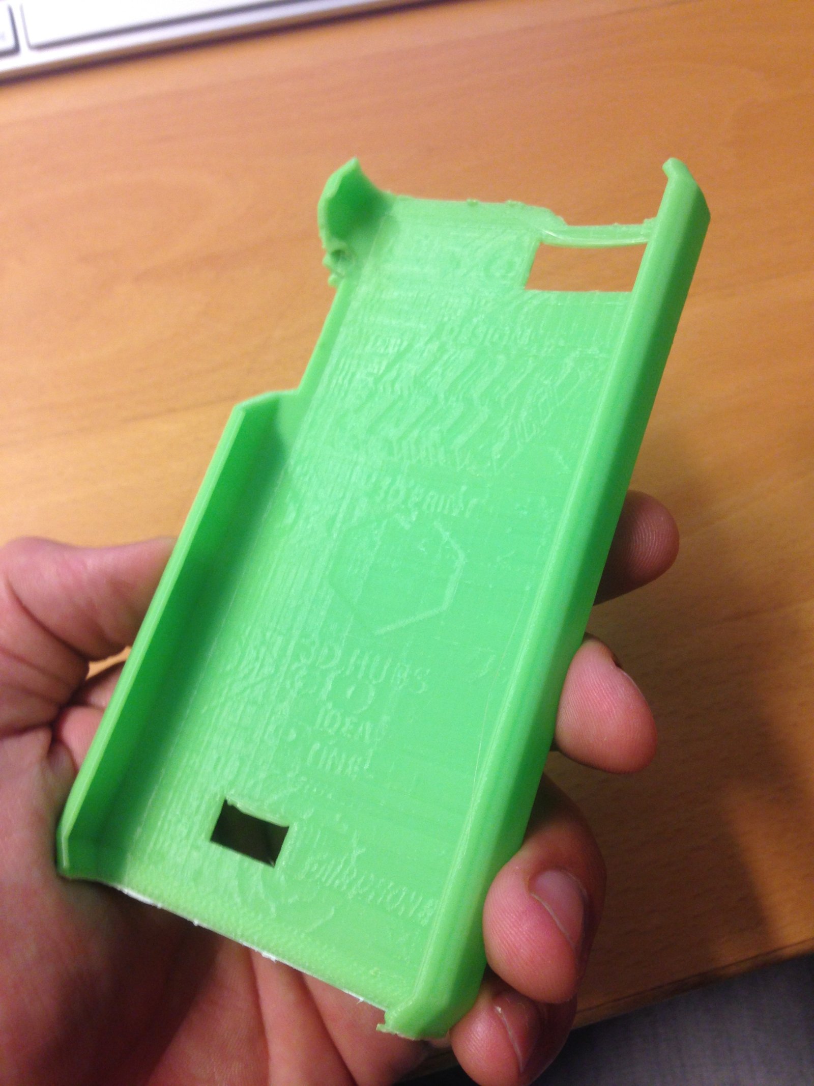

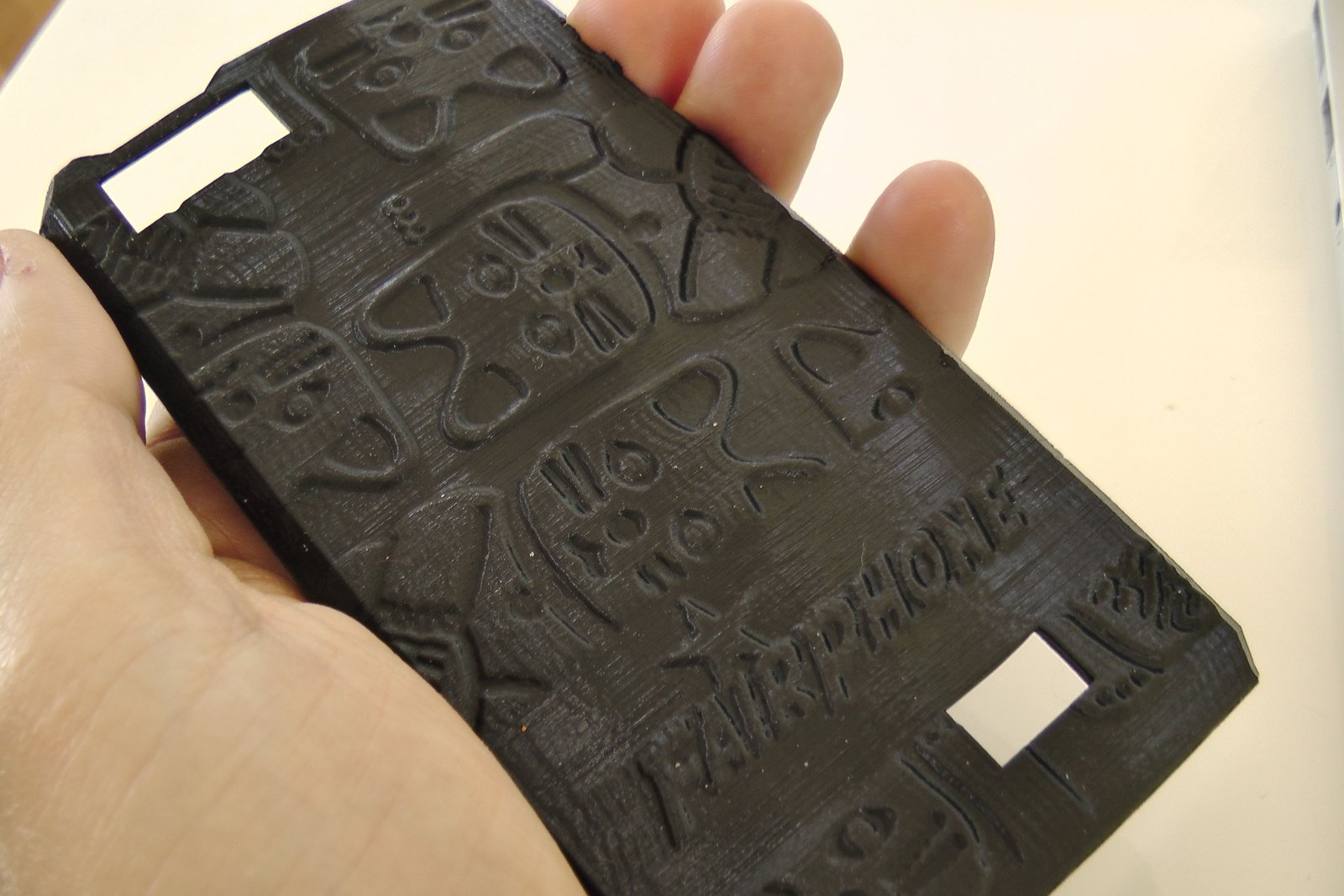

Here are some photos of the last case using those parameters.

Filemon,
which design is is - I found that one or two of them have some errors in the stl that cause a wierd z shift just on that point and it means that the printer pops up for a second, oozes and then pops down again and then resumes as normal. I contacted Joris but he cound not see a problem - so I fixed one in meshmixer (the lucky cats case - there was a tear there, and the Day 3 case I edited the Gcode where there was a jump in the z and removed it.)
So it depends on whcih design it is as everything else looks good.

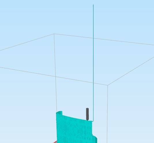

I don’t think that will fix it - here is a slice in Simplify3D and it shows the problem I was describing (but really bad) see there the line come off the phone case vertically - that is a HUGE z shift - so it gets to that point, then lifts off the phone, then comes back down and carrys on but you get a large strig of plastic.
If you are happy editing gcode (a good time to start :slight_smile: then slice the case - save to gcode and open the code in notepad and you will suddenly see a Z that is way out at about line 151563
Edit the z so that there is no change and save the gcode back as gcode and you are good to go :slight_smile:
