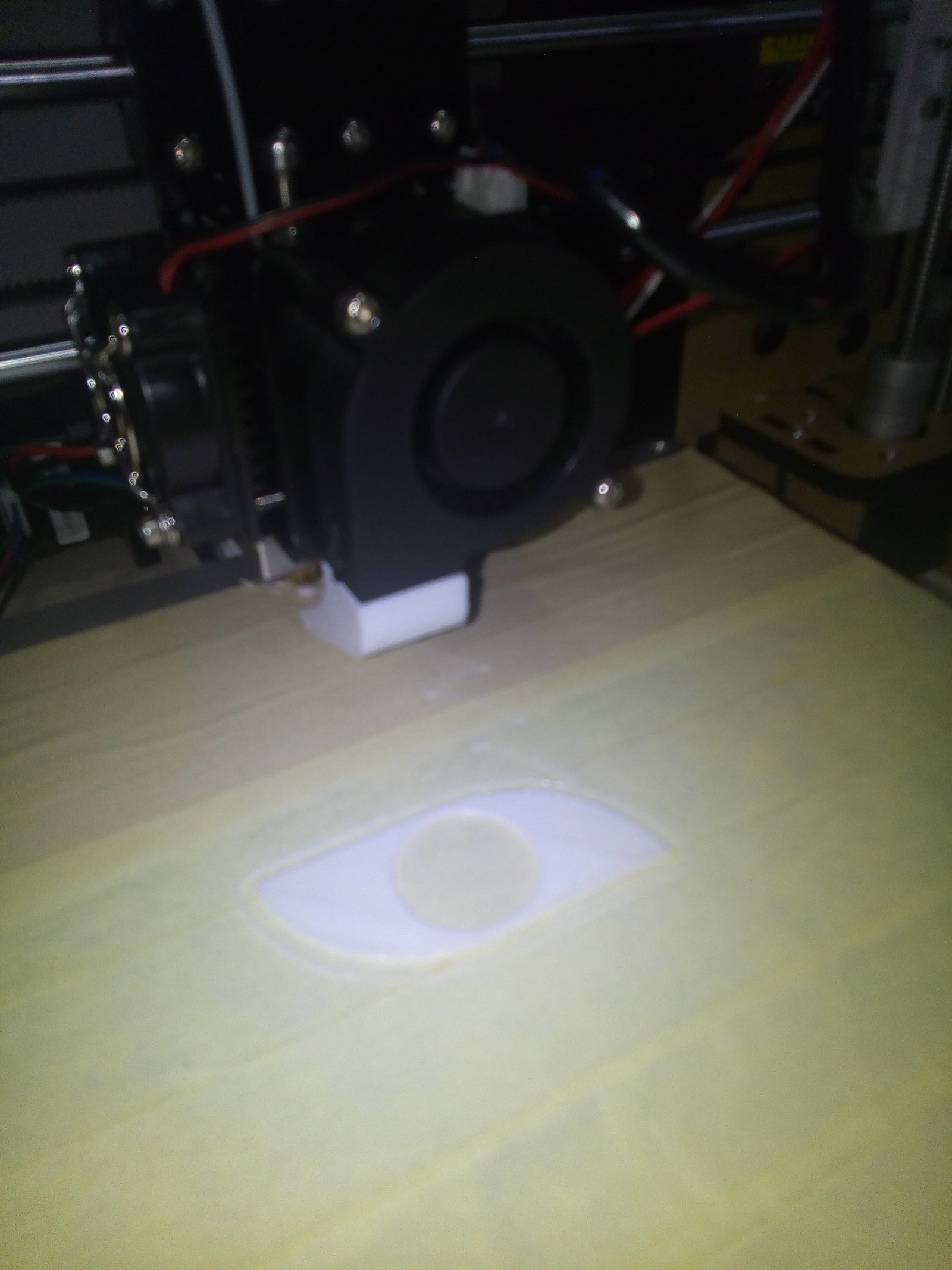

I recently purchased and assembled a ANET A8 Prusa i3 3D printer. When doing a print everything goes fine and well for the first few minutes, then all of a sudden the extruder starts zig-zagging off the print zone and continues to try and print off the print bed.
Any suggestions on how to fix this?

I got a reply from a user on Reddit that seems to be the exact problem i’m having, he suggested I check when the y endstop is being hit and sure enough the y endstop was getting a false positive of being triggered which the bed then proceeds to be pushed forward because it thinks it is at the end. He said he only way he solved this was to unfortunately replace the board :frowning:

Hi, please share your printer settings like speeds and acceleration(if changed). Does the printer make any unexpected noises like craking or skipping noises? Are the Y and X belts tightened? Check the motor grub screws (check if they are tight) and check if the idler pullys are freely moving.
It seems like your X and Y belts are too loose. This causes them to skip gear teeth sometimes, making your printer start printing at an X/Y offset from where it was before.
To test if this is the case, print slower (fast print speeds increase the belt jerk, which increases the chance your belt will skip teeth). If your print turns out OK, then this is your problem.
If this is your problem, then either cut your belt shorter or print some belt tensioners (slowly) to tighten your belts. Search thingiverse for “anet tensioner” to find X and Y tensioners.
Another option if this is your problem would be to move the endstop to the opposite side and change your firmware to reflect Y_MAX_ENDSTOP instead of Y_MIN.
