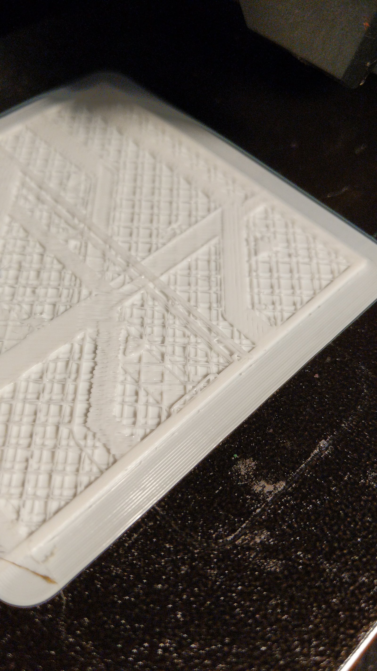

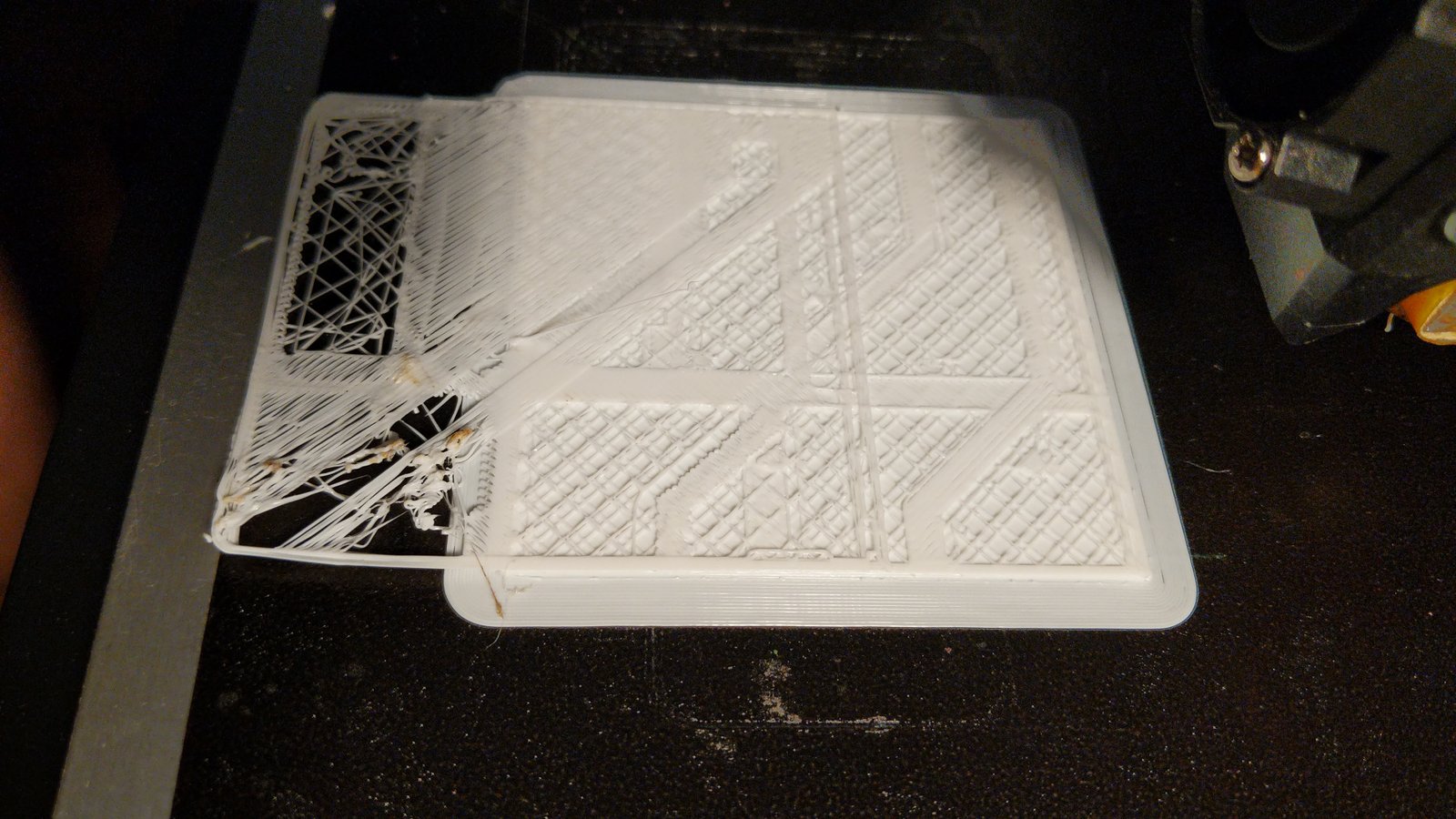

So I noticed my printer started parking layers offset of the previous layer. I tried using default settings from cura but it still doesn’t fix anything. The I have a select mini V2, and the original g code file (the cat) still prints fine, but I can’t print my own objects.
Check belts and set screws on pulleys to make sure there is no slippage. Watch it print and see if anything is causes the hot end to get caught and shift layers. Could also try printing slower if speed is too high.
