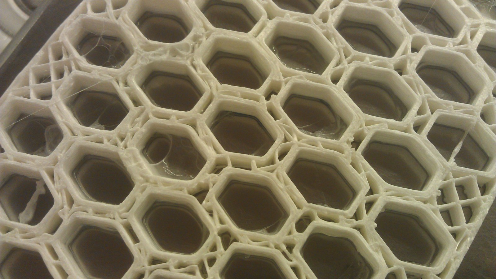

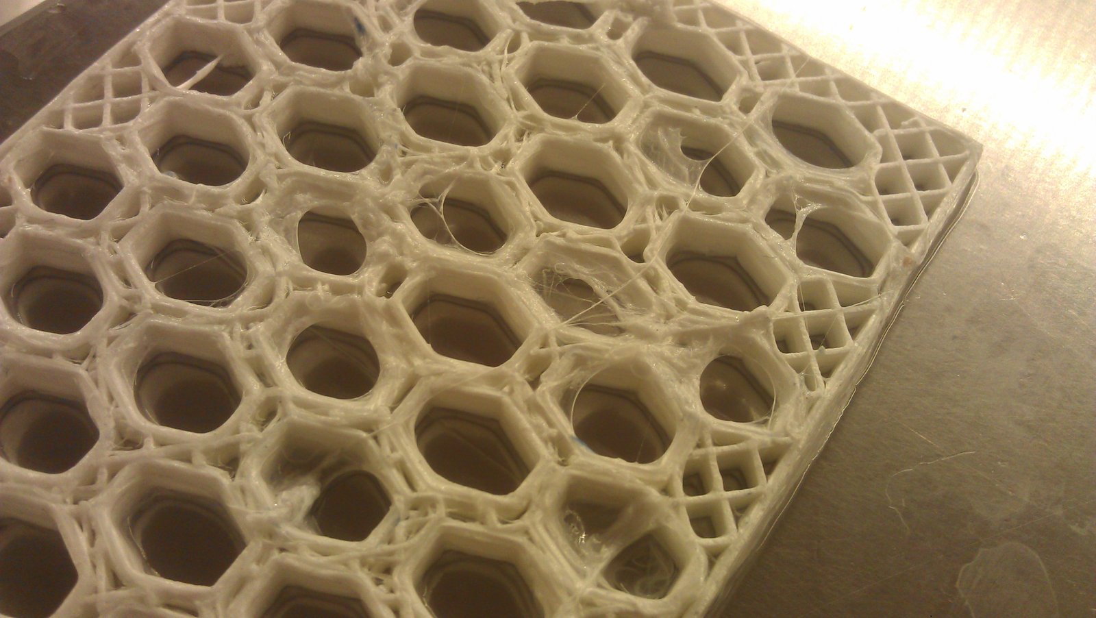

i bought the LAY-FOMM 40. Printing went fine but i tried twice the rincing and hade some problems. I rinced one print for a day and a second one for three days (pictures are from this one) with normal tap water. It was flexible and soaky as expected but as you can see in the pictures i think i didn’t get all the PVA out.
The other problem i had was that the prints started falling apart quite quickly (if i pinched it with my fingers for example), it was a big mess with all the sticky PVA… I just read the PDF and will retry with warm water and multiples cycles.
Printed with 220 / 40 °C on blue painter tape (Ultimaker 1).
There is at least one feedback i can give. If you throw it on the ceiling it will remain there :stuck_out_tongue:
Hello Obelix,
the layfomm 40 is the softest version (you wrote falling apart) , layfomm60 is more stiff,
both need some periods of fresh water for best rinsing results,
yes PVA sticks, it´s also used as glue,
best
Kai
