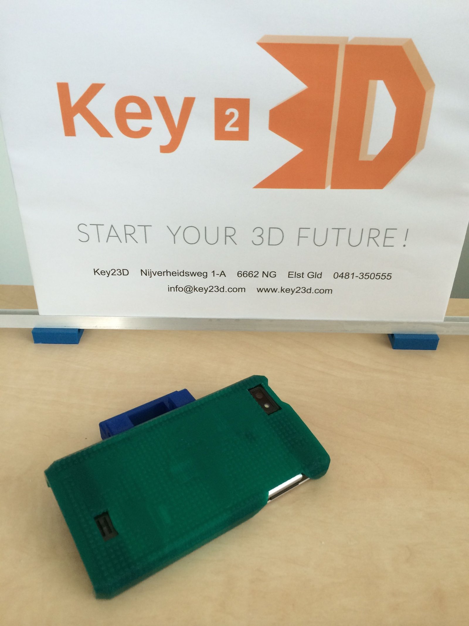

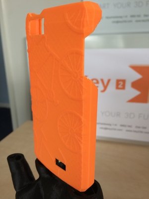

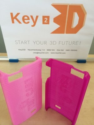

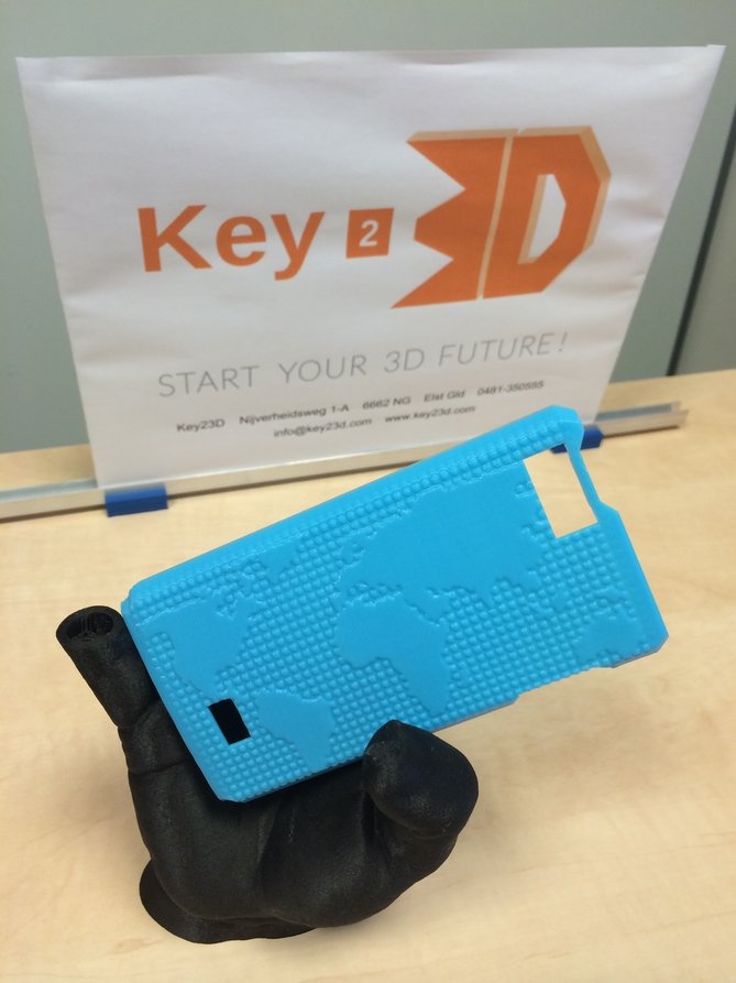

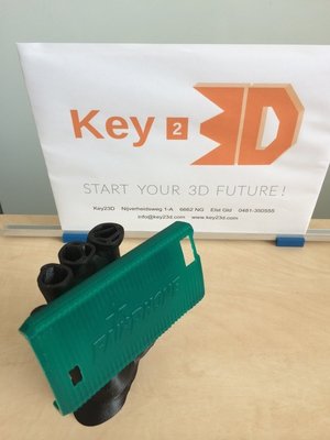

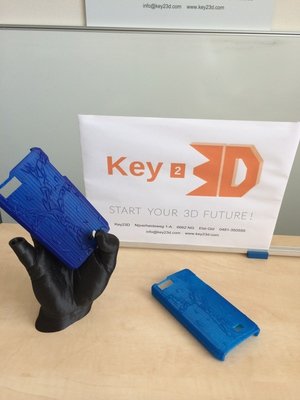

Hi guys,
if your interested, here are some examples:
http://key23d.com/wat\_wij\_voor\_je\_kunnen\_betekenen/printvoorbeelden/fairphone\_case
Kind regards, Guy Janssen
Key23D START YOUR 3D FUTURE !
IMG_2631.jpg IMG_2598.jpg IMG_2519.jpg IMG_2599.jpg IMG_2644.jpg IMG_2643.jpg
Nice Guy! On what printer are you printing?
Thanks!
On Ultimaker 2.
Kind regards, Guy

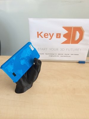

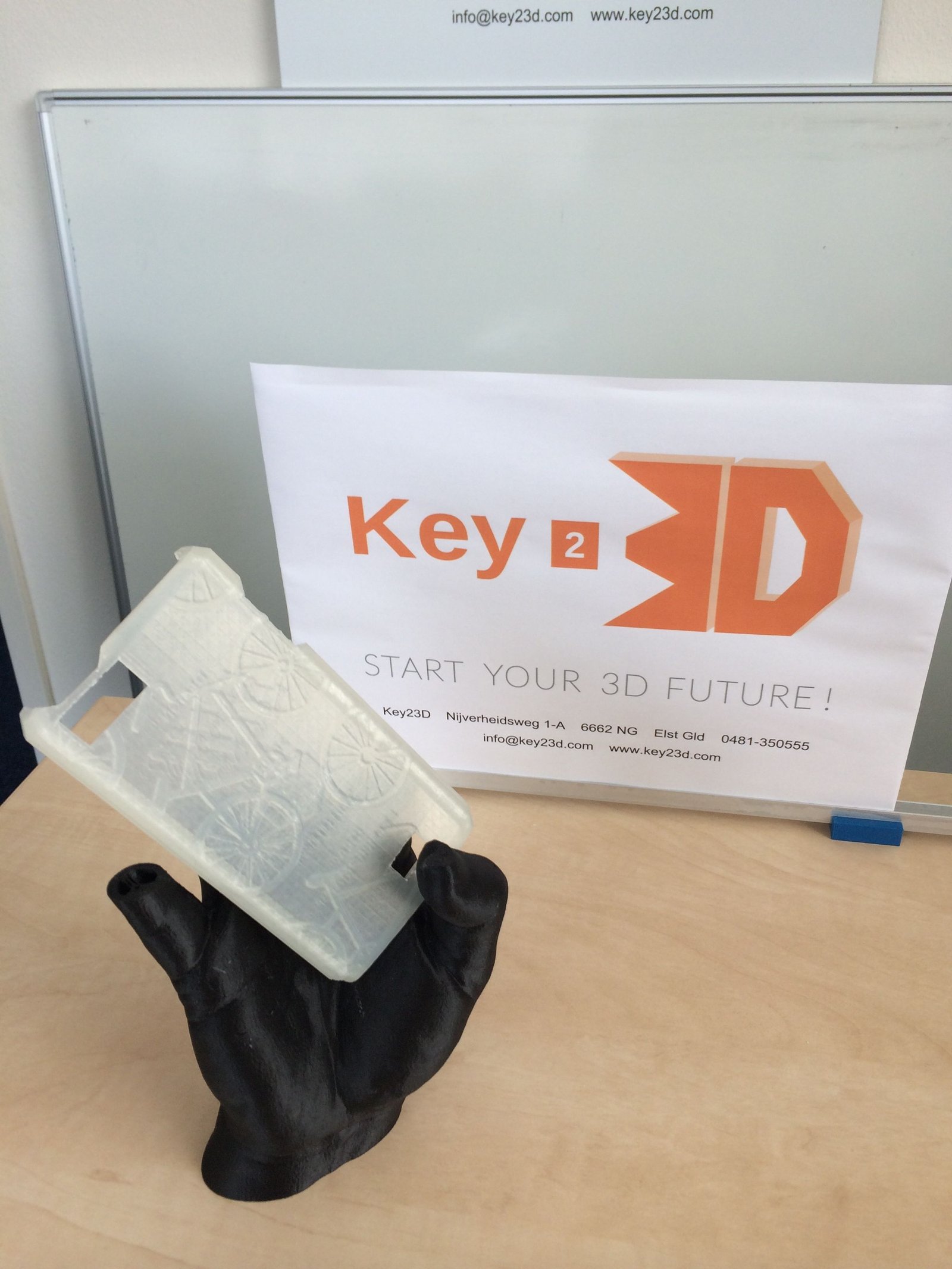

I just added a transparent one :wink: !
Great!

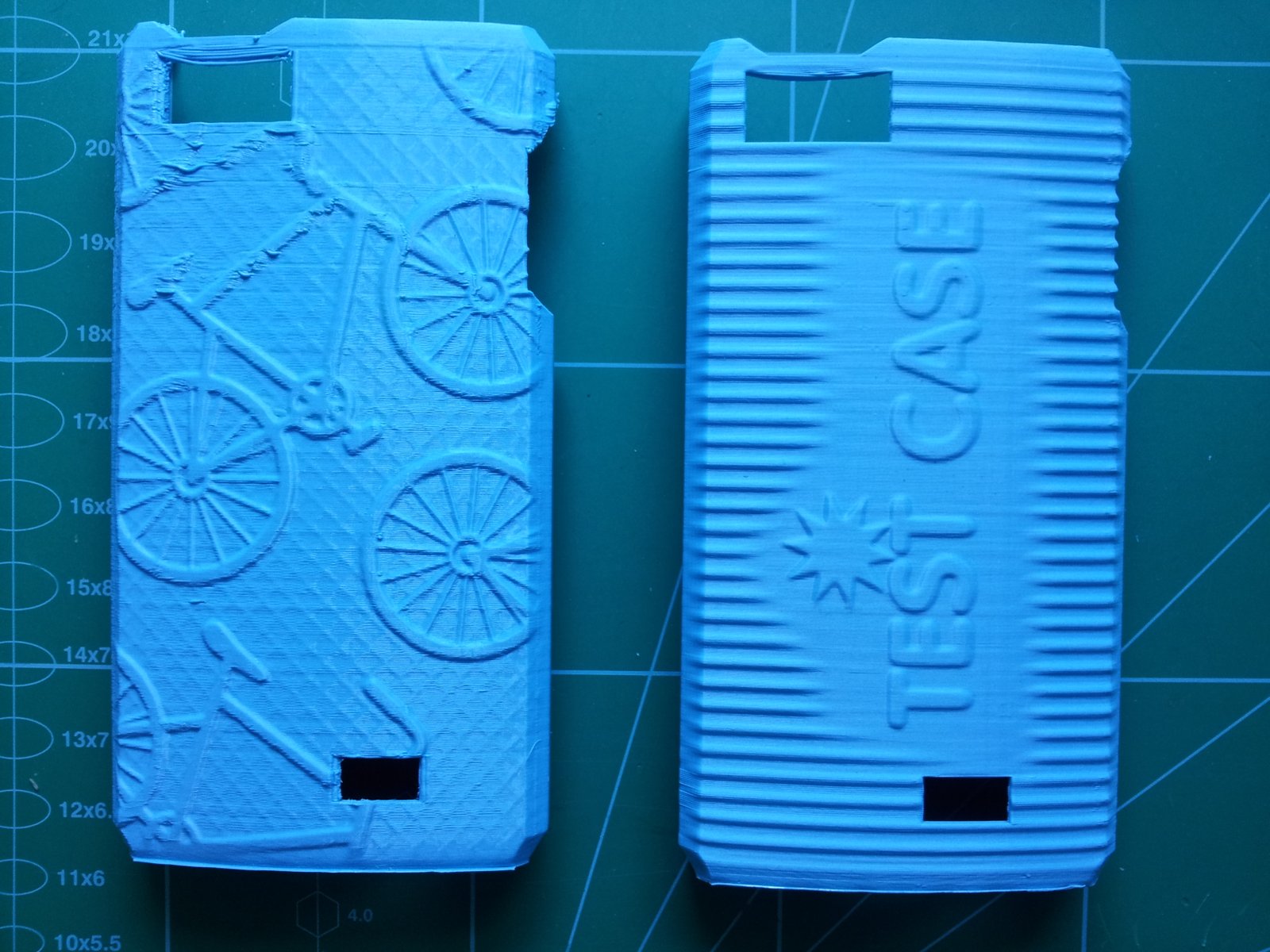

Hi Guy,
First of all, thank you so much for your quick answer.
The problem is with the printing result, I put the same preset that the fairphone test (same color, PLA ULTIMATE BLUE) but the result is different.
Maybe the problem is the model design because i have the feeling that the Fairphone Desighn Day 1 it´s more strait than fairphone test. I made 3 printing and i change some presets like: more quality layer (0,1mm); print speed more slowly (25mm/s); but the result it´s the same.
I let you two pictures to see the difference.
Do you know any solution?
Thank you again for all.
With kind regards,
Raphaël.
Maybe the problem is the model design because I have the feeling that Fairphone Design Day 1 it´s more strait than fairphone test. I made 3 printing and I change some presets like: more quality layer(0,10mm), print speed more slowly (25mm/s); but the result it´s the same!
I let you
Hi Raphaël,
could it be that you are extruding to much and that the temperature is al little to high?
You can print the last part by sinking the case into the platform in Cura so you can test the bad spot.
Good luck and keep me posted!
Kind regards, Guy

Hi Raphaël,
I mean that maybe the filament is thicker than the slicer thinks? E/g. when the filament is 3mm and the parameter says 2.85 mm there will be more filament extruded than you would want. In the UM2 this is in the material settings on the printer and for UM original it is at the bottom of the basic settings in Cura. In other slicers you can also change this parameter.
Kind regards, Guy
Hi Guy,
Ah okay, i understand what you say. In my case, the diameter parameter is the same as the filament so this cannot be but in any rate thank you for your explanation. When I receive the filament order i wil try to change some parameters and I will show you the result.
Thank you again for your support.
Good night!
Raphaël.

Hi Guy,
I finally print te fairphone case with a good result! You are the number one! haha
Thank you again for your support, i put you parameters and i change some preset and now the result is much better.
Thank you for all.
With kind regards,
Raphaël.
