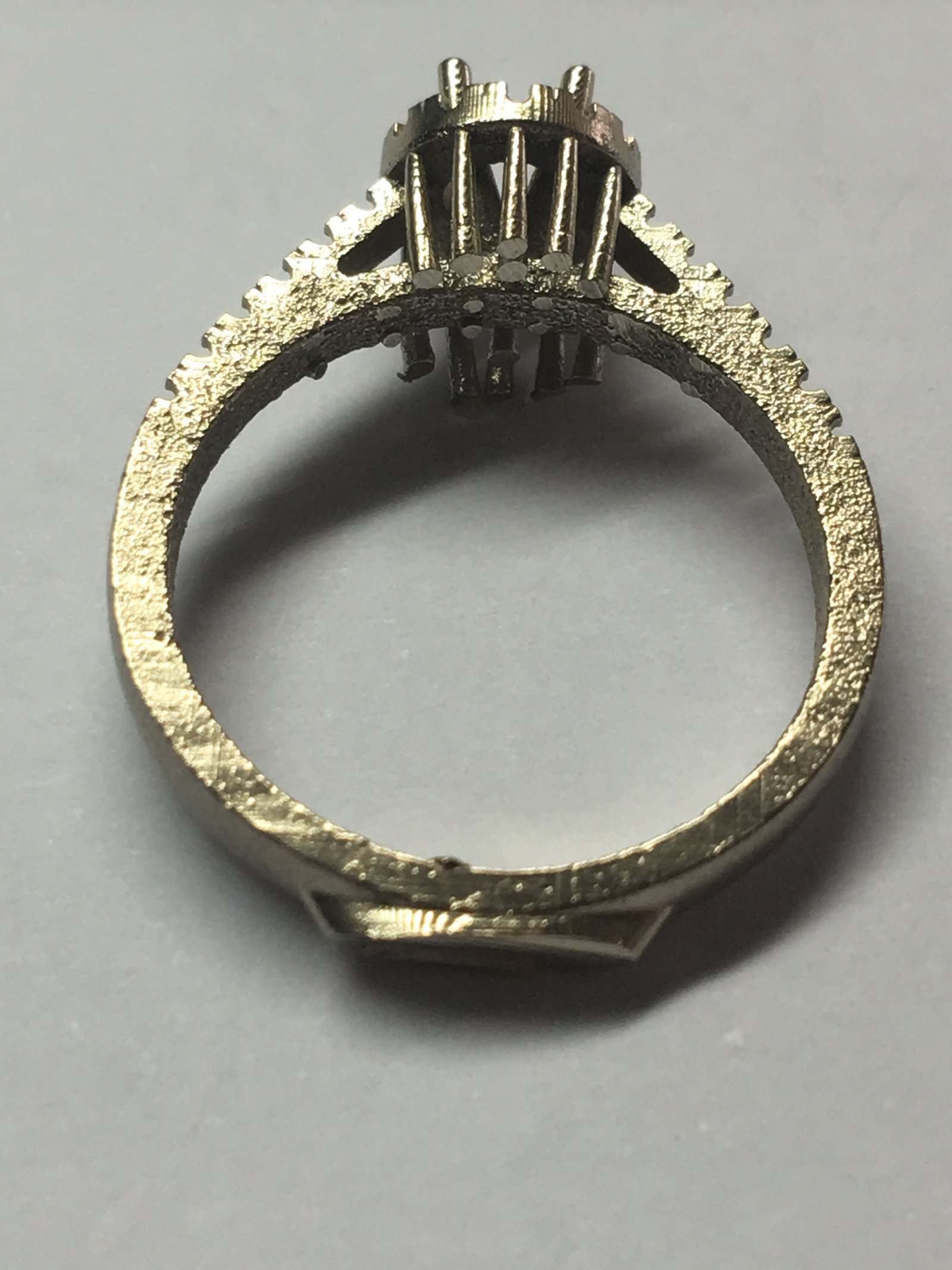

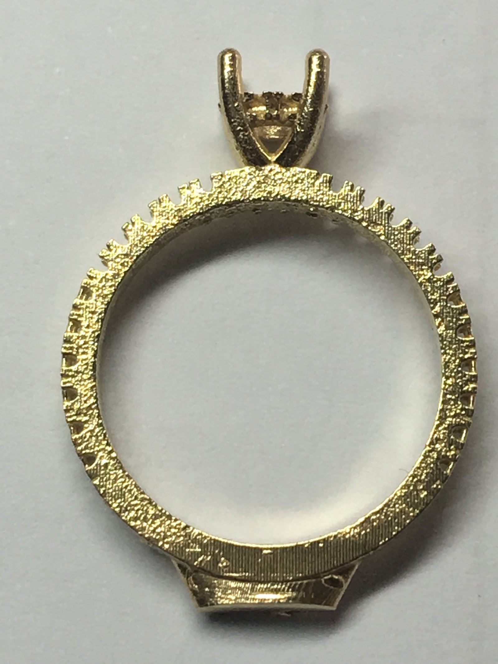

I am using an envisiontec perfactory micro 3d printer with epic resin.
I cure my models in otoflash post curing light unit and i have good result in casting but now oto flash is broken. I sent it back to envisiontec and waiting to be fixed.
I will attach some rings that i cure them in uv lamps nail dryer but the result was not good at all.
Does anyone use epic resin with different cure solution?
Thanks

Hello Greg,
I appreciate your help. Does the new led post curing unit has a good results? How long will take to cure the resin models(for epic resin)?
Otoflash post curing light source is between 300-700nm with 200w but led post curing unit is 405nm with just 54w
Do you have any other suggestion for other castable resin with much better result in casting? Is there a resin doesn’t need to be cure?
Currently i am in Cyprus,Limassol
Do you base in Athens?
Thanks
Andros

Before my otoflash brake i was doing the following procedure for curing
1)clean the model in propanol in ultrasonic
2)1 x 1000 flashes
3)cut the models
4)3 x 3000 (3 minutes to cool down)
5)5 x 5000 (5 minutes to cool down)
7)7 x 7000 (7 minutes to cool down)
8)9 x 9000 (9 minutes to cool down)
Thanks

Hello Greg,
You absolutely right for the led explanation.
All those days i was using epic resin with pic100 instructions.
I received the cookbook of epic from envisiontec and the recommended curing process is just 10000 (5000x2).
