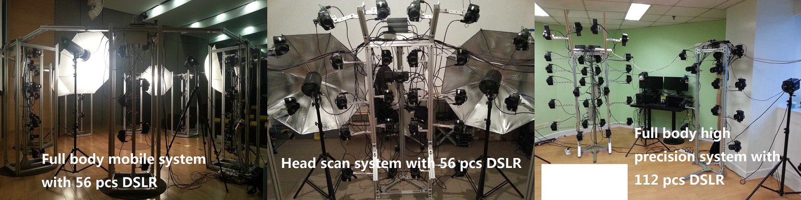

Hello Rbirkan,
We are using DSLR array for full body 3D capture. You can reference our website http://www.youcan3d.com
You can also refer to below website for great result of DSLR array at UK: http://ten24.info
The software we are using is photoscan from Agisoft. http://www.agisoft.com
What is the requirement of your 3D scan? Do you need texture with color?
The DSLR array is the best way to do full body scan by now, it can get highest resolution but it cost a lot.
If you can accept the medium resolution you can try 3~4 Kinect from Microsoft with one rotate-stand and using KSCAN software to get medium resolution result.
And there is one mirror can scan your body also (https://naked.fit/) it use 3pcs RealSense from Intel.
I think the result will similar to KSCAN with 3 pcs Kinect from Mircosoft.
By using only one hand hold scanner to scan full body is not the right way by my experience.
Hand hold structure scanner is better for scan things not for human.
Wish you a great day.

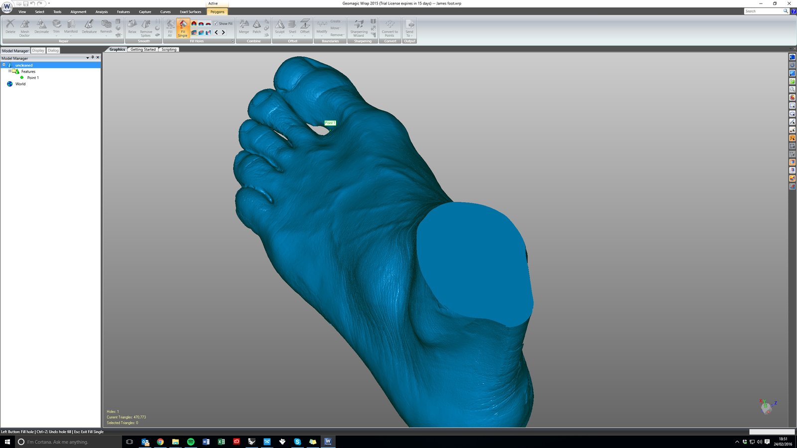

Hi Rebekah,
I have to say that Xin Zhao’s comment is very useful. We explored photogrammetry using DSLR cameras and Agisoft - but for us it was going a bit too far away from our core service offering. But right now, if you are serious about capturing full body data, Xin’s method is probably the best.
We are capturing parts of the body (not full body) as well as other medium sized inanimate objects. We chose the FARO Design ScanArm, which has exceptional scan resolution, but requires the item scanned to be extremely still. See attached data we have from scanning a foot.
Hope that helps

I looked at Xin Zhao’s website and that is exactly what we are interested in doing! The scans of the dancers are amazing.
Xin Zhao - Do you have any information on how to build that set-up in English? Do you sell pre-built scanners?

Hello Rebekah,
We are a company focus on 3D photo services and related equipment especially in 3d photos for human body.
If you are interest in purchasing the whole system, parts of them or want to get some consulting about how to build it we can talk in private.
We can provide the turn-key solution with on-site services. Of course it can be in English.
