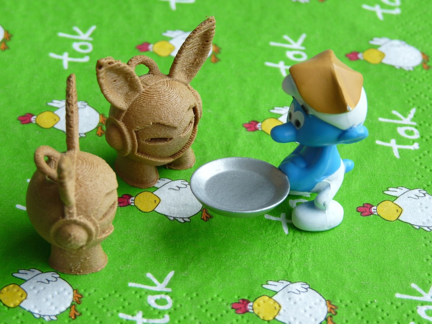

First try with Polywood from Polymakr, standard quality, layer height 0,3. Slicer Cura. Printer CelRobox.
Nice, what temperature does the woodfill print at?
Haha really nice picture! Good first try btw.
Slightly higher than PLA. Polymakr recommends 200-220°C (1.75mm filament). I used 210°C and reduced the print speed.
This is insanely cute! Does it actually feel like wood?! I’ve tried making one like that , but it didn’t turn out that well!
It feels like PLA (because in fact it is a kind of foamed plastic), there is no wood powder added.
