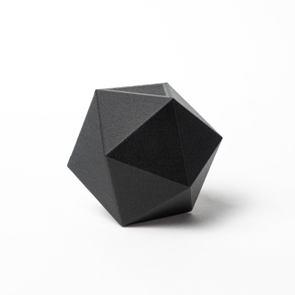

I’m actually thinking of just using something like protopasta HTPLA with properties similar to ABS while being as simple as PLA. Has anyone here tried it?
​If this is the stuff you’re thinking about, it should be alright. I usually never go above 80 degrees C on our local Makerspaces Makergear M2.
