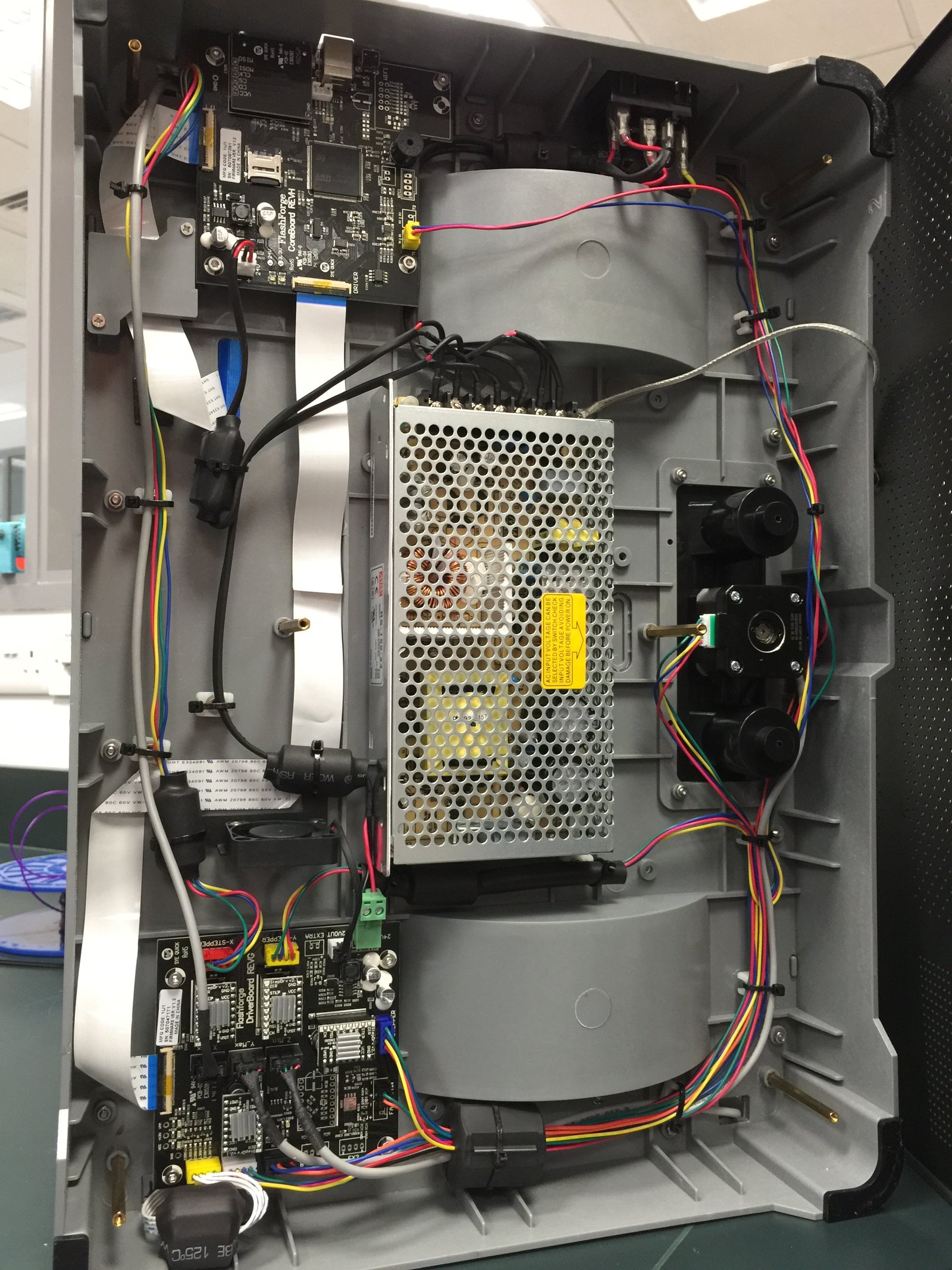

I have no issue at all with sd card print. There are two sd card for this printer. One on board and another card reader. So far use few time only using USB and sd card still the best.
