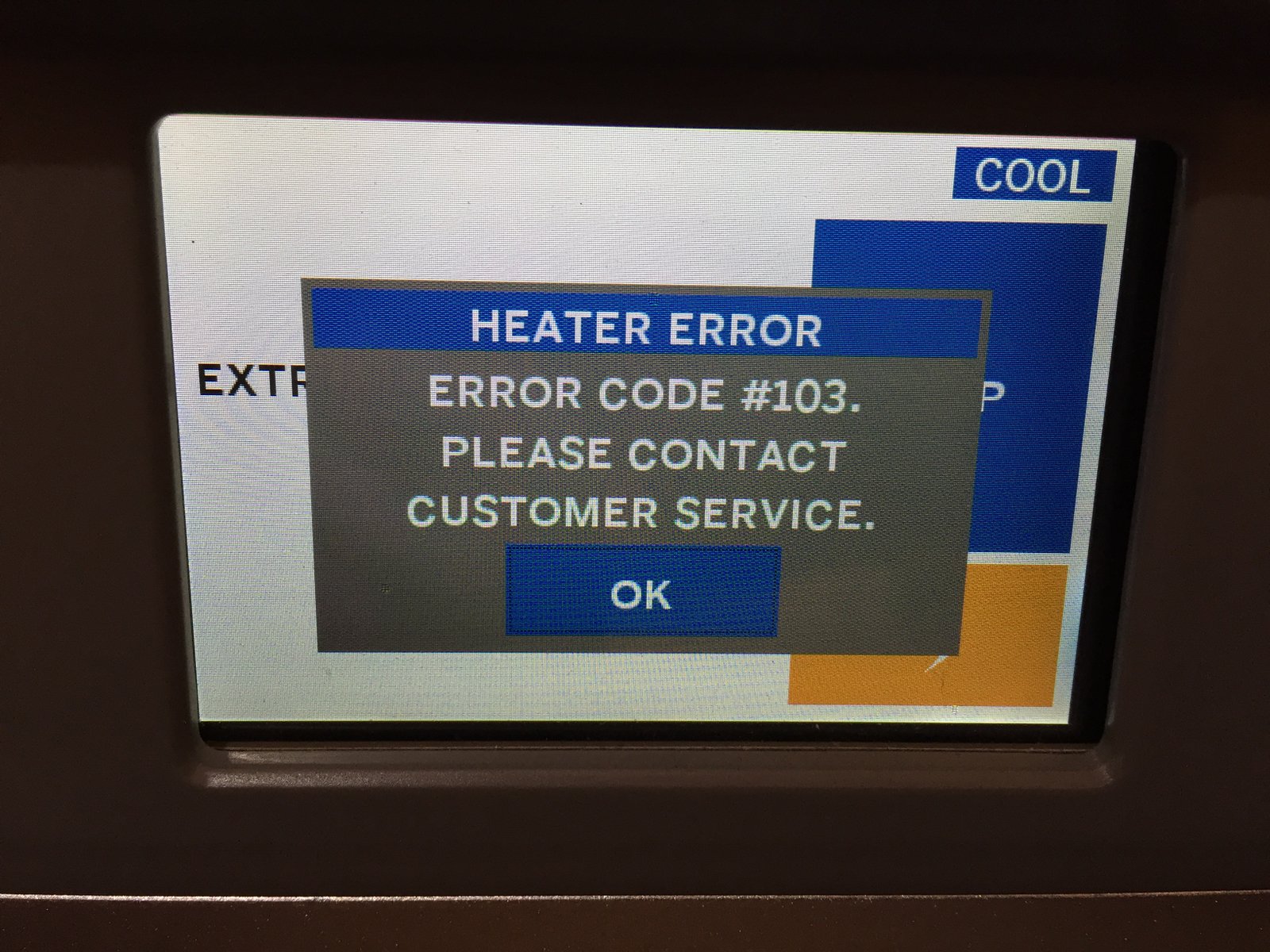

I need some help! I already ask for Dremel Support for help but they sent me instructions for clogged filament and the problem is ERROR CODE #103 - HEATER ERROR. I can’t unload filament or do anything because the extruder is not heating.
Your thermistor has gone bad. It could likely burn up your printer.

have you solved your problem? , i have the same issue .
dremel support send me a new hot end assembly but didnt solved the problem.
Hi there!
Sadly, no I haven’t fix ti…yet. On the bright side we did solve what it turned to be, (with some help of engineer friend) the main motherboard had some serious damage in some pins… so basically I need to buy a new one. (also he helped me to find that Flashforge has an exact model called Dreamer that I cloud use the same motherboard.
