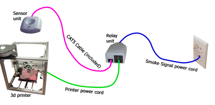

Great question! CF PLA and Nylon composites are available and I’ve considering using them in model rockets, aircraft & car components and scaled construction models. Words of caution: Use adequate ventilation. CF, whether alone or in composites is hazardous. Long term health effects in consumer 3d printing aren’t well studied yet. 2 areas of concern: dust inhalation and electrical contact. CF shreds mixed with PLA still contain production chemicals which may cause lung damage. CF is also conductive and can coat electronics causing shorts. This means your printer could fail to operate correctly and become a fire hazard. My suggestion is ALWAYS use a 99.97%+ HEPA air filtration system in the space where you print. Also consider mounting an automatic fire extinguisher directly over your systems if you leave them running unattended for any period of time. Here’s some links to help:
