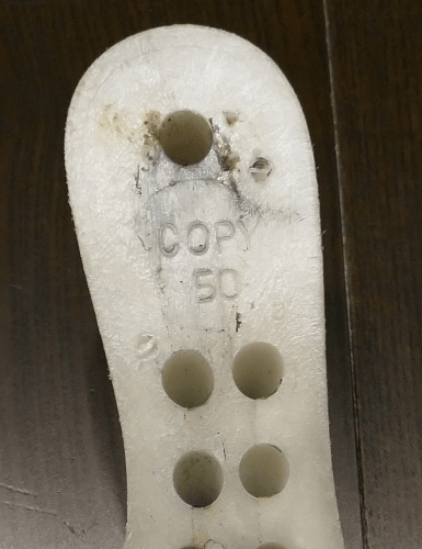

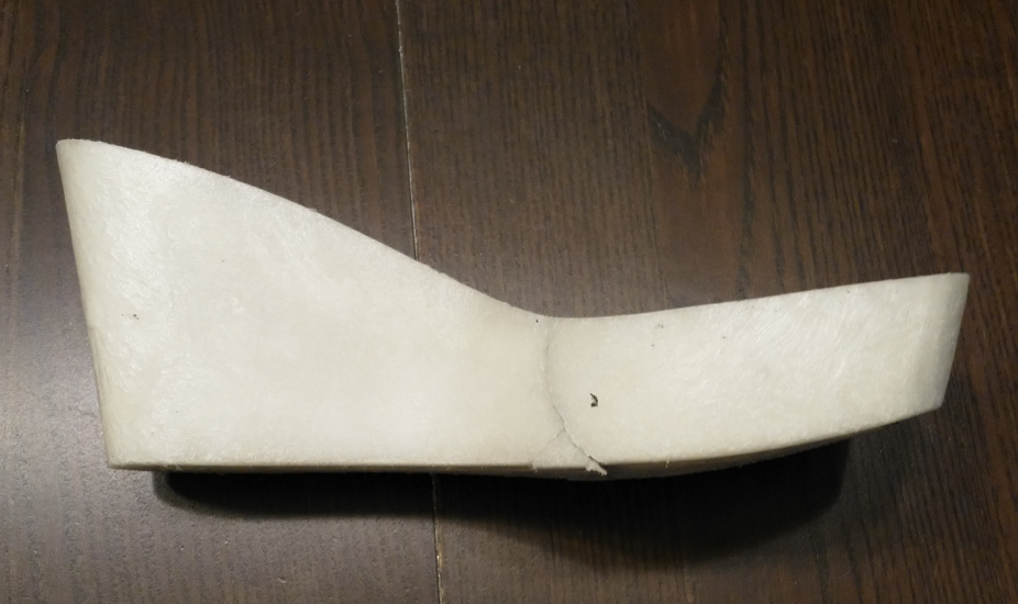

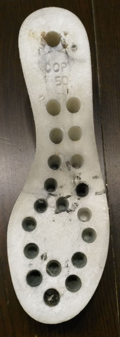

the enclosed images show the inner part of a left shoe. I was asked by a shoemaker, whether I’m able to design/produce the right shoe. The original part is completely broken, but the customer of the shoemaker wants him to try everything to repair his shoes. He came to me and now it’s also my problem ;-).
So my questions are
  • does someone know, whether it is possible to 3d scan the left shoe and somehow mirror it with any tool and print it out?
  • what kind of material would you recommend? The woman wearing the shoes has about 60 kilograms (~132 pounds).
Thanks for any advice.
Alex

This is of course also an option, but it’s really difficult because the shoes need to be exactly the, just mirrored. Imagine if there is just the slightest difference in the height, length or width l. You would recognize that immediately when wearing the shoes. On the other hand, this may also happen when scanning and mirroring the left shoe.
You are right, this is definitely a project to show what’s possible with 3d printing. This is the reason why I want be sure to do it the right way. It has to fit perfectly. I already did some test with photogrammetry (2d -> 3d), but unfortunately it didn’t work well. Not sure whether it’s the model, bad lighting or the camera. It worked quite well for most of the model, but it didn’t get the front side of the shoe, because it curved upwards and it seems that the shadow under this part drives the software nuts. I decided now to borrow an Xbox 360 kinect and give it a try. Maybe this works better. If not, I will have to design it with Fusion 360. Thanks for the advices.
