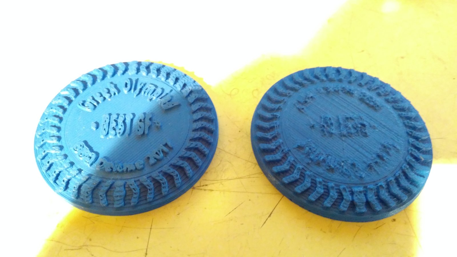

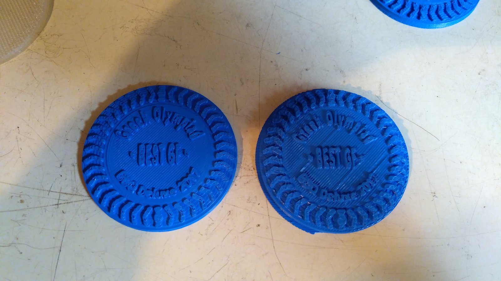

I’ve had my Da Vinci printer for over 2 years now and was pretty happy with the print quality of the xyzware slicer. But because I’m planning to mod the printer with an E3D V6 extruder, I thought it was time to flash the printer with repetier and “unlock the hidden potential” of the printer. I made a testprint before the flash using the standard xyzware slicer, and one after the flash using repetier with CuraEngine slicer. I was surprised to see the print quality with the old standard firmware is way better than what I get now… Surface finish is really crappy and printed text is unreadable. (see attachment=> left xyzware, right CuraEngine)

Did a lot of testing, and I’m getting closer to the right settings. I got Slic3r to work and print quality is almost what it was before the flashing, but surface finish is still somewhat messy…
I’m now at the point that I don’t know what to change to improve print quality. Help would be appreciated :slight_smile:

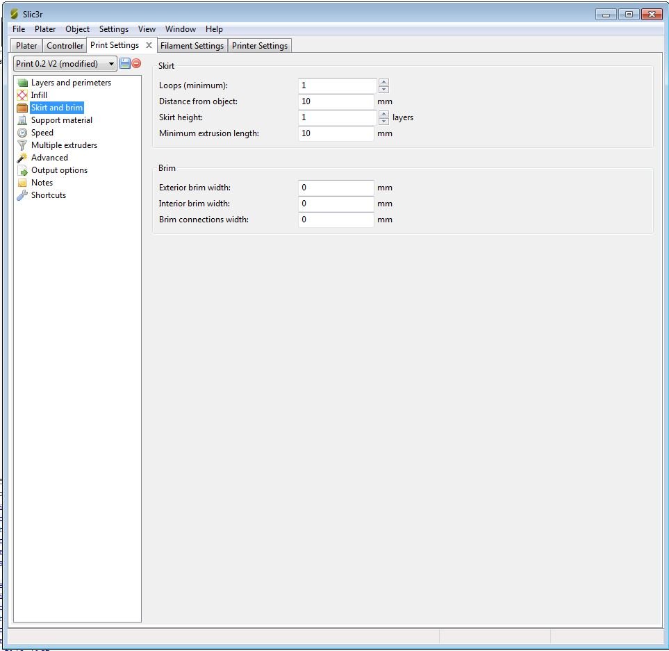

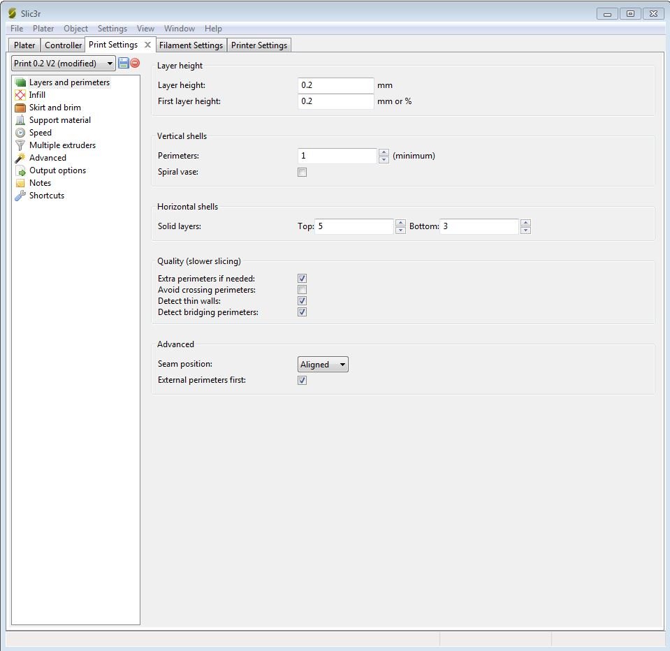

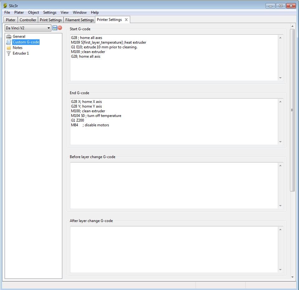

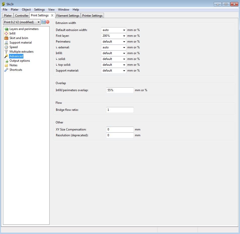

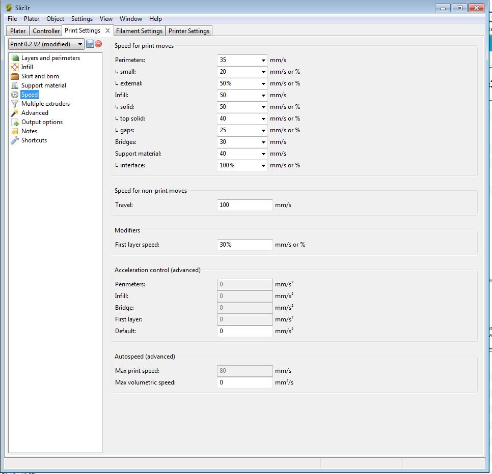

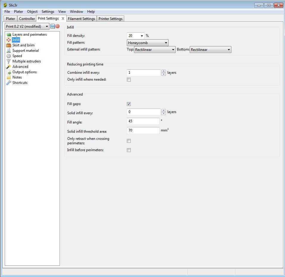

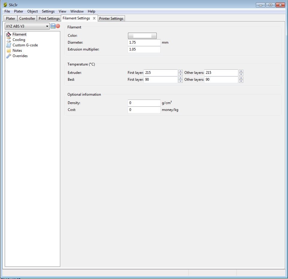

In attachment my current print quality and Slic3r settings.
215? try 230
Here are some thoughts kind of in an order.
Temps at 230 for ABS.
Make sure to measure the filament diameter over some distance and enter the average in the slicer.
Try extrusion multiplier at 1 for now. You can run some calibration tests to dial it in.
Start with rectilinear infill for now.
Uncheck “external perimeters first”
Set “gaps” speed to 5 or 10 or 0 for off but a low number.
Reduce infill/perimeter overlap to about 25% and see how that is.
I would set the extrusion width to a number rather than “auto” or “default” generally the nozzle size or 1.2 times the size so for a .4 nozzle use .4 or .42. I use .45 on one of mine with slic3r.
Try turning off “extra perimeters” and “detect thin wall” and see how that does. Seems the extra perimeter setting caused me an issue once.
