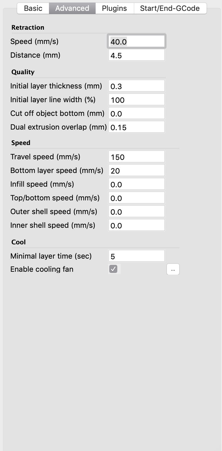

Hello, I am a student and I am new with 3D print, now I will use WASP2040 clay with Cura (MAC) for my study project but I have a problem with setup the basic speed, temperature and so on…So I would like to ask if anyone can help for the setup of a number for WASP 2040 clay. Thank you in advance.

Hello
Go to 3dwasp.com
There Is an area of the site where u can download file configuration for different kind of printing, I think also for LDM.
One thing: u don’t have to set any temperature, It Is a "cold’ technology :slight_smile:
@eulerO thank you very much, I worry about speed and cross support inside but forgot about the temperature. Thanks, I will try.
