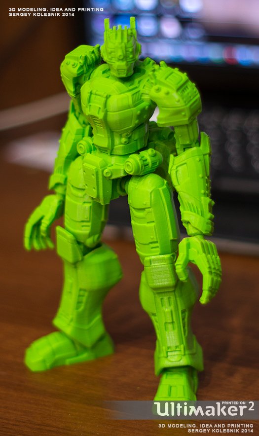

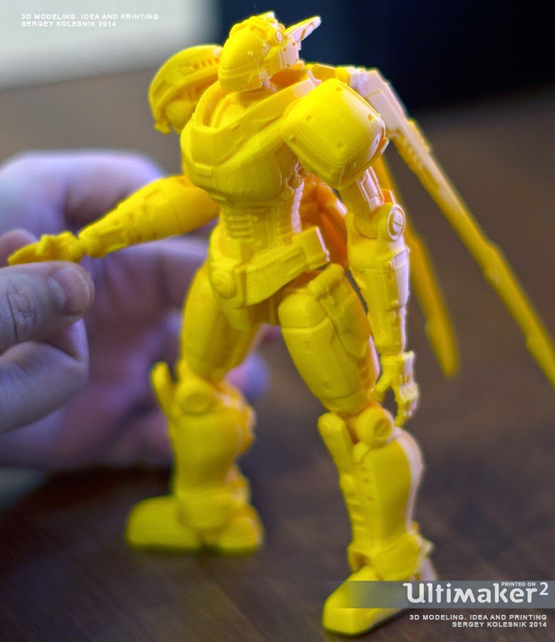

Ultimaker 2 the best the quality of its printing! accuracy. no competitors. printed layer was 20 microns
http://www.3ders.org/articles/20141222-russian-toy-designer-creates-complex-and-awesome-robot-toys-on-his-ultimaker-2-3d-printer.html

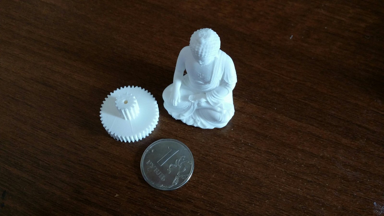

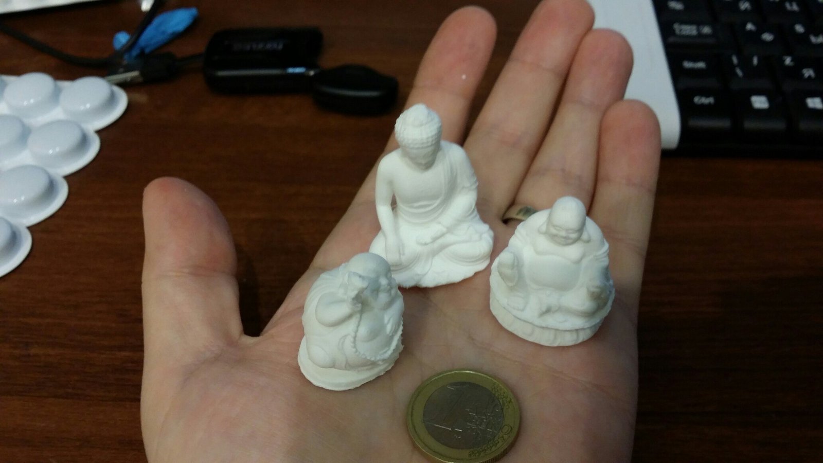

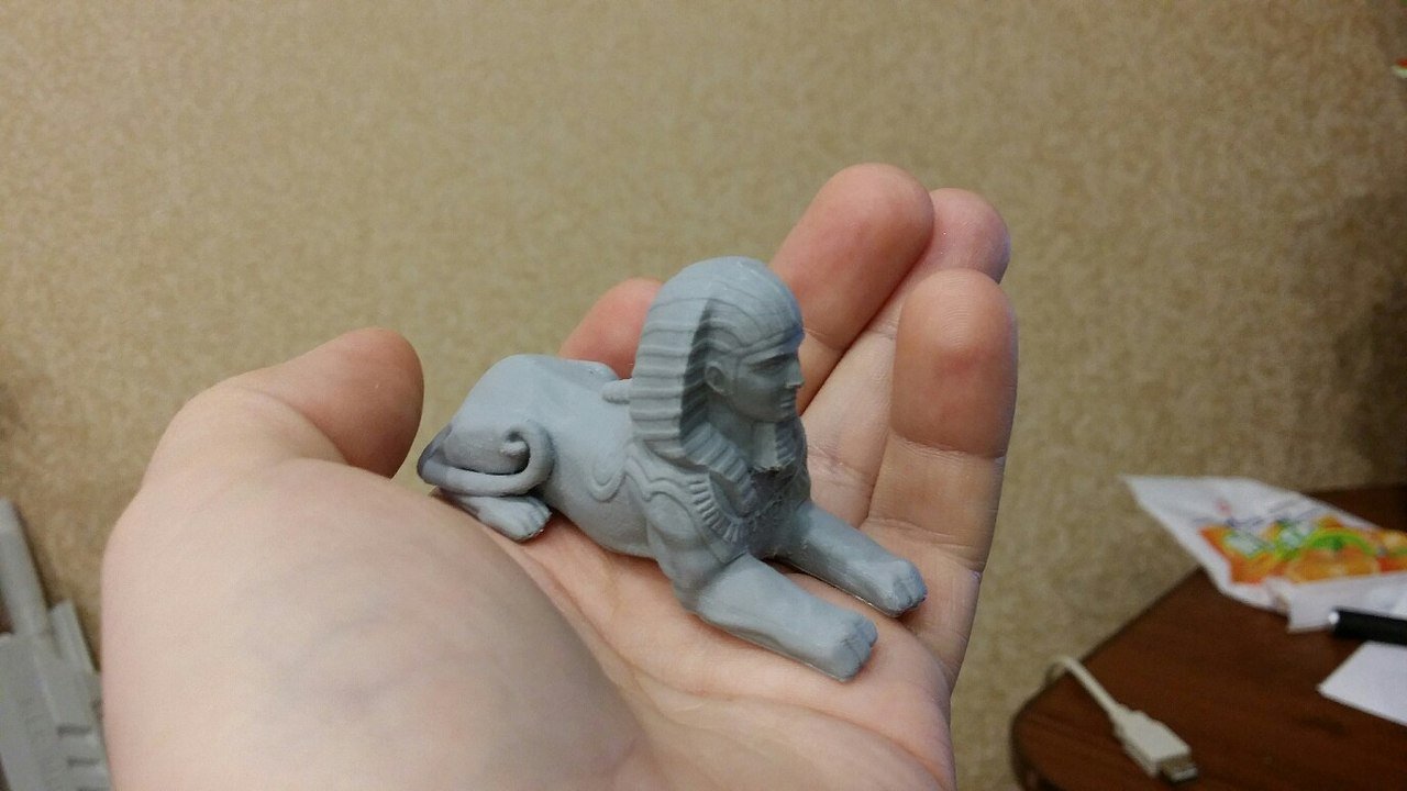

Wow. :-o I did not know it could do 20 microns. How the h— long did those prints take?
You must have had bad luck then. I’ve had no problems at all so far, they were really nice and support was great for me!
pla 20 micron print/ but you need very cool plastic like innifil3d and print speed 25 mm sec
some time very long :slight_smile:
