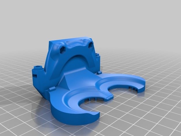

Cooling mod:
https://www.ebay.co.uk/itm/Active-Cooling-Fan-Kit-for-Replicator-Wanhao-FlashForge-CTC-Dual-Extruder/322381439384?hash=item4b0f6e6198:m:maHMk0j-O5L55EIS6RvYDSg .
