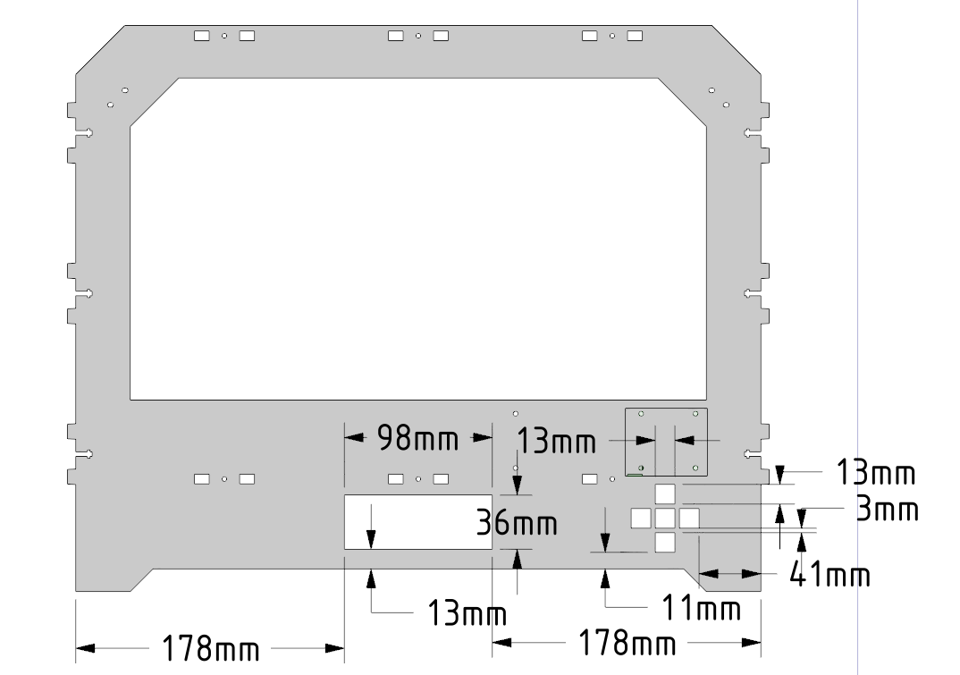

i need some assistance im in the progress of remaking the case of a CTC dual extrusion printer
it’s a clone of a makerbot.
i need drawing of the 4 side and bottom panels including the dimension on it
these may be made by hand or in any kind of format
any one that has a CTC dual could send them to me.
thanks

And i don’t have a CTC printer butt on pics i found on the internet i see its a clone of a makerbot.
to be a 100% sure need the demsoins on a drawing.

But the CTC uses 5mm wood on the front and back, and 4,5mm wood on left and right.
But i say on an pic found on google that the location of the lcd and buttons are different to the makerbot.
and don’t need to download the files i allready made them for my makerbot
need only the lcd and buttons location and sizes for the front plate of a CTC machine
Ok, I just measured it on my CTC.
Master FX thanks a lot for your Pic and time
no i can redesign the front panel for the CTC also

butt whats the square above the push buttons for?
