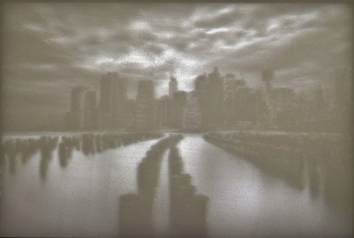

Sandra’s first prototype was printed using FDM technology, but as Jose explains, this process would never deliver the desired outcome: “Instead of creating a solid part with gradual and highly defined surfaces, FDM type printers create a topographical map of sorts. The filament builds up in very thick layers, and for the purposes of this print, we were looking for thin layers and a highly defined surface. In addition, we needed to angle the part in every dimension to prevent any unnecessary material build-up that would erode the different parts of the lithophane.
That’s why I advised Sandra to try an SLA technique. Contrary to FDM, SLA uses liquid resin instead of plastic filament. To solve the build-up issue, we pitched the lithophane on the x and y axises and tilted it on the z axis. All the resin was able to flow off gradually as the part grew.”

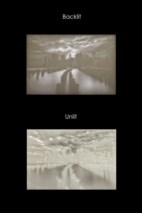

The printer was set to a .025mm high resolution, so the print time took 32 hours in total. After removing the supports, Jose applied a light coating of clear UV resistant spray to keep the part from curling and yellowing any more than necessary. The results were simply stunning and have driven Sandra and Jose to host their own art exhibit: “The Art of 3D Printing.”
The 3D printed lithophane both lit and unlit
